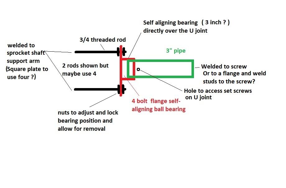

I mentioned this earlier.  I think both ends of the screw needs lateral support, not just the front. Both ends need to allow the shaft to change angles a bit.  The front allows this already but I think the rear should as well.  I posted a poor representation as this:
images?q=tbn:ANd9GcRkTZ5LXbN_HZYBb9NMLhjub72bxGmB-70RdTXVRbv8o6jqeevgTkh_2rQYROg&usqp=CAc
instead of a better choice like this:
24088CAME4 - NSK Spherical Roller Bearing - 440x650x212mm
Mounted in a brace to give side to side support.  I picture the drive sprocket in rigid support, then the U-joint, then this proposed bearing in another rigid support to the frame and THEN the screw with pillow at end.  I think thrust bearings are also needed.  Maybe even a splined shaft to allow for movement.

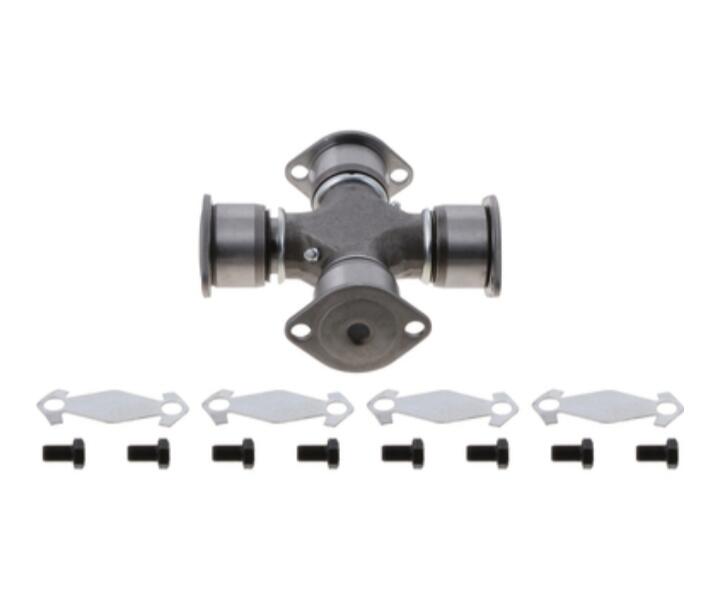

Agree on this. I guess with enough force, one should shear off and the bearing come out or, more likely, the forces could wear the groove that holds it and it could slip out. In the normal use case for a U-joint, there is little or no force on these clips unless the joint is misaligned. Your point is valid that switching to a joint with a "captive" yoke not dependent on spring clips would be the next level up. Once you take that away, you are back to side load on bearings--wonder it any of these use tapered?
