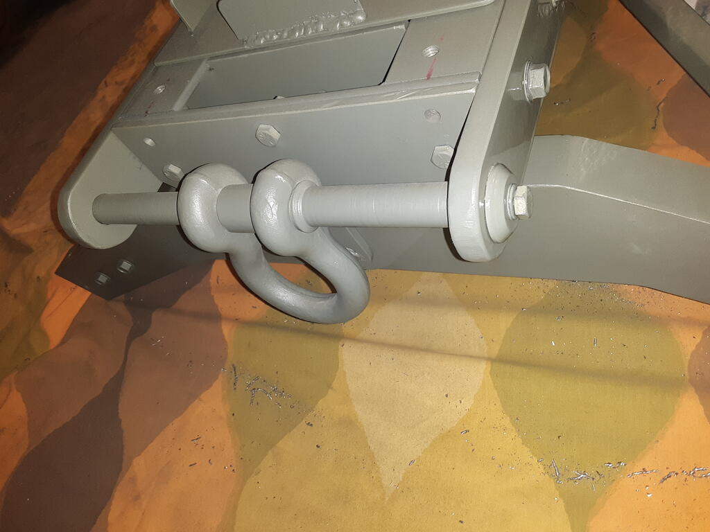

Again something simple, but sometimes that's all you need. The collar in the middle of the shackle is plug welded to the shaft to keep it centered.
  • Excellent 8

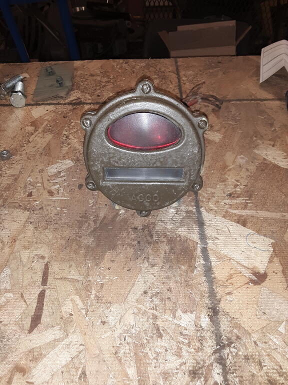

A little donation from the local military guy. Now I have a tail light and it's a matching style to the headlights.
  • Excellent 3

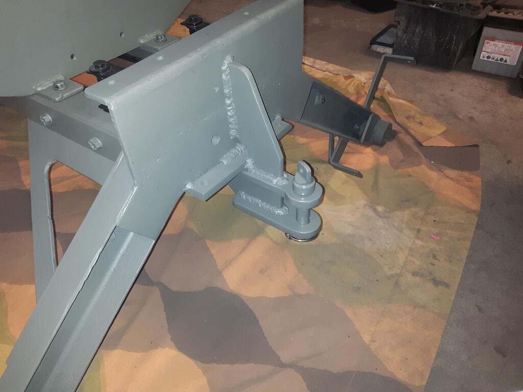

The rear hitch point is done. What a p.i.t.a. I had to partially assemble to see how much room I had then dissemble to the point of taking the rear strut section off. I think I can keep moving forward from here.
  • Excellent 7
Tractorhead
That Taillight looks perfectly fit.
Oldskool
Oh it's going to work great. Its surprising thou, that little bugger weighs all of 5lbs maybe a bit more. Wouldnt want to drop it on my toe.

Wait, wouldn't it be better to have pull points on the sides? So when you pull, the rollers will act as wheels?
If you pull from the front or back, won't the screws be fighting you the whole time?
Just a thought.
