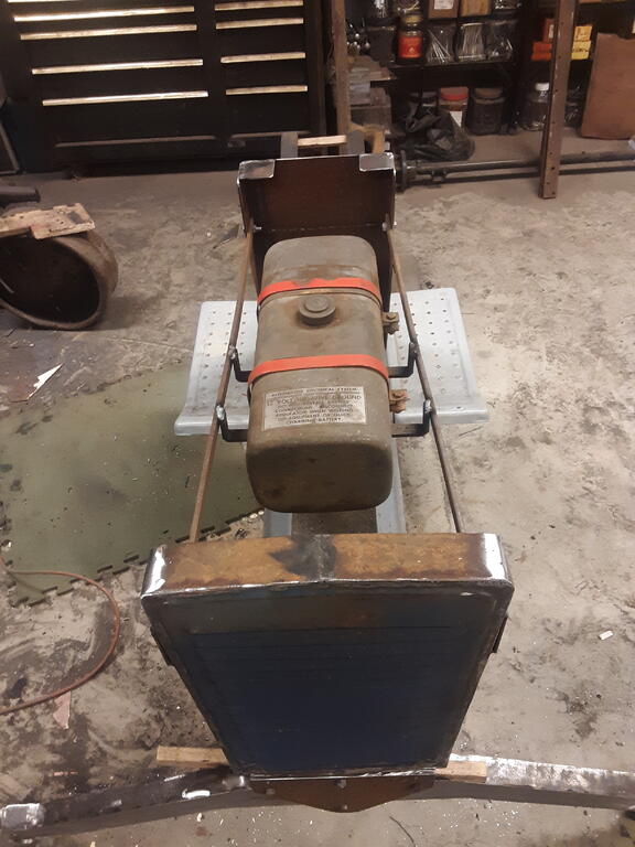

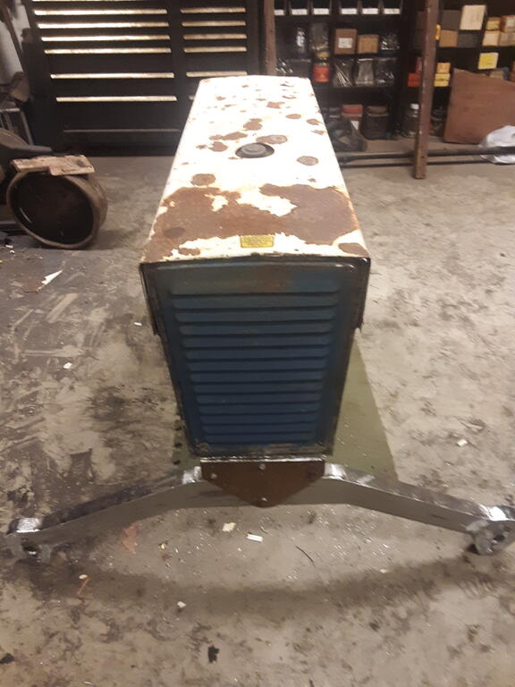

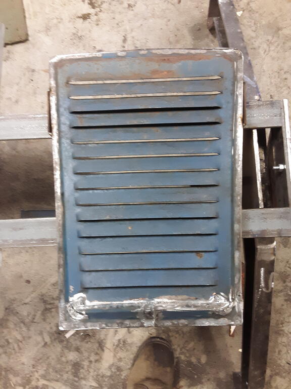

Oldskool
A bit of grille work done and now mounted
Oldskool
Next is hinging the hood and mount the running boards

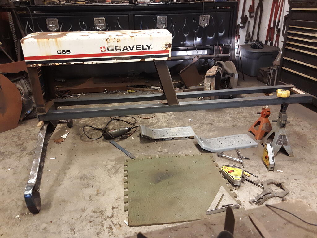

Oldskool
A little bit more done on the Y.E.T.I. Slow but surely.
So, where’s the final drive coming into play?
Food for thought... in this video @Achto’s McLean has a sweet “differential” by slipping the inside tire’s pulley (Two drive belts)

I do believe that a hydro drive from a Zero turn is going to turning the tubes
I s’pose that’s a bit easier!

As @Achto said I will be using a dual hydro drive to run the tubes. Its easier. It's what I have on hand. It will be chain drive from the main drive units to the tubes.
