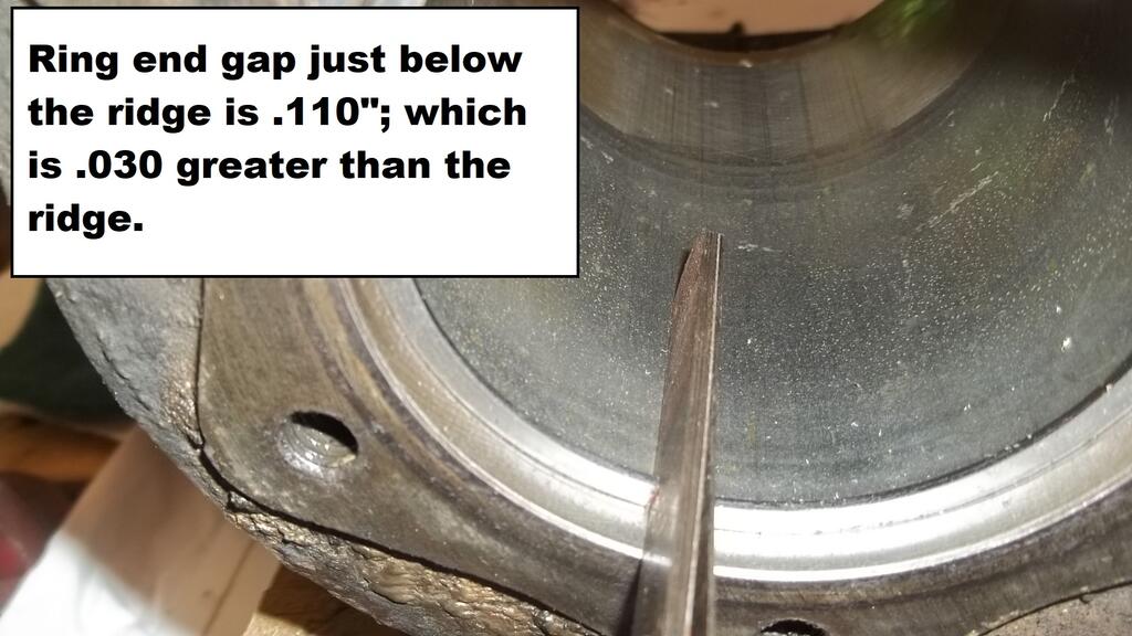

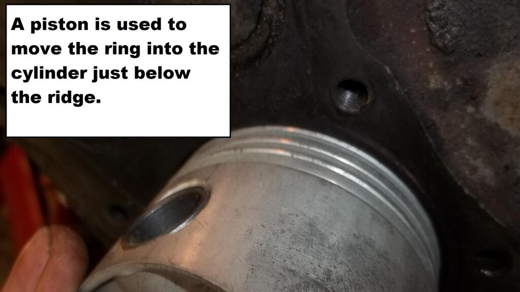

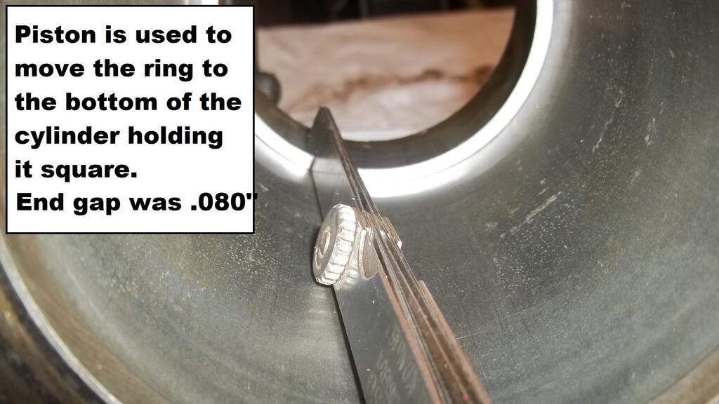

On 5/30/2020 at 8:28 PM, 953 nut said:
Seem like this question is asked nearly every week on here. The answers given quite often include buying expensive Bore Gauges or Inside Micrometers. I have an inexpensive down and dirty method of evaluating the cylinder's wear that uses a tool nearly everyone has or could buy for around $ 5.00. A set of feeler gauges and a ring from the piston you just removed will let you know without any other equipment. It won't tell you how much it should be bored (though you can get close) but it will tell you if it is beyond the point of being successfully honed.
In the photo below you can see the first step, placing a ring at the very top of the cylinder above the ridge. The piston ring end gap in this case is 0.080. The cylinder at the ridge measured standard at 3.25" and the cylinder walls and ring edges were worn smooth.
Next I used the piston to move the ring down to a point just below the ridge. The piston helps keep the ring square to the cylinder wall.
At this point the piston ring end gap increased to 0.110"
This step was repeated three more times at 3/4 inch intervals. The results were 0.117", 0.118" and 0.117"
Next the ring was moved to the bottom of the cylinder where the piton rings would not have contacted the cylinder walls. The piston ring end gap returned to 0.080".
The greatest deviation of the ring end gap was 0.038". Now we can do a little fuzzy math to figure out how much the cylinder need to be bored. Changes in the ring end gap will be a change to the circumference. Bore changes would be a change in diameter.
image.jpeg.9837746c7b384fbac618a2916a3ebfe7.jpeg    So, 0.038" divided by 3.14159 will show that the greatest wear in the cylinder is 0.012" larger in diameter than standard and should be bored 0.020".
