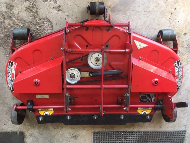

gwest_ca
The problem of getting the correct parts is likely due to the fact they share a parts list with a similar deck. Most times the 42" and 48" are shared but the online information does not distinguish between the two or identify what fits what. If you follow the item numbers in the list down near the bottom they are repeated with different part numbers. Blades are one item that is different so if you know the correct blade numbers the parts with them are for that size of deck.
If you can find an original parts list the parts are correctly identified.
Click on the picture. Just a guess on the model and vintage.
