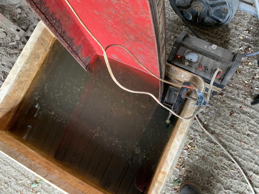

British weather meant no painting, so more cleaning.

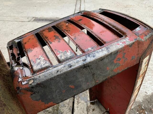

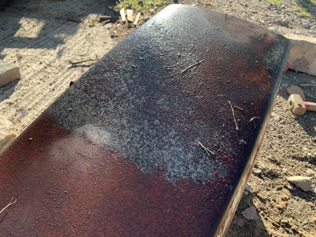

hood is in the e-tank.
after the wind meant I had zero chance of welding rust.

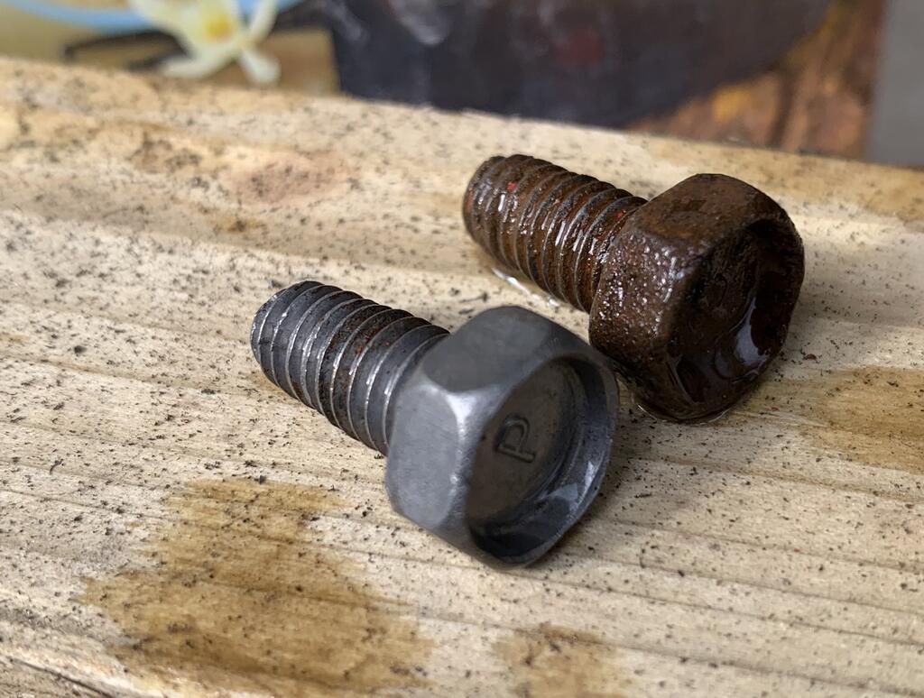

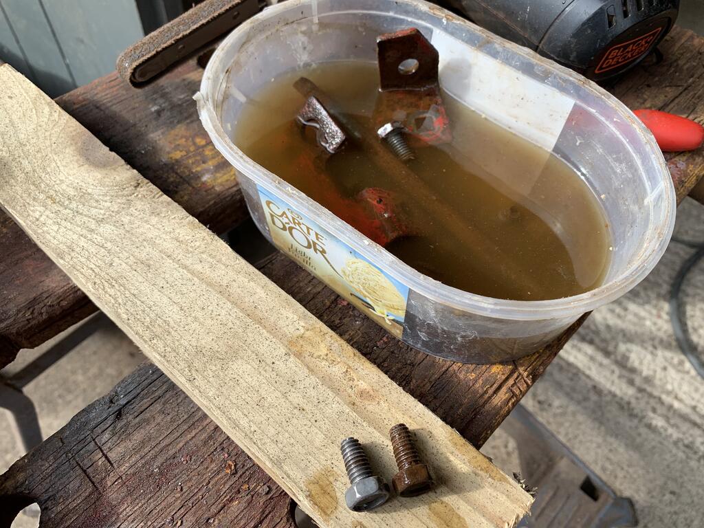

got my acid tub going too to clean up all the fasteners.
working a treat!
What is the acid/details of what you do?
meadowfield
Citric acid, works like the e tank, but no power needed and better on small items.
Edited by meadowfield
5 minutes ago, meadowfield said:
Citric acid, works like the e tank, but no peer needed and better on small items.
Oh?
What's the concentration?
Soak time?
Is it reusable multiple times?
I've got about 14 zillion fasteners I'd love to clean up.
meadowfield
1 minute ago, ebinmaine said:
Oh?
Soak time?
just buy some, mix it and try. It loves iron oxide, but doesn’t touch iron/steel. So you can leave it in all week!
A few hours works on clean bolts. The really rusty ones - I’ll let you know!

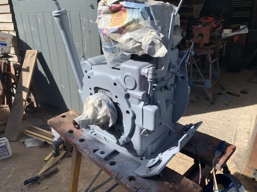

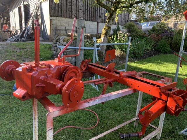

Well we had good weather her today after two days of rain. The last seal for the brake drum turned up so the drum could go back on too.

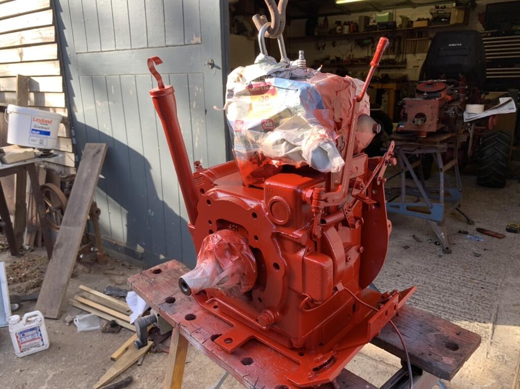

so the transmission and chassis have had the first 3 coats. Will go over again tomorrow hopefully.

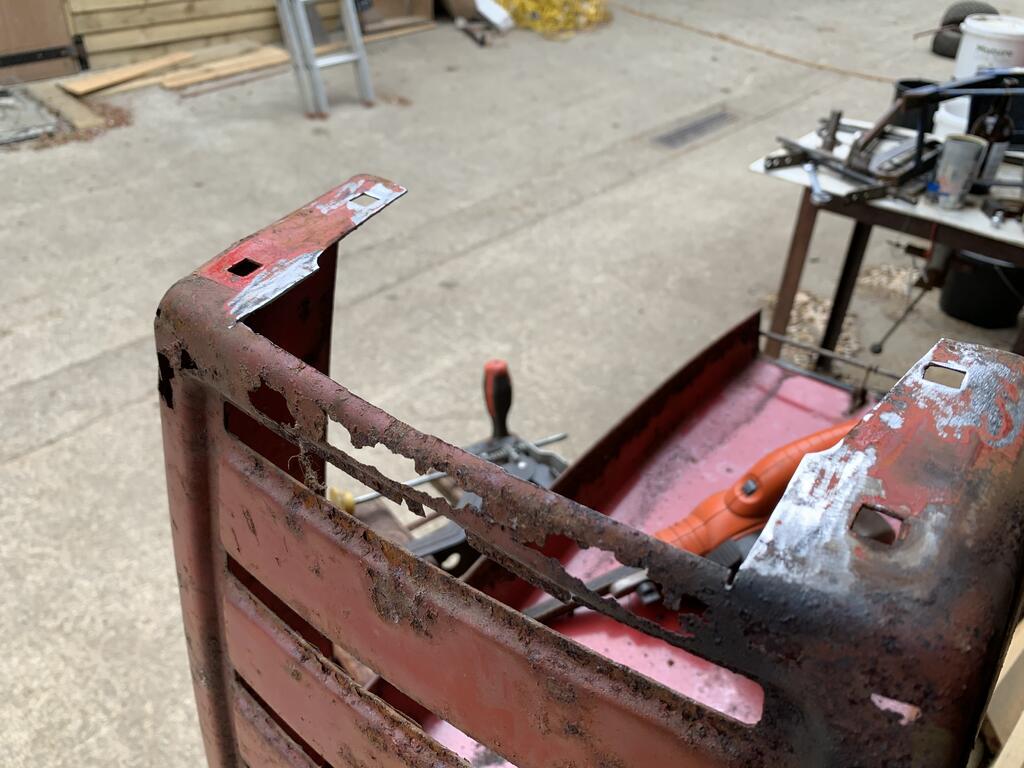

The very rusty hood has been cooking in the e- tank and is coming along nicely.
the paint and rust is still falling off, hopefully it will get welded and painted this weekend...

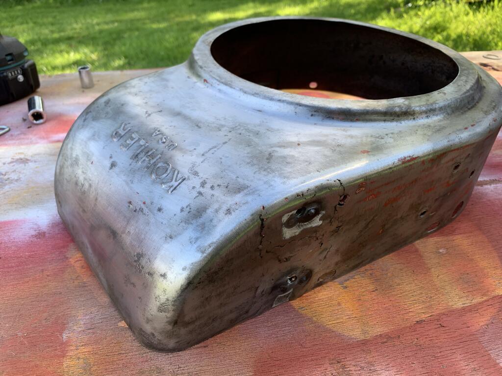

a few more goodies arrived - my replacement engine cowl and new set screws for the axles.
meadowfield

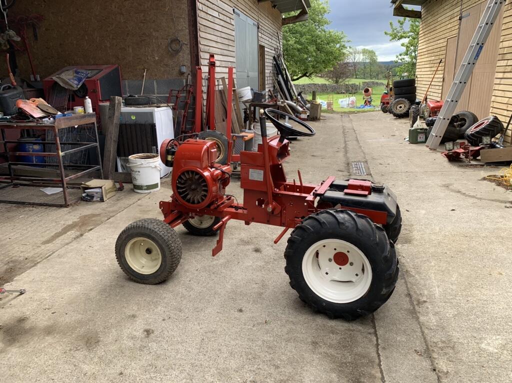

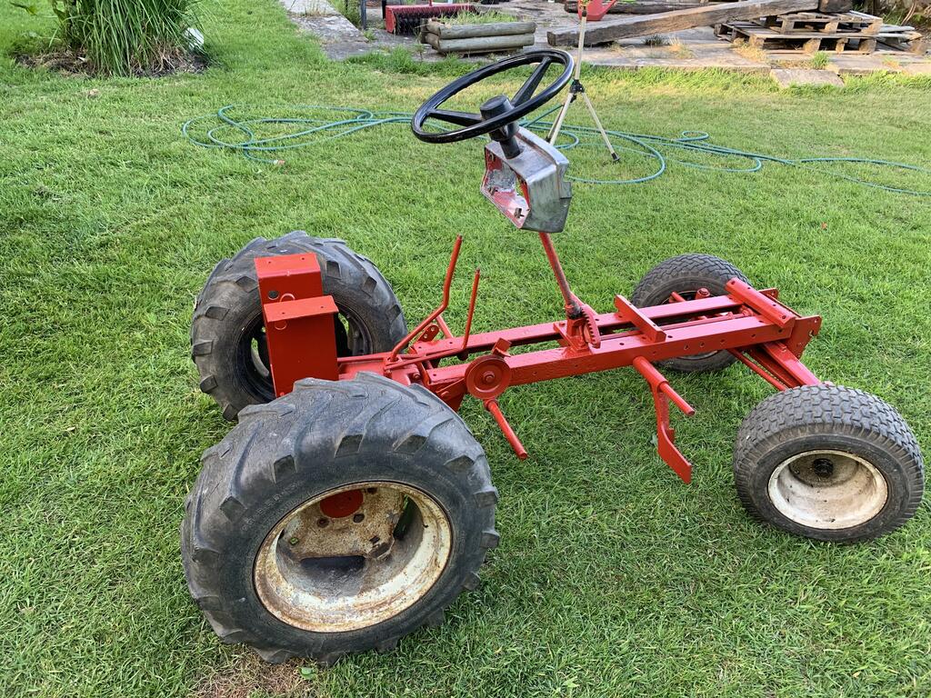

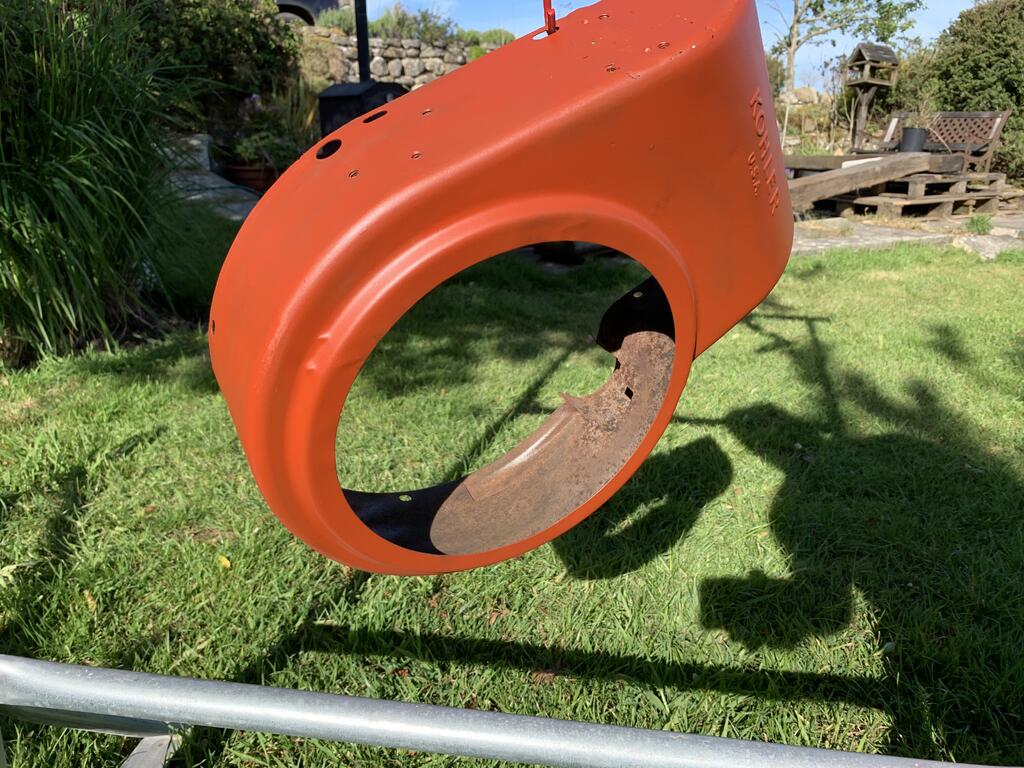

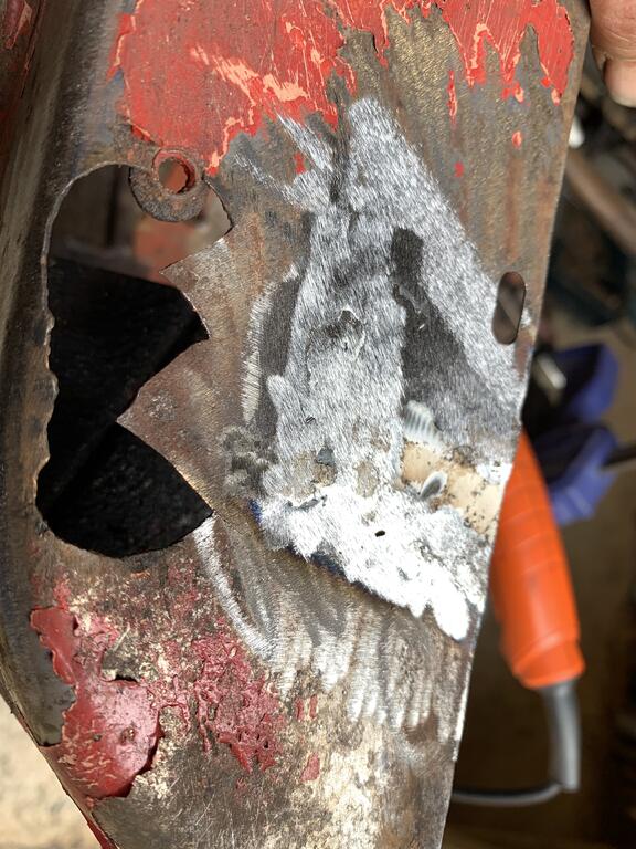

Didn’t make as much progress this weekend due to working on bendy. But now she rolls... my donated engine cowl has been patched (not the best of welding due to wind)
F5297140-2563-48A4-96AE-87A26DA813E6.jpeg.2c9d51d97f48450b36e25cbe46899bef.jpeg038E7441-5F98-47F0-8B3C-529EED767CED.jpeg.a2385a7b80ed293b8288fd5fb7a0eaf6.jpeg235E3BBD-831B-4085-850C-3145B3CDC40A.jpeg.b2a7cd3f9594daa6894065a8b71ee197.jpeg

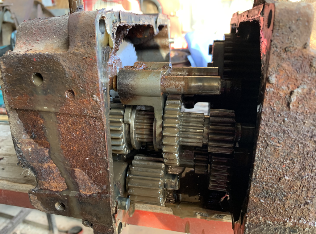

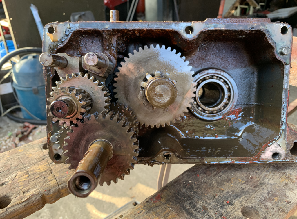

On 5/14/2020 at 5:28 AM, meadowfield said:
I've seen worse though, just needs a good clean. Axle seals arrived today, waiting for brake and input seals. Bearings all good though!
How did you clean up the surface rust on the inside of the case? Did you use a wire brush while cleaning with the gas? Or did you just leave it alone?
Thanks
71_Bronco
Double tap
Edited by 71_Bronco
71_Bronco
Triple tap
Edited by 71_Bronco
meadowfield
8 hours ago, 71_Bronco said:
Triple tap
wire brush whilst cleaning

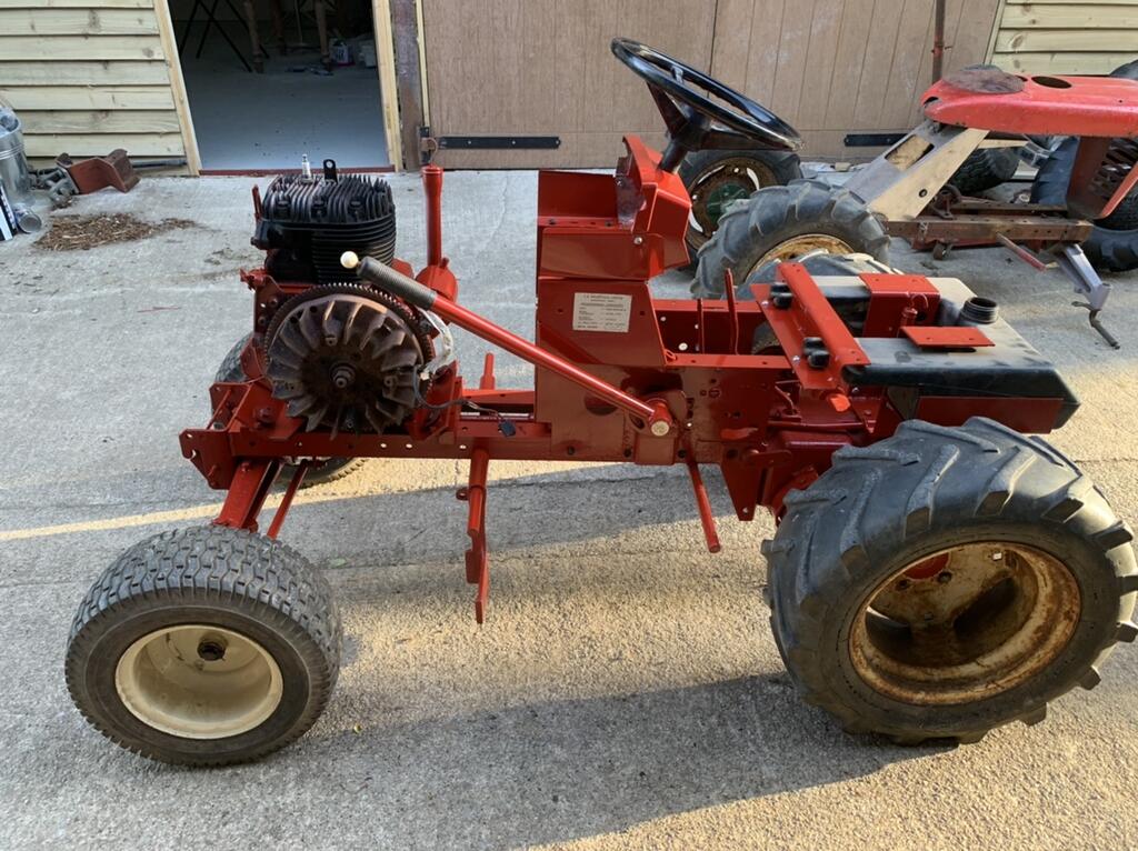

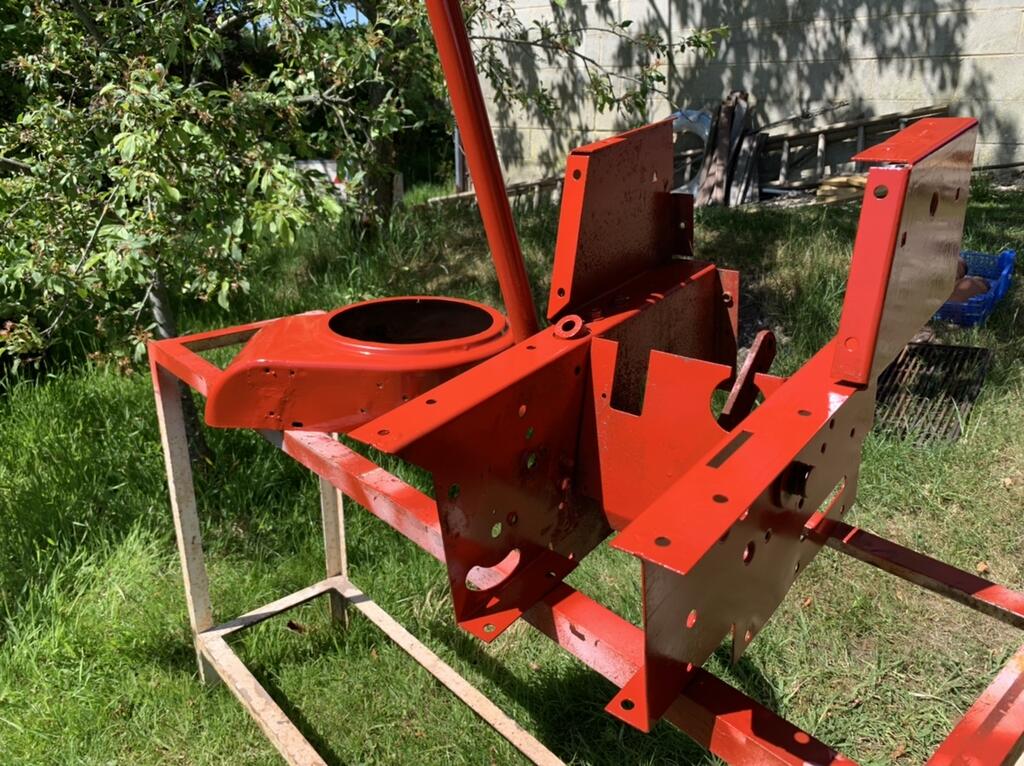

Latest...
new rubber!
hoodstand painted
engine cleaned and painted
rolling....

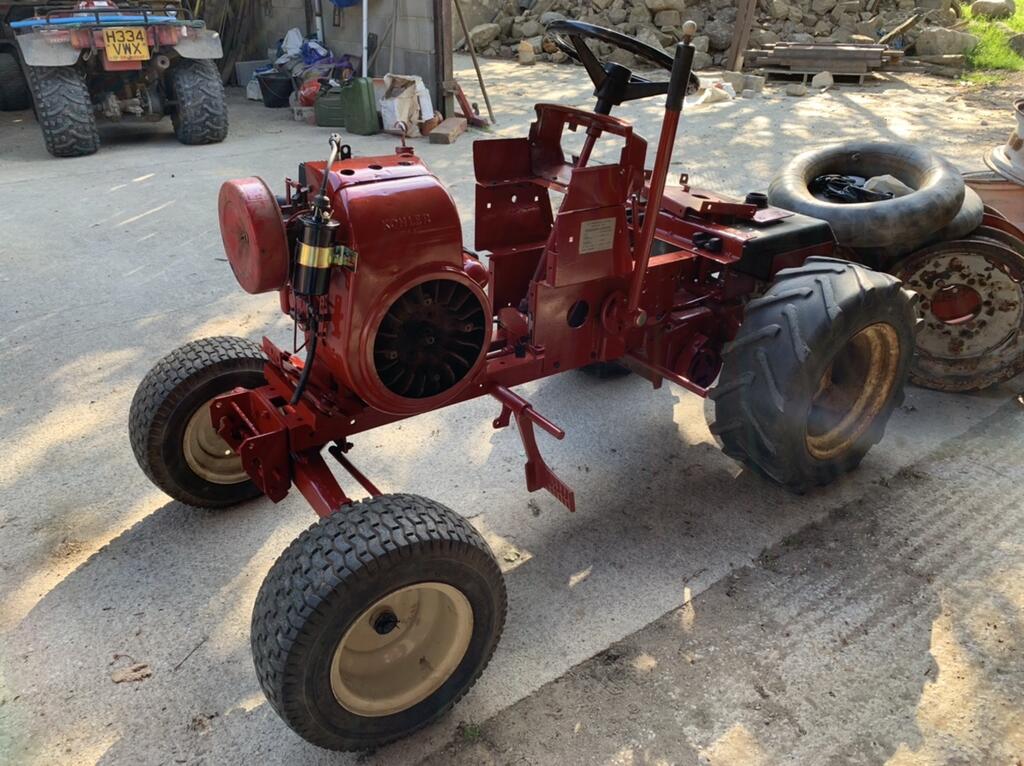

Got a question. Why have you got the tyres mounted that way round? Are you going to remove them to paint the wheels?
rjg854
Looks like he has a new set of tires already:auto-layrubber:
meadowfield
1 hour ago, Stormin said:
Looking good Mark.  :handgestures-thumbup:
they are just two wheels I had. For some reason both mounted the same way round, so one always faces the wrong way :(

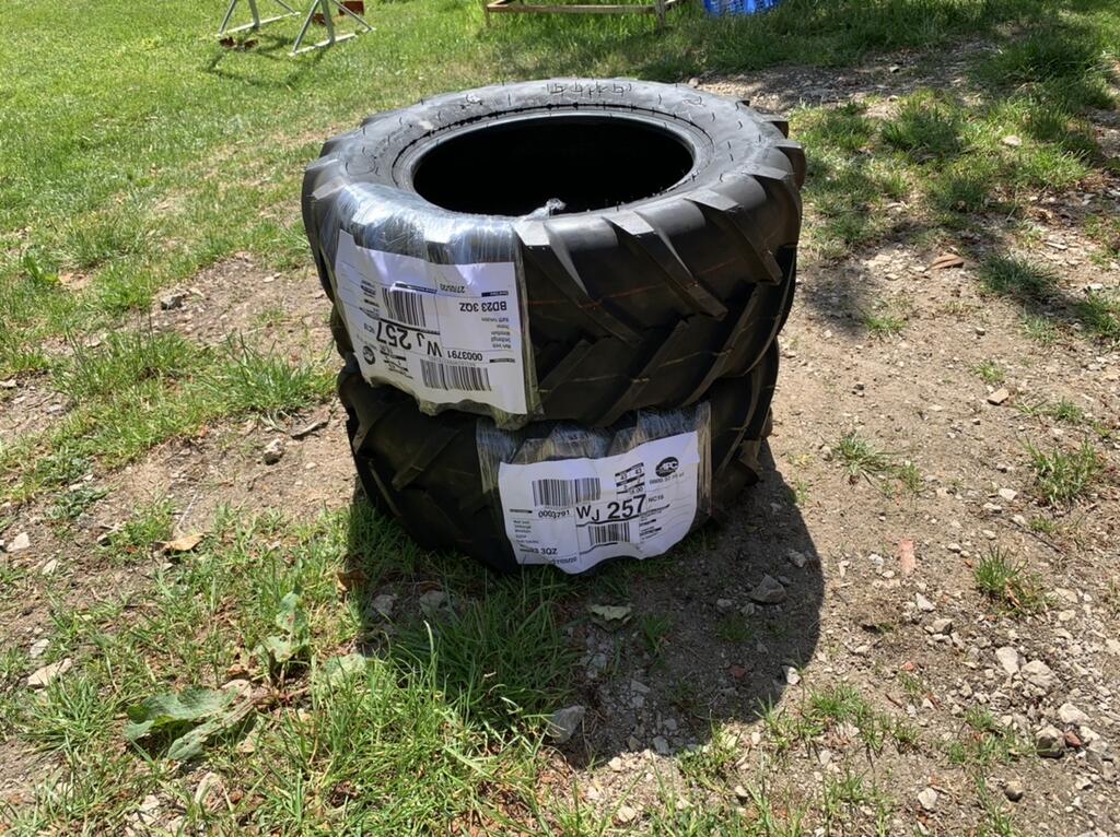

new tyres going on anyway!
Stormin
:text-blondmoment:  Should have noticed. Not the new tyres.
  • Haha 2
Stormin
Hadn't noticed that either. :rolleyes: There's a reason for that, so I've heard. Think it's about getting better grip on steep inclines/descents I think.
Edited by Stormin
Easier to back out of a sticky situation?

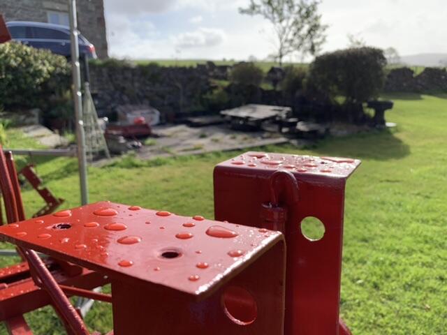

meadowfield

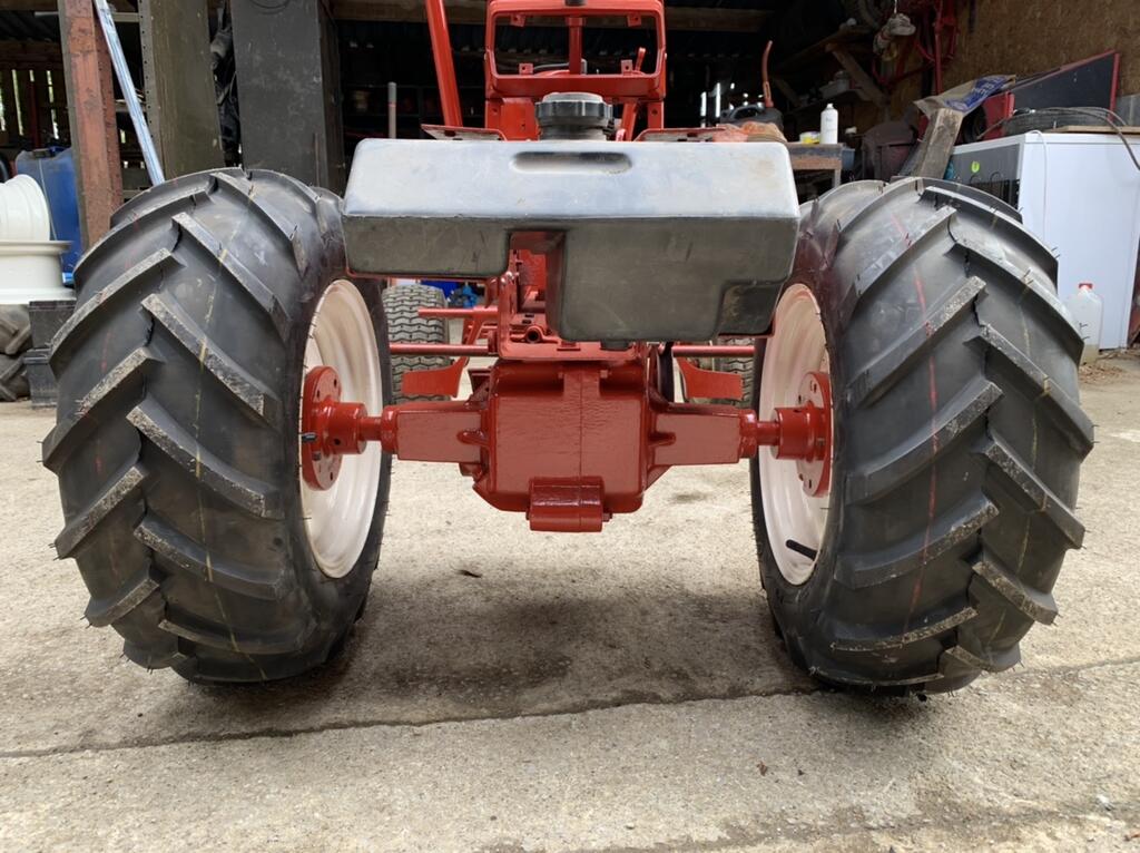

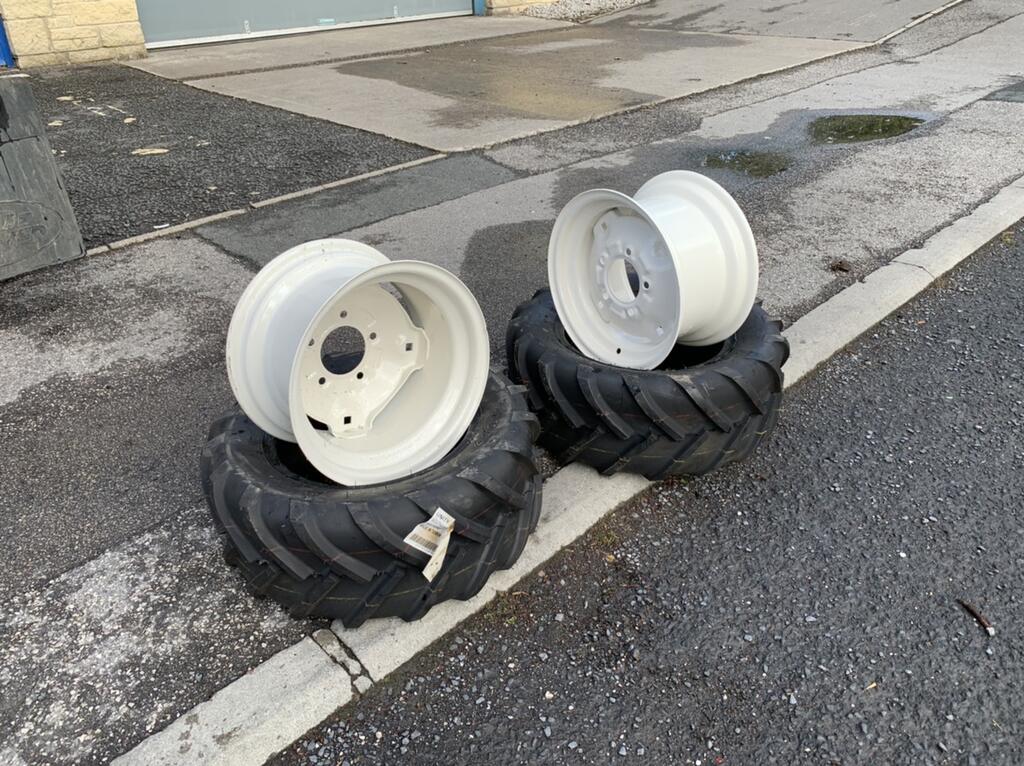

New boots!
30C66E20-FD97-4E27-B51A-4BC9DD0D4341.jpeg.31893b54bb66594b55e2cdb269a10c76.jpeg438C318A-1CDB-4B8A-B58E-731422CA9167.jpeg.9caadc0b9d7f00439ef2b2aa71ad000e.jpeg82195AA3-B637-41A1-9CE9-961C2BB9896D.jpeg.fa2c48ec4d4f28affb2b0e1d8addc498.jpeg
