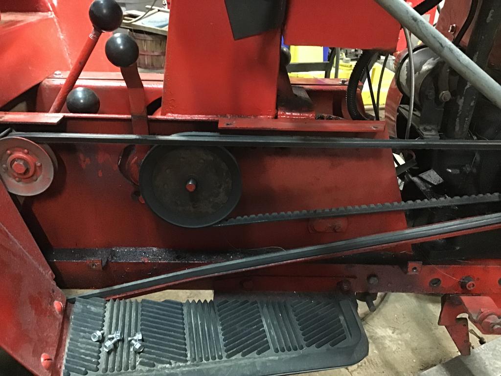

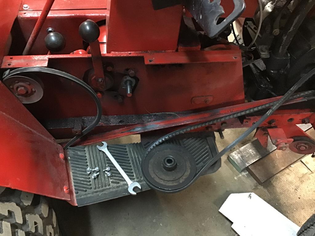

Could it be this easy?  The set screw was backed out and the pulley slid right off.  I’m going to put things back together and give it a whirl!  Maybe the pulley was slipping on the shaft!
Tractorhead
Cool if it could be solved that simple.
That’s all it was!  I’m finishing the welding of the rear hitch, then maybe I’ll even smooth it a bit and throw some paint at it!

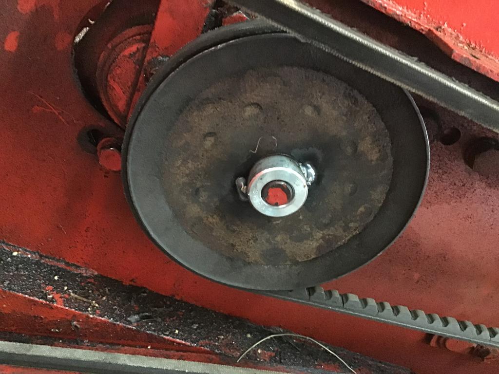

Overkill, I’m sure, but I found this collar at the hardware store and decided I’d add it to the outside of the pulley, to double the clamping power.

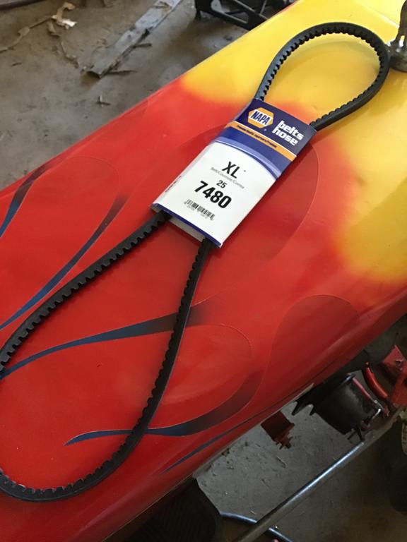

I think the second collar is a great idea. :handgestures-thumbupright: Might wanna grab a new belt for the hydro there Kevin. The cracks look pretty deep in that one.

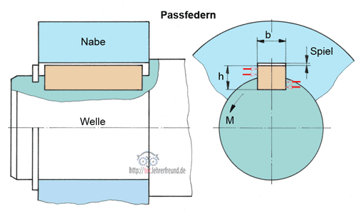

i ain’t doubt the pump can handle it, i have more clues to the Clamping itself.
Is it just fixed by the pressure of the Screws to the shaft, isn‘t it?
if so, i would mark the contactpoint on the shaft and grind the contact point’s of the shaft on one side a bit,
to have a small flat where the Screws are have a deeper point.
So the screws must be strongly worn out, that they can frict.
Similar to that pict‘s
if the clamp was that kind of
i would grind in contact surface like this
not as a groove spring but similar to.

I'd like to add to that a little bit. General knowledge type stuff. All the set screws I install on a new surface I tighten them and back them out and tighten them and back them out four five six times before I leave it tight.
I'm really not sure where I got that trick from but what happens is that the set screw cup surface digs into the shaft surface a little bit more every time you tighten it. If you look at the clock position of the wrench as you tighten and loosen you'll see that it goes a little further each time you do that.
A word of caution when doing this. Be sure NOT to mushroom too much below the set screw or you'll have difficulty removing the item that is being set.
  • Thanks 2
Yeah EB, great idea!  Stefan, there is a flat on the shaft for the set screw to hold steady... but I now intend to loosen and tighten this new one a few times over!
Stormin
  OK! I've read what's been said about the set screw. (We call them grub screws.)
  Another way of doing, so you don't mark the shaft as Eric says, is to dimple the shaft enough for the set screw end to enter the dimple.
 Two ways of doing it.
(1) Spot through the screw hole in the pulley, then remove and drill deeper.
(2) Fit pulley and tighten screw enough to mark the shaft, then remove and drill dimple.

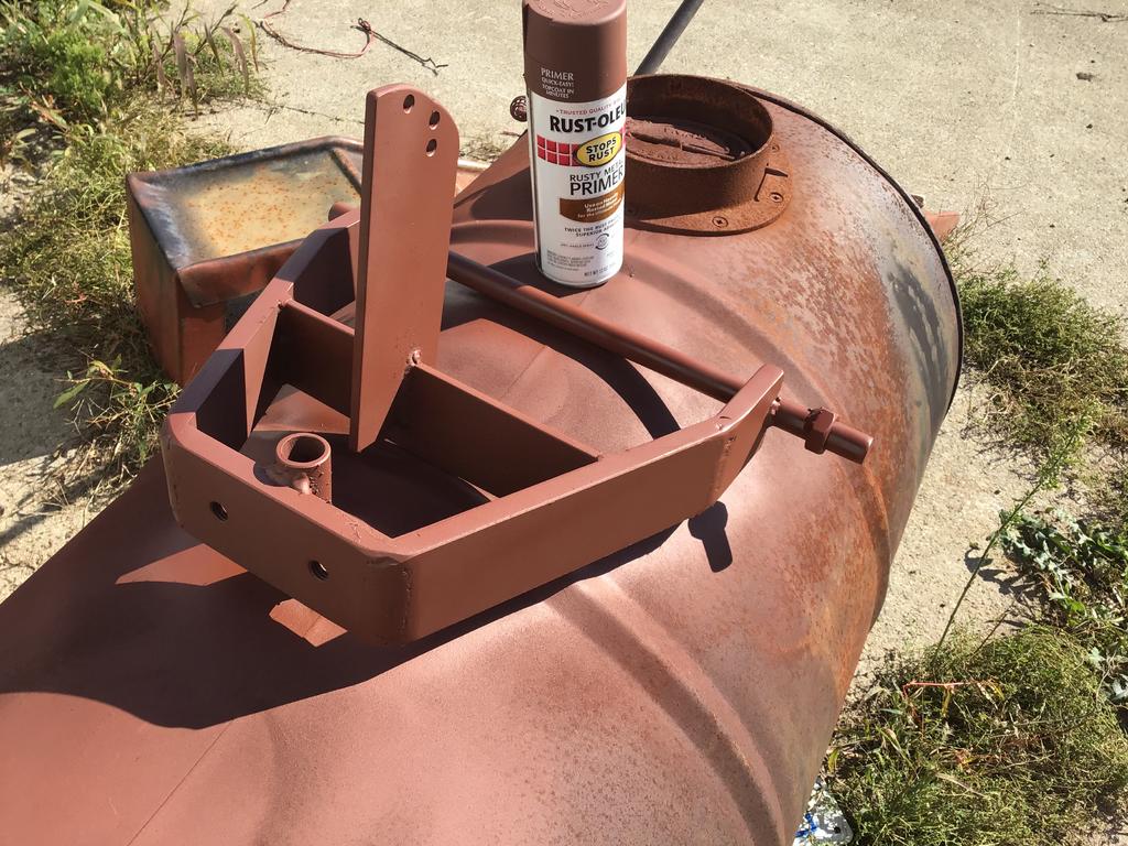

The hitch is smoothed and even primed!
