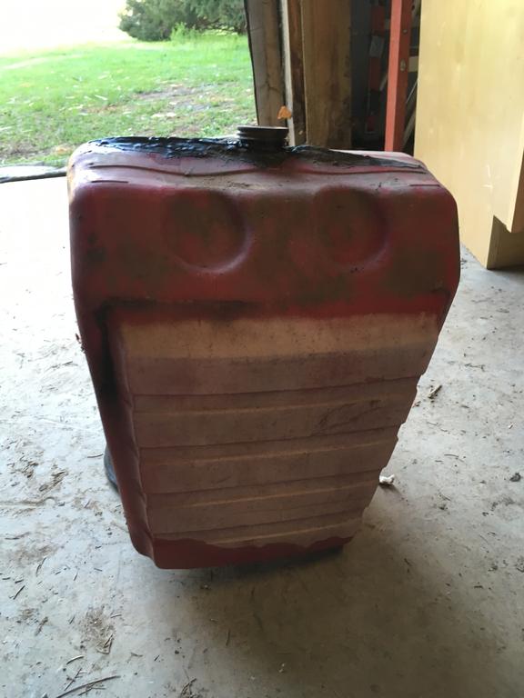

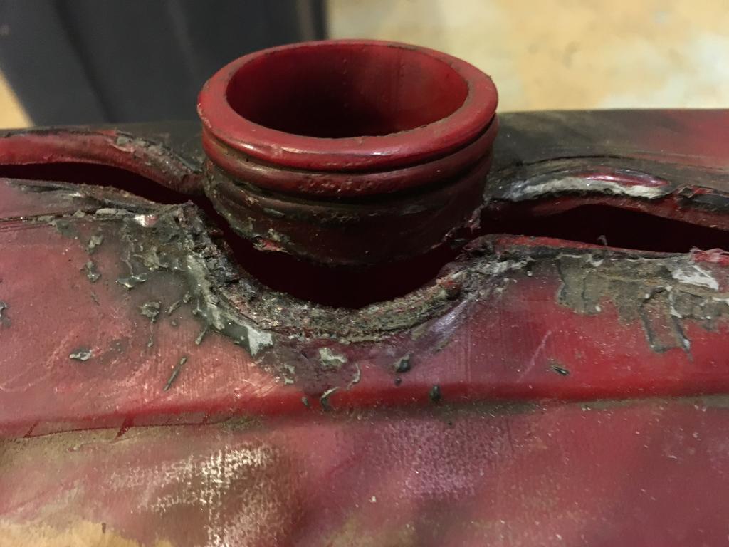

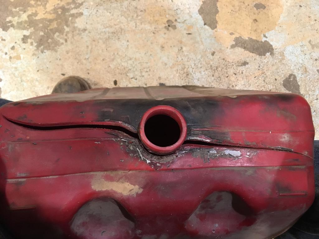

I pulled the gas tank and cleaned it up, I am going to try to do repairs on it soon. I didn’t realize how bad it was cracked till I pulled it out. Here are a few pictures of it after I cleaned it up a bit. I am going to clean it up a bit more and see if I can repair it.

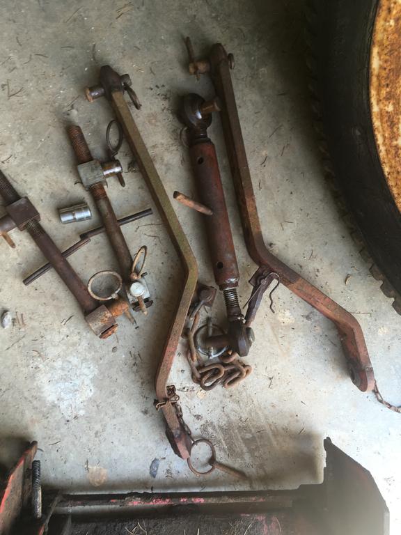

I also pulled the 3pt off to clean it up and replace some hardware.

Good to see your progress Robbie!  That tank is pretty rough.  I’m not saying it can’t be fixed, but it won’t be quick!  Once it’s sealed up, I’d suggest epoxying some fiberglass material onto it to help hold it together.  As for the hydraulic cylinder, try putting weight on the 3 point and see if it drops at all.  Slow movement wouldn’t really be the cylinder’s fault unless the seal is leaking internally.

I am gonna try and heat the plastic a little bit and bend it back to shape, then I am going to try to jb weld the crack.

Look up plastic welding on here.  Several folks have had good luck using zip ties as their filler material and blending it with the original plastic to create a permanent repair.  I’m with @pullstart on using some good epoxy and fiberglass cloth.  I’ve done it myself on plastic and it creates an extra level of insurance after you repair the plastic.

Another option if it doesn't work to fix it and you want to use a different tank like @19richie66 would be to cut out the front portion of the tank and mount it to the nose, then put a different tank in behind it. That way it would still look original from the outside.  Just a thought.

Changed the hydro fluid and filter on the GT last weekend. Rebuilt the carb and put it back on yesterday. Now i am just waiting for the gas tank to be finished. I took it to an Amish guy that does plastic welding, i am just hoping its done in time for the big show.
