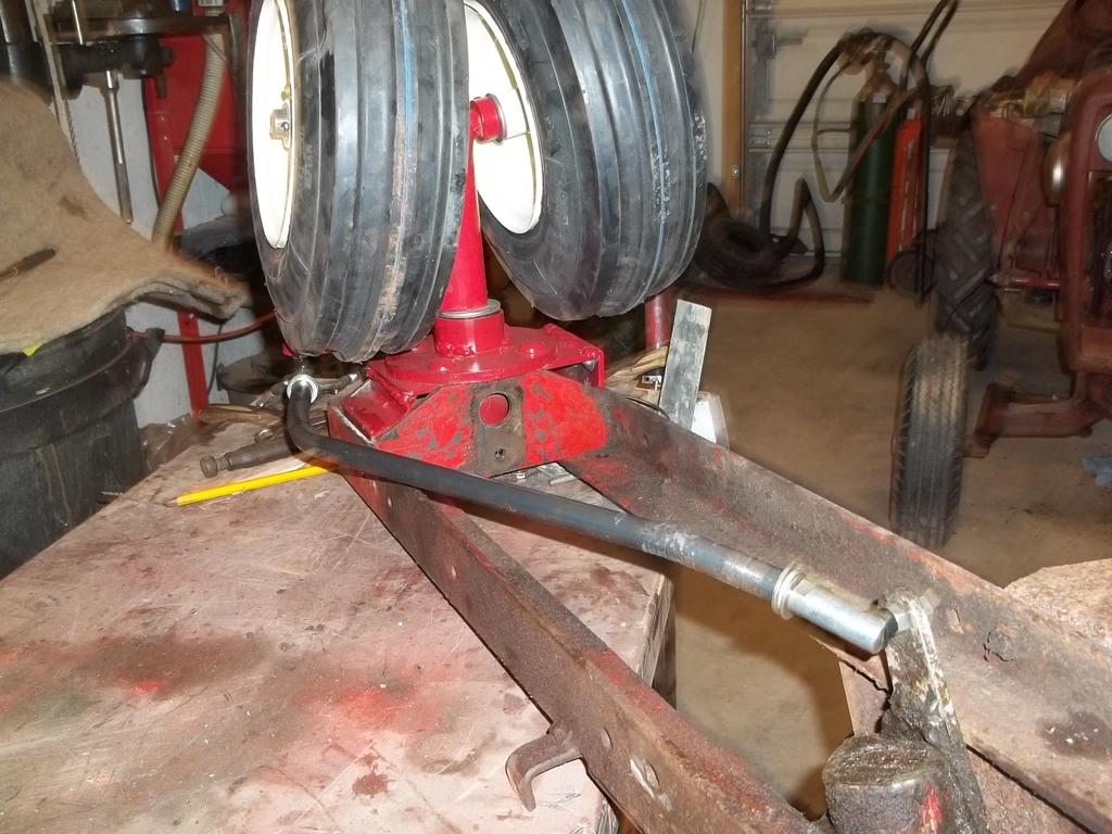

Is there a picture of the steering bar on the steering wheel?
The "Ross Steering" and the "Fan Gear" steering arms on the 953/1054 both swing from front to rear rather than side to side as on other Wheel Horse models. 102_2850.JPG.d9a3d65ff26ced2cf8c6ed7a7851c4d8.JPG
If you were to fabricate a "Bell Crank" linkage you could convert the right/left steering on other models to a front/rear.
carlosking450
how is that piece?
4 hours ago, carlosking450 said:
how is that piece?
You are looking at a 053 frame turned upside-down with a Ross steering box.
5664e7f52e2f3_RossSteeringBox.jpg.580653

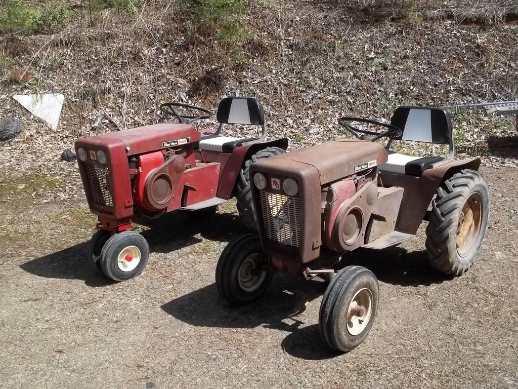

      This is going to be a slow project probably but I figured I'd start a build thread. I bought a pulling horse and it came with this c-81 for extra parts. Also a kid's puller for my little girl.
           Homely looking thing missing front tires, and engine. Steering was rusted seized along with pedals and linkages. Extra hood(I don't know what it fits) and back fenders came from the grass next to where it had began to rot into guys yard. Who knows what else its missing but rear end oil is clean and it rolls.
         This is the wife's tractor. She originally wanted any tractor I could modify and turn into a mini Ford 8N. She has since fell in love with the horse and wants it built as is.
