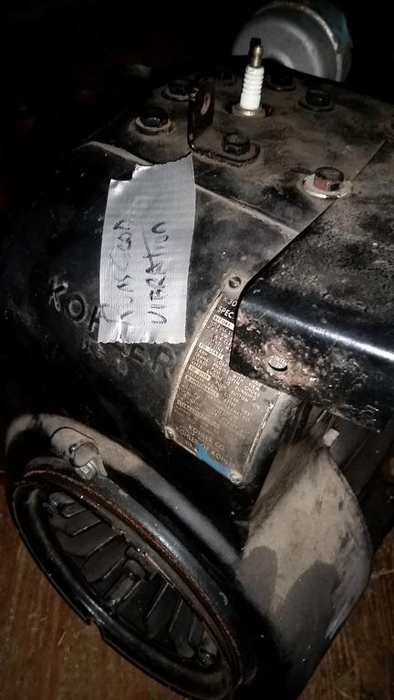

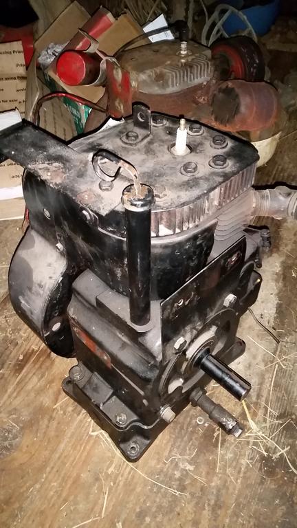

This looks like the best one out of the six engines I just got. The seller told me that it vibrates. He was told when he got it that it was rebuilt. It probably doesn't smoke because he would have said that. It has a one inch shaft and looks like it has a pull start but there is no rope. Anyone know anything about it? What does it need for the pull start to be complete?
Looks like it could be a 12 horse that was a S/G motor, not pull start.
Red?? paint under the bracket mount on the dipstick side. Could be orange paint.
Quick Google search shows mid 60s Jacobsen usage.
Someone should be able to search that serial number for you.
That one is a good score.
tntatro
With the pulley looking thing on the flywheel and the starting instructions say to give a firm steady pull, that made me think it was a pull start.
I can definitely see where that would lead you to believe that.
That thin pulley on the front of the engine looks like the one on the front of my 1267.
Pretty comparable engine overall.
I'm no expert by any means but I Wonder if those directions are generic for all Kohler of that series.
Then from there each manufacturer would change whatever they needed to. Possibly that pulley.

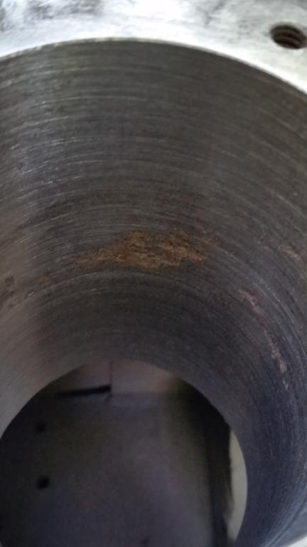

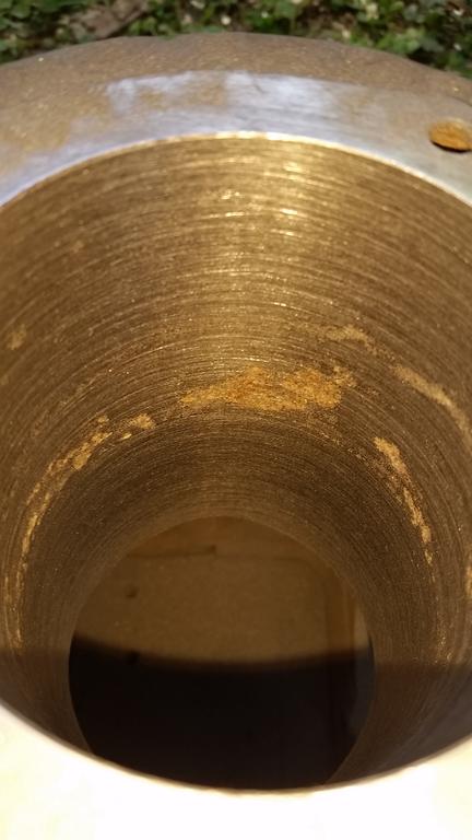

I finally got set up to bore some cylinders. The first one I did was the welded k181. I was pretty surprised at how fast and accurate the hone worked. I expected it would take much longer. I brought that one from a way out of spec standard bore to .030 over. According to my cheap micrometer and bore gauge I got it pretty close. That was a practice block that I won't be rebuilding.
The second one I did was the k181 I got for free that was completely locked up. In the pictures you can see that there is still bad pitting. I have it bored about .004 away from .030 over. I'm going to take it to .0025 under and see how it looks and judge from there whether to rebuild it. The piston was near the bottom of the stroke so I don't think the pitting would affect the compression but I would like to see a bit less pitting to rebuild it. I may just throw as little money as possible to get it running decent and beat on it.
The next one will be the k181 that was on my Wheel horse. It is a standard bore and has reached the maximum wear limit and also the maximum out of round limit. It needs a new piston and rod anyway so I'll try to take it to .010 over. The crankshaft reached its maximum out of round but the crank off the locked up engine is a little worn but hasn't reached the maximum wear limits.

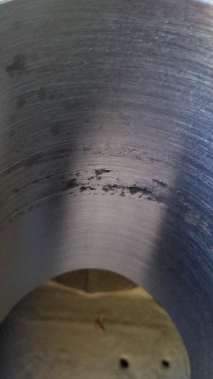

It didn't clean up very good. I think I'll put this one away until I'm done with the others. I didn't get as accurate on this one. The top of the bore is still .001 away from spec while the bottom is pretty close to spec. I think it would work better if I could flip the block and hone from the bottom also. I may build a frame to mount the blocks to so I can try it that way. The next one will be the k181 that I plan to use. I think I can get it good enough. I'll wait until I have the piston to bore it.

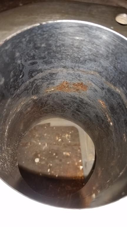

Just giving an update on my first rebuild. I bought a rusty old B-80 for $100 that had been run with no oil and the rod broke. I put the K241 on it and it seems to run pretty good. No smoking or knocking and starts easily, idles nicely and everything. The only thing about it is that it has (I think) overheated two more times, not when I was using it. After the first time I rebuilt the carburetor and put a bronze bushing on the throttle shaft thinking that excess play was causing it to run lean. The second time was recently. I don't know what happened, I was just told it was sputtering and then stalled, then started later and parked it. It starts right up and runs fine for me but I don't use it a lot. He also caught the deck height lever on something and bent it out of place, maybe the belt had more tension and worked the motor too hard. It has about 32 hours on the meter now. Maybe I'll adjust the carb settings a little and re-check the points. I'm wondering if I should pull the head and check it out.

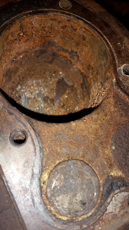

I've rebuilt two k181's. One was the rusty pitted bore. That was not a good idea. It smokes worse than my engines that need rebuilt. It has less than an hour on it but I'm going to have to get a .020 block and bore it to .030 and swap the parts. The other runs good but lets out a puff or two of smoke when cold. I left it standard bore and put in a used piston and rod.

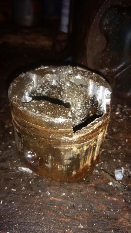

      Here's a deal that I couldn't pass up. It was a craigslist buy from a guy getting rid of this k241 with a cracked piston for $40. It also came with the PTO pulley, ignition coil, two carburetors with air filter housings (one looks like a new aftermarket) and the engine appears to be complete except the muffler. There are small miscellaneous parts missing but it's well worth the price.
      He said it needs to be bored but I don't know if he meant cross hatched or bored out. Can anyone tell me how to figure out what it needs other than a piston? I've never rebuilt a Kohler engine before. It will be a while before I actually get to it but any tips or how to get started would be appreciated. He said it turned over but he couldn't figure out why it wouldn't start until he pulled the cylinder head. He replaced the engine and wasn't going to spend time on this one. The bore has light surface rust but no deep scoring. I got the impression that he knew it has value for parts but thinks it is not worth fixing. I'm not at all experienced with these engines but I'm thinking it can be revived and well worth the effort.
