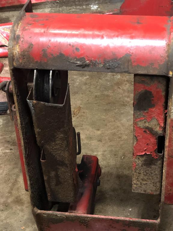

Used my 79366 snowthrower twice and it broke...need advice
bizzo15

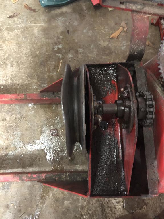

So long story short I scored a two stage snowthrower for my 520xi in the off season and hooked it up to my tractor and finally got a chance to use it this past weekend after we got a storm that dumped about a foot of fresh now.  First time out everything was going good and the snowthrower was moving snow like a beast, I did notice though when I got to the berm at the end of the road the blower would shake and vibrate pretty good when going through it.  I thought it was just normal operation since the snow tends to be more compacted from the plow, I just made sure to go nice and slow when I got to the end of the driveway and was able to clear my driveway and the neighbors without any issues.  Fast forward to the next day and I fired up the tractor to clean up the driveways as we got another couple inches over night.  Was able to finish my driveway but halfway through the neighbors when clearing the end of the driveway the blower shook and the suddenly stopped.  I shut it down and looked around and noticed the belt was broken, I didn't think too much of it as when I put the blower on the tractor the belt was showing some wear but when I saw how expensive the toro belts are I decided to run it as it looked like it would make it through another season no problem.  Once I got it back in the garage I removed the belt and that's when I noticed that something didn't seem right, the spring loaded pulleys on the right side of the pulley box were hanging below the blower frame, I took the chain and belt cover off the blower and noticed there's damage to the main belt pulley on the blower as well.  I pulled the pulley box off and noticed that there's groves worn into the metal from the pulley and what looks like some belt rub.  Anybody have any clues on what caused the belt to fail?  I'm including pictures to hopefully give some clues to those who have used these blowers extensively.  I followed the manual while installing the blower but I'm wondering if maybe I don't have something assembled correctly or am missing some crucial part.  I'd really hate to spend the money on a new belt only to have it blow because I didn't correct the actual issue.  I will say all the bearings seem tight on the blower and there doesn't appear to be any play in the shafts.  I look forward to any insight you guys can offer, thanks.

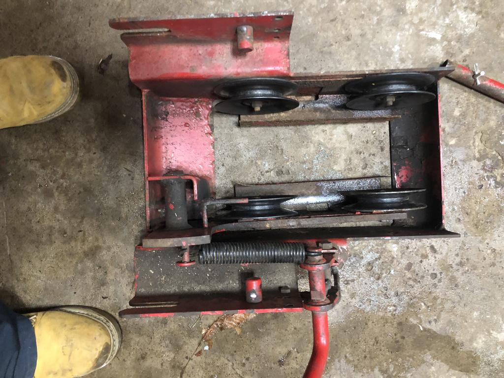

I Don't Have One Of These Units, But For What It's Worth Get A Manual On This Unit And Double Check Everything. It Looks Like Maybe There's A Spring Missing That Broke Off On The Previous Owner Or Something Of That Nature And When It Made That Noise Or Vibration You Heard, They Decided To Get Rid Of It. Also Check For Slotted Pulley Holes, Sometimes People Like To Open Them Up A Little Bit To Either Accommodate Another Size Belt Because Of Price Or To Try And Make The Belt Even Tighter Than Is Recommended Because Of Slipping. Also It Would Be Good To Know If All The Pulleys Are The Correct Size As Well, Maybe It's Supposed To Be A Different Size. People Do What They Do To Keep Things Running And Without That Information At The Time Of Sale, We're Left Scratching Our Heads. Good Luck I Hope Some Of This Helps You Out.

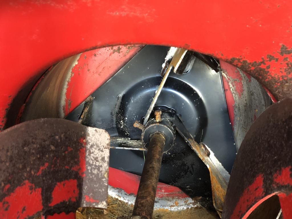

Check the auger gearbox for oil, if it was leaking which most do, then you most likely ran it out oil and hence maybe locked up the impeller to auger which is driven by the PTO pulleys, how about a picture of the auger gearbox and impeller, also those thin bronze bushings on the end of the auger are to say the least a joke...many threads on here of the 2stage redone for the classics same basic unit except for how the PTO drives it.

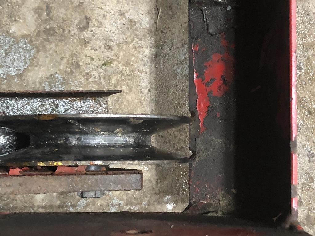

You may also need to pull the pulleys off and check the bearings in them to see that they are all turning smooth.   Bearings on these can fail and lock up.    Also I have found new belt is always a cheaper item to buy on a tractor and the attachments than the alternatives.    Tillers, snowblowers and mower deck drive belts get a lot of abuse.  The parts manuals Garry posted should help ID any other issues!   If you need more help post what you need and this Red Square bunch should narrow down the culprit!

Kind of looks like the belt broke and doubled over in the drive pulley. Figure if all the other stuff the guys pointed out is good, and it turns easy, that is probably what happened. I am not to familiar with XI models but is there clutch that slips or does it rely on the belt? Wondering what happens if you hit a pile of frozen snow.

Youre right about a new belt being cheaper and it was me being a cheapskate and that usually always comes back to bite me. Someday I might learn. I will double check all pulley bearings to see if I notice a bad bearing.

The auger still turns freely but I will take some pics and double check the oil level when I get home from work.

So I finally had time to check the auger gearbox and impeller, everything turns freely without any suspicious noises while being turned by hand.  I removed the drain plug to the gearbox and it appears to be low on oil so i topped it off but I doesn't appear it was ran dry or anything.  Here are some pics as requested.  Let me know if you spot something out of the ordinary, this is my first wheel two stage snow thrower so I don't know exactly what's normal or not.

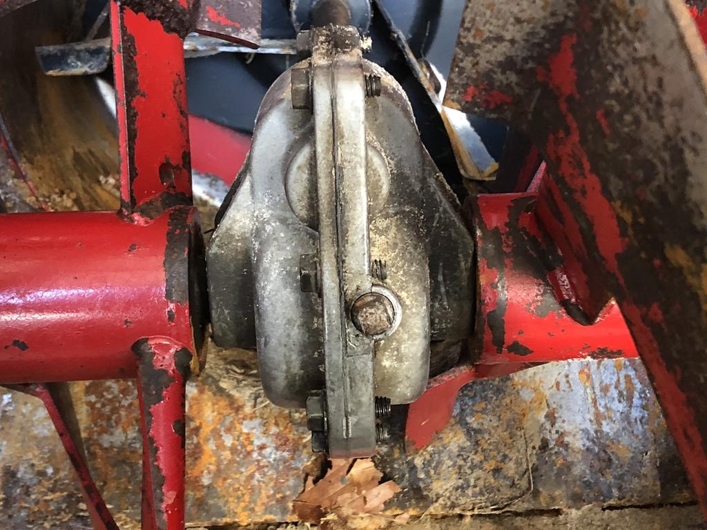

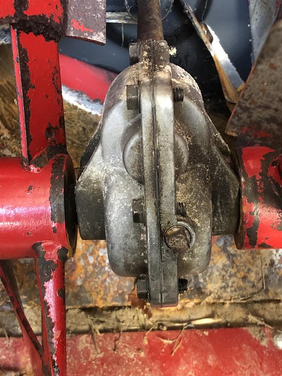

So today when I got home from work I walked into the garage and immediately smelled the distinctive smell of gear oil.  I walked over to the blower and it had leaked all the gear oil I put into it on Saturday.  So now my guess is that the gear box was empty and caused my belt failure.  Weird that it still spins freely with no noises but I'm going to guess the internals are toast.  I did a couple preliminary searches but couldn't find anything where someone did a detailed rebuild thread on one of these two stages.  Does anyone know where I could locate a how to or a detailed rebuild thread so I can see what I'm getting myself into when I tear this apart?  At this point I think I'd like to go through the whole blower top to bottom so it's turn key for next season as I doubt I'll have to the time to properly repair it this winter and I have a backup walk behind blower I can use.
WHMan2012
First Off, These Gear Boxes All Seep After A Few Years, Not Uncommon. If You're Able To Spin This Around With No Noise Or Hesitation, I would Snug Up The Bolts On The Gear Case For Now, Fill It Back Up And Look Else Where For The Problem. I Think The Shaking You Felt Was The Belt Rolling Over Before It Broke. Try Fixing The Pulley And Put Another Belt On It And Try Rolling It Over Slowly With The Engine And Listen To It Carefully. If You See Or Hear Something That Just Isn't Quite Right Then, Then Shut It Down And Start Your Teardown Process. But If It Were Me I'd At Least Like To Know Why Before I Start Putting Time And Labor Into Something Without Knowing What The Cause For The Belt Breaking Was In The First Place. Could Be Just An Old Cracked Belt That Caught The Pulley Just Right Which Caused It To Do What It Did. Just My Opinion, Good Luck And Let Us Know What You Find.
You say the auger turns, from which end of the gear case, input shaft or by grabbing an auger on the output side of the gear case. If the auger spins freely like it has a broken shear pin then the brass crown gear inside your drive is toast.
It turns freely from the input shaft side, I can't turn it using the augers.
