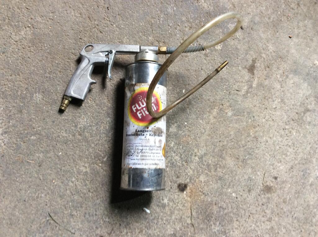

I use normally spray Wax for Cavity Sealing.
therefore i have an gun with a longer hose to applicate.
that helps prevent to rotten such parts from inner to outerside.

Here‘s a pict of my applicator.
works with Corosions protective grease i.eg mike sanders or fluid film grease and oil
and even also with Wax and a Wax oil mixture.

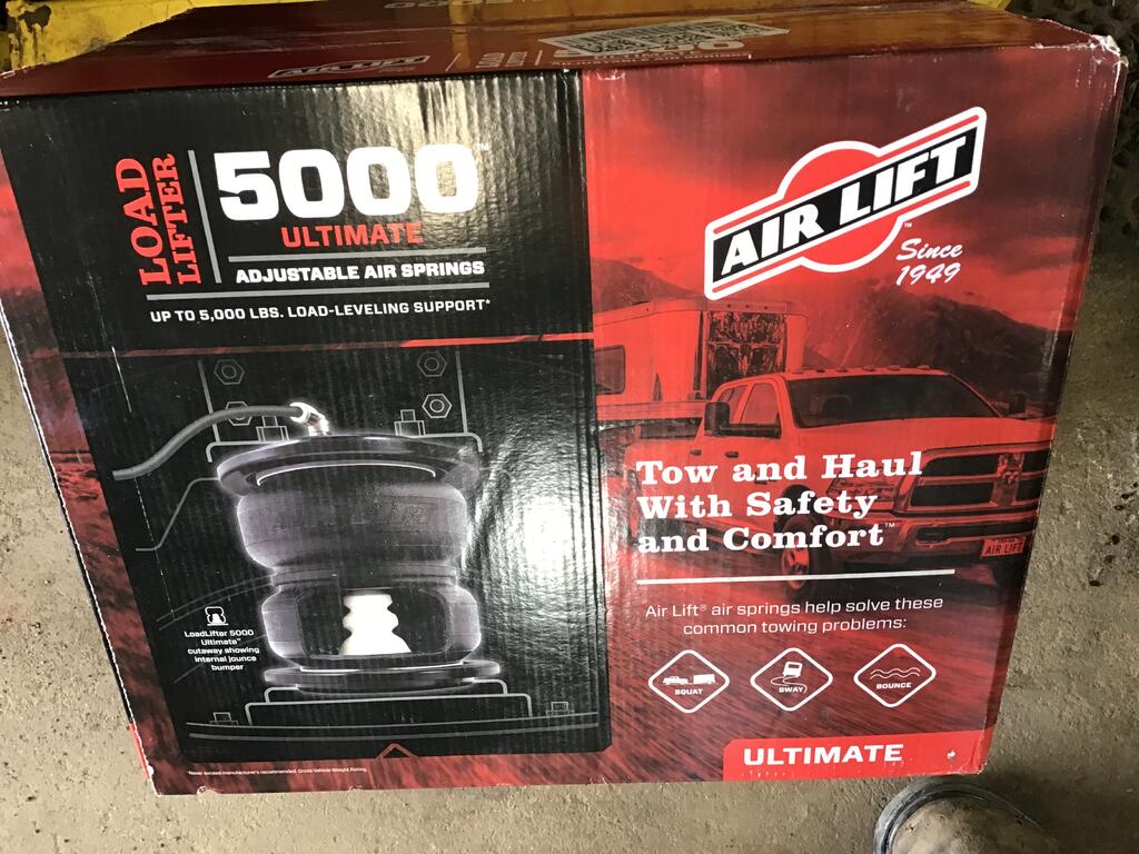

All kinds of excitement around Pullstart Stables today!
Norman will never need to squat again...
  • Excellent 3
lynnmor
Since you are up there in cold country, read the instructions about adding air brake fluid (alcohol) to the bags.  Easy to do before installation, a pain later.
  • Thanks 2
thanks for the help on that!  Question (probably in the instructions). I don’t drive this during winter time.  Does it still apply?
lynnmor
I don't know if any harm would be done.  As you know, when air is compressed there is usually water in the system.  The alcohol is cheap so I added it.
  • Thanks 2
Norman got those air bags tonight... with a dose of air brake antifreeze in them!

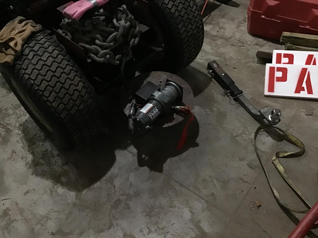

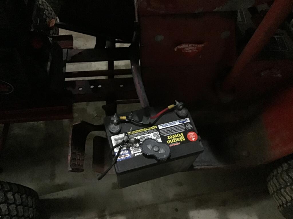

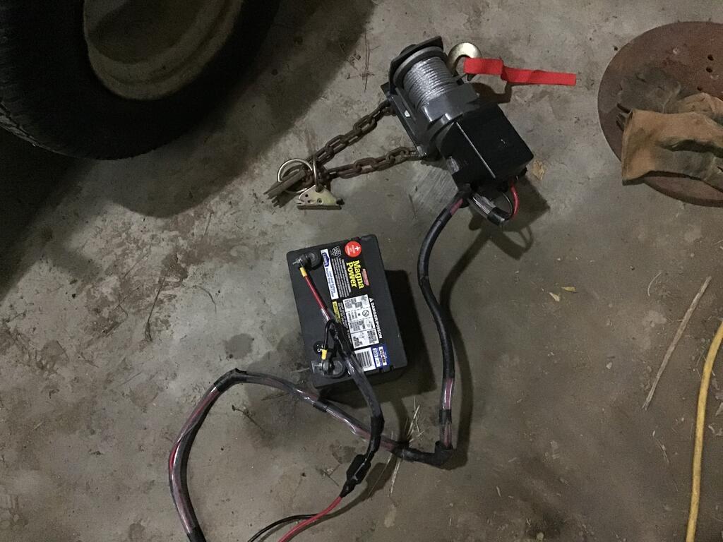

Now, I’m borrowing the WHRat’s winch setup for Norman’s deck.
I now have an E-track compatible wireless remote winch!  I’ll likely add a pigtail to plug into the trailer harness to charge the battery during use.
WHX??
Be careful with the e-track business. They have been known to pull out. The track itself is not real hi test.
Didn’t know that, thanks!  I’ll make sure to at least attach to the closest to a good bolt then. :handgestures-thumbupright:
