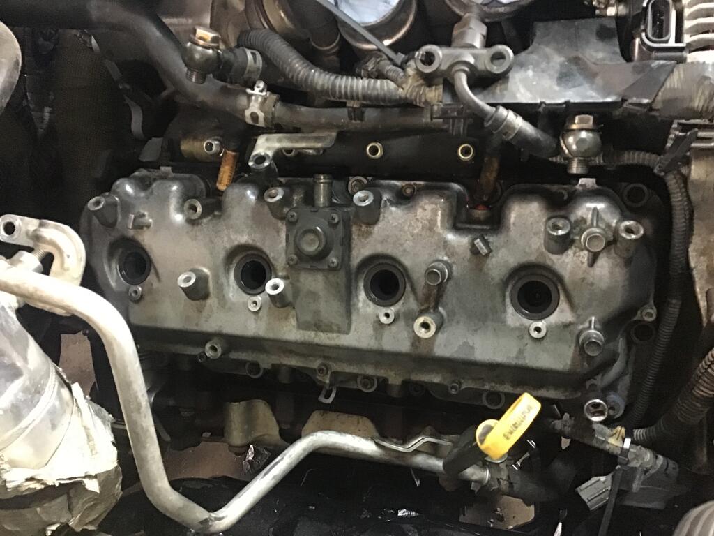

If I haven’t yet mentioned, the valve stems all have a very close depth from a straight edge across the lower valve cover.  I am on the way to re-assembly on this side then I’ll start it back up for a test listen.  No big pulls or road tests until both sides have strong pushrods!

It runs!  It sounds very good!  Woo hoo!  I need to do the driver’s side now, but all is good on the passenger side!

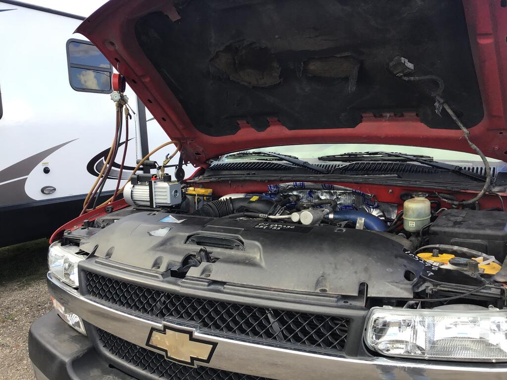

All that’s left to do... vacuum the A/C and re-charge.
On 9/28/2020 at 11:21 AM, pullstart said:
Well, it is Monday.  Next Wednesday, I am supposed to hook up the camper and haul about 5 hours south for the races.  I’d love to have a couple days of drive time around here before that!
By next weekend I hope you mean the weekend of the 10th.                              :wwp:
Winchester, IN for the Winchester 400!  One of the most sought after short track titles... is the winner of the 400!
Don't forget to run the pump for a few hours. You may need adapters to go to the 1/4" flare on the pump and gauge set to the Acme thread for Automotive R134A. Half an hour isn't enough. There will be moisture trapped in the evap and accumulator  as well as that muffler set up on the compressor. Overnight is best.
Edited by squonk
Yep, it’s been pumping overnight, since about 4:30 yesterday thanks to your previous professional advice.:handgestures-thumbupright:
