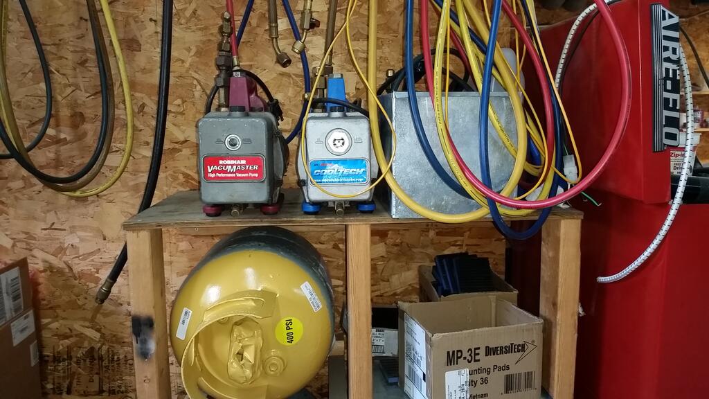

He's right & youda had one for FREE if Ida known ... I kinda hoard them...
Can't believe a High Roller like Jim has a couple of old ratty Robinairs around and not a high faluting Appion vacuum pump. Yes Kevin you need to evacuate your ac system. Run the pump OVERNITE. Who cares if you burn up one of Jim's pumps anyway. You had that ac system open for a long time. A common mistake shops make is to run a pump for 20 minutes and call it good cause they are in a hurry. I fixed countless body shop ac problems because there was still moisture in the system.

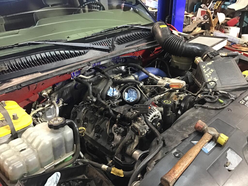

Cool @squonk, I had that feeling but even needed a little confirmation.  Yes, the sound is from the intake pipe.  Lift the filter hat and it’s like sticking your head inside a kick drum.  I feel like the exhaust valve is more of a possibility than the injector, because an injector misfire would likely make smoke in the tailpipe if it COULD escape.
In 1980 we had a brand new V-6 Malibu come into the shop thumping. As I was taking off the air cleaner with it running , the lid was hopping up and down. Bad exhaust cam lobe.

If you go to the end of the video above, you’ll hear the rhythmic thump backfire.  Diesels don’t have spark, so no ignition timing.  Would valve timing be the only possible answer?  There is no smoke out the tailpipe, leads me to one exhaust valve maybe stuck closed?  Pushrod bent or broken?  I also wonder if the pushrod did something which deadheaded the boost which blew the boot... instead of the boot blowing, damaging something else when the boost all went away?
Somehow I always miss threads.. Didn't see this one!
Sounds to me like it's missing on more than one hole. I'd go for bent push rods first. Sounds like it is hitting at times but not fully - like maybe a valve is opening partially. What were you turning when the hose let go? If you overrevved it and "floated" the valves, you could've smacked a piston with one. Hopefully it's only push rod related.. It definitely sounds like it does have compression on those holes so you're probably ok.

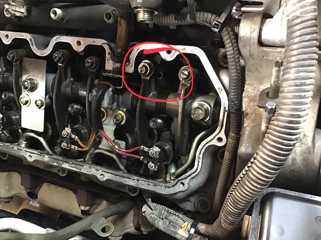

I am going to borrow my FIL’s engine stethoscope tool to see if I can pinpoint which side is hurt.  :handgestures-fingerscrossed:
One of my tool and die tools is a magnetic base and dial indicator.  If there is no visual damage, I’ll roll it over and check the lift and close of each rocker.
Plan of attack is complete!  I think!
The passenger side sounds louder, apart it comes!  Or goes!
Broken exhaust pushrod!  Intake half sucked air in, combustion happened, blew back out the intake, made noise.
I guess my hearing isn't as bad as my eyesight.
So far I have found one bent and two broken rods.  I’ll see about some high performance pushrods to put this back together with.

can you make a short vid pointed to the Rocker arm while cranking to see what‘s happen,
or does it hurts anything?
never heared before that „pumping“ noise, but in the pict i also didn‘t see any troubles on first view.
was the Pushrod completely cracked or does it just hung by a  stuck valve or similar?

Yup. You better find out why before you do more damage. Valve spring binding? Collapsed lifters? Pushrods don’t just give up for the heck of it.
Well, I read now that with increased cylinder pressure (More boost Like the billet compressor wheel) that Duramax engines like to deflect the pushrods.  A turbo boot blew off, but I will likely never know if the boot happened then valve stuff, or valve stuff then the boot blew.

I spoke with a Duramax specialist from a nearby performance shop.  He happens to live just more than 10 minutes away.  We came up with a game plan.  I am going to use a straight edge and depth gauge to measure all the valve stem heights.  A bent valve would surely not close all the way.
Josh and I were on the road for less than an eight mile.  It all happened so quick, we don’t know what happened first but the noise was immediately following the burst boot.
