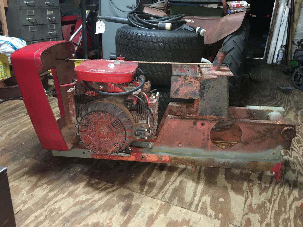

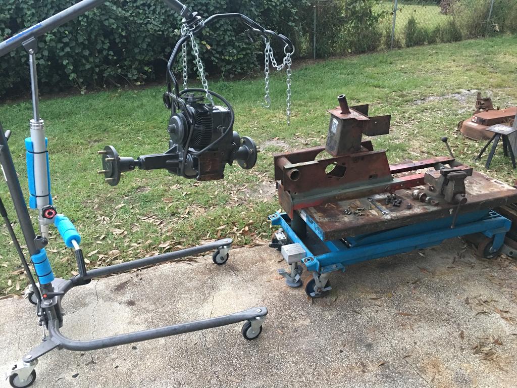

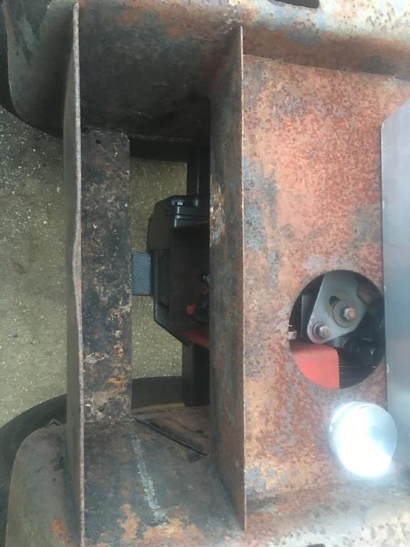

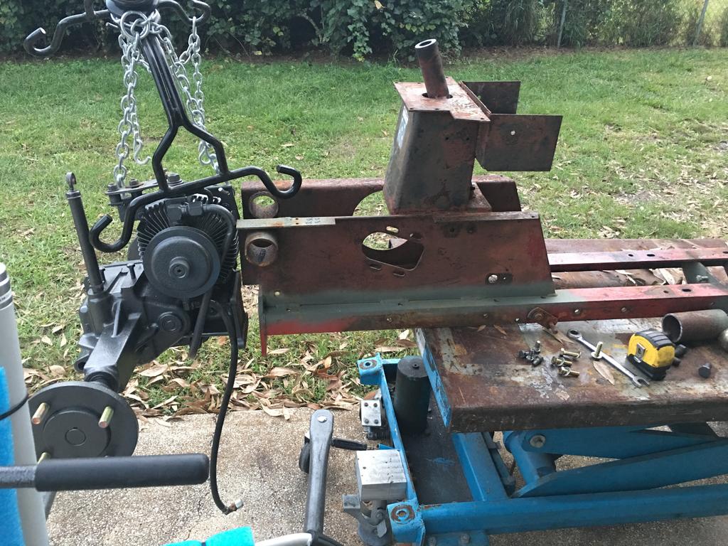

19richie66 16,942 #84 Posted November 22, 2018 So close.... a little more trimming. The cross tube will probably have to go but I’ll ad some cross supports back in later. Plenty of room.👍. This hoya lift I got for FREE is awesome for this hobby. Locking casters, the legs open to fit around things and it’s lightweight. Capacity is 400lbs. Perfect for this work. And my wife can use it to lift me out of bed.😁 4 2 4 Share this post Link to post Share on other sites

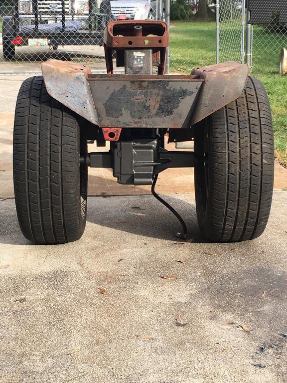

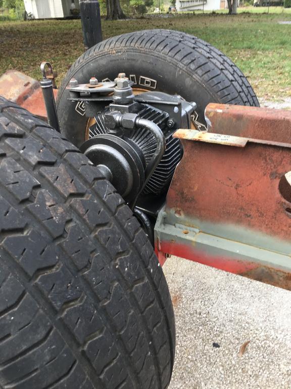

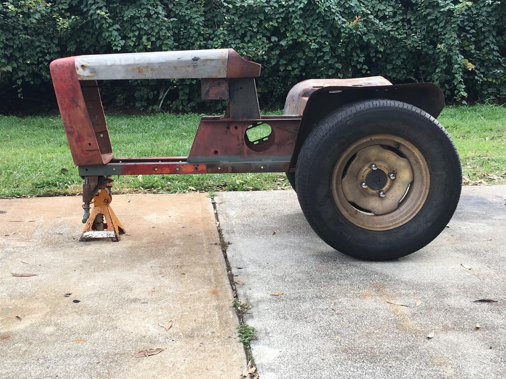

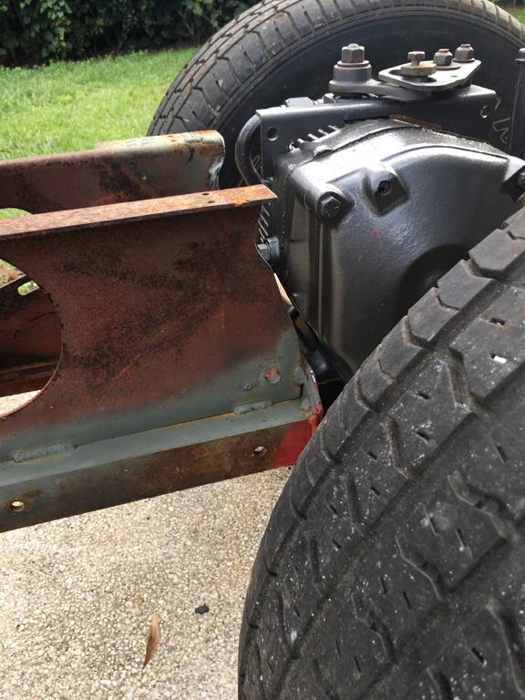

19richie66 16,942 #86 Posted November 24, 2018 Frame trimmed up, trans/frame bolted together. Got some lug nuts and put the rear wheels on so I can move it. Actually fits pretty good. Can’t even tell there is a hydro under there. 3 7 1 Share this post Link to post Share on other sites

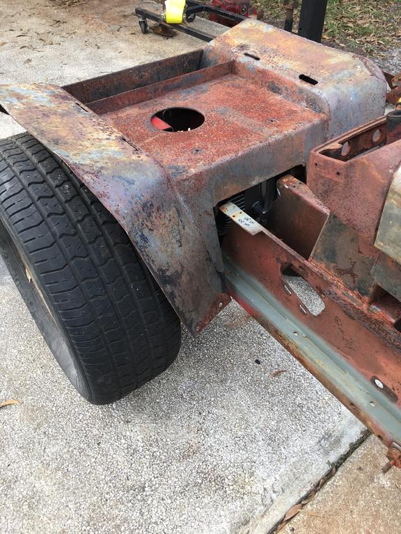

19richie66 16,942 #89 Posted November 25, 2018 Thanks Dell..... let’s see how this turns out first 😁 so far not bad. Biggest obstacle was the tube across the fender pan/frame. Have cut most of it out. A little more trimming and some braces and it should come together nicely. 👍 1 Share this post Link to post Share on other sites
PeacemakerJack 10,670 #90 Posted November 25, 2018 Those elephant ear fenders look great with the “car” tires. Looks from the back like you are building a mini street rod! With that big twin in there, we could even classify it that way maybe with a slight bent on the term like “lawn rod” Looks so great to see it coming together piece by piece. This is gonna be one sweet ride when it is done. Pretty awesome to see that beastly Eaton 1100 nestled in there. The Mrs. will love cruising the shows on that and people will be jealous of such a sweet ride no doubt! 1 1 1 Share this post Link to post Share on other sites

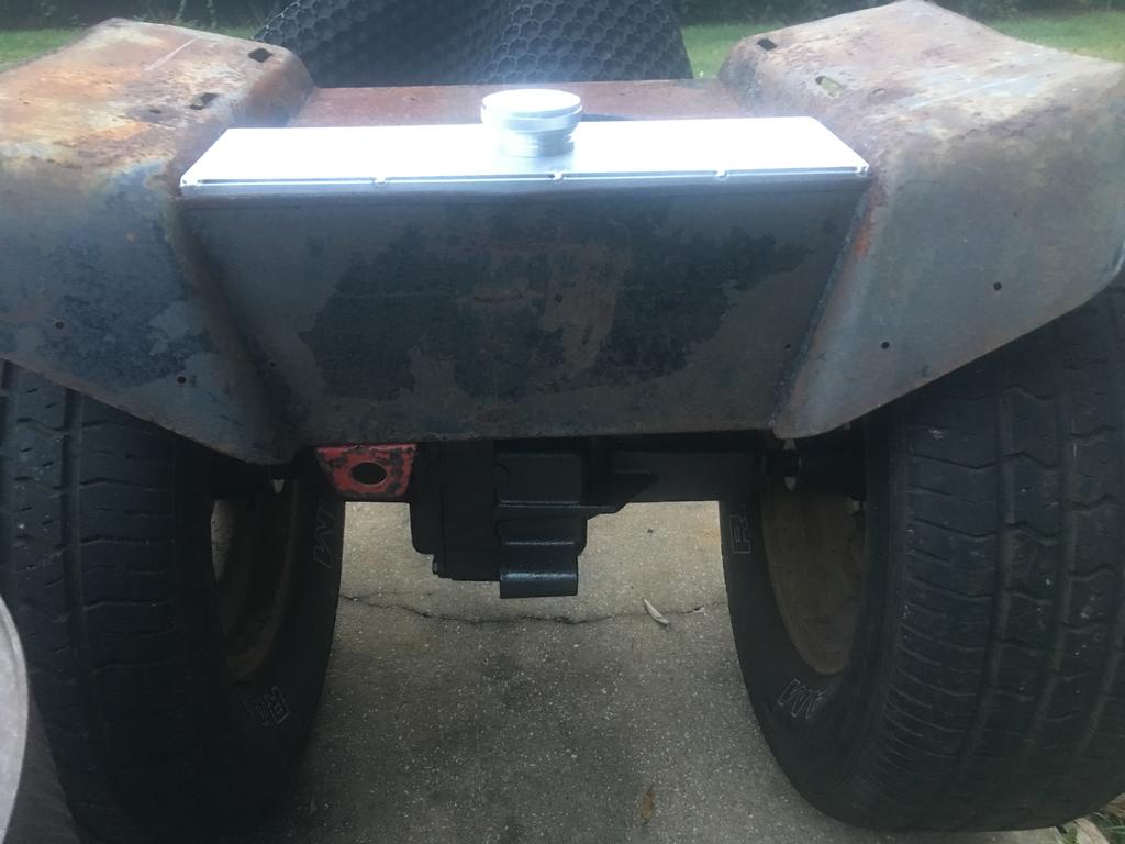

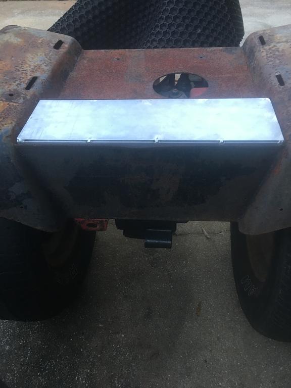

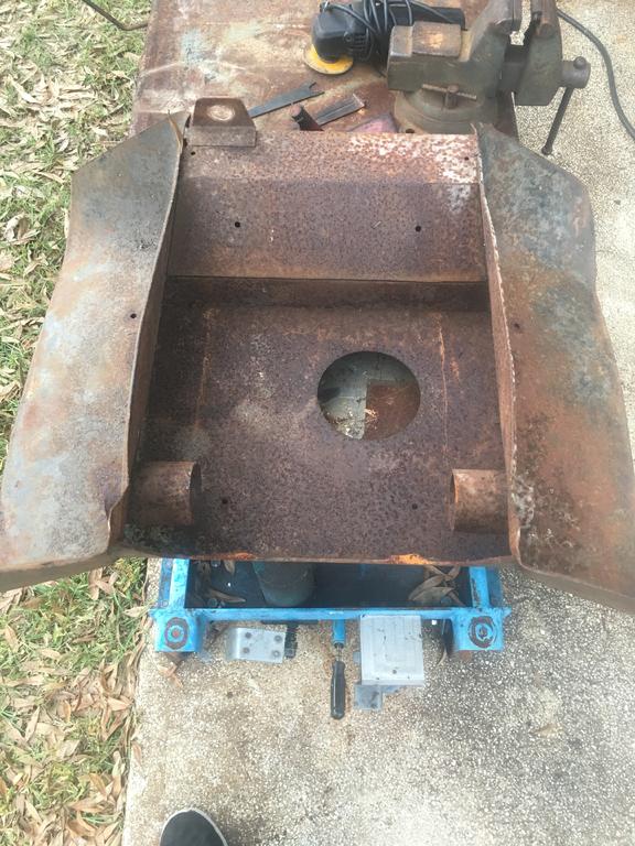

19richie66 16,942 #100 Posted November 30, 2018 (edited) I finally got the aluminum cut for the fuel tank. I got the tacked together and needed to trial fit it before final welding. I had to cut out the angled portion in the bottom of the tool bin so the tank would drop straight down. Fits like a glove. I drilled the filler neck hole and the vent/feed holes and took it back to my son’s for final welding. Think I am going to do this to the 953 I have also. 👍 Edited November 30, 2018 by 19richie66 4 9 1 Share this post Link to post Share on other sites
