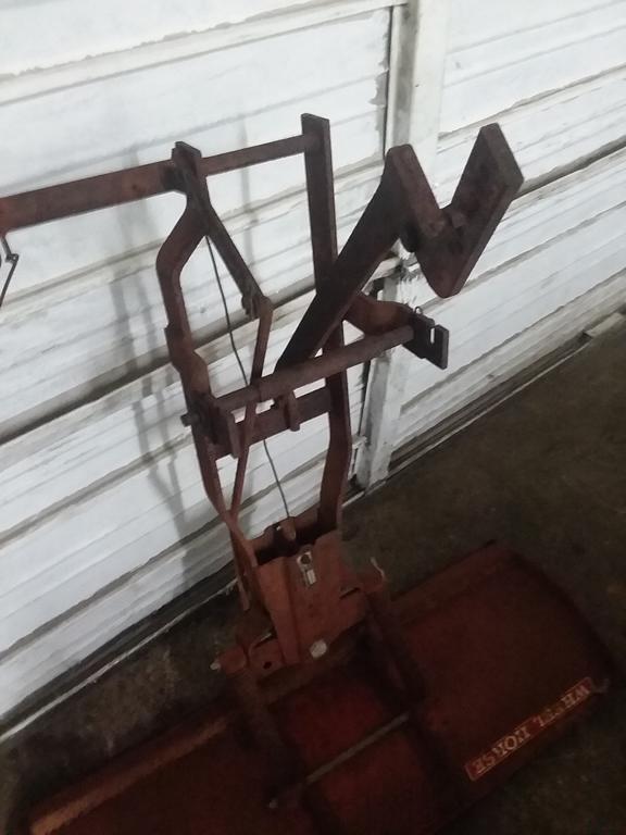

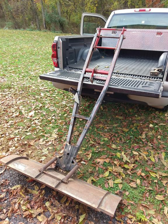

Hey guys, @wheelhorseman, @WVHillbilly520H, brought this stuff home today. Big question did wh make a gooseneck trailer like this? Really hope so, paint looks right and came out of the same lot as the rest of this. Owner swears he had blade and blower on the 414-8 Which means it'll fit my 312-8. He talked me (or bribed) me into taking tractor with me. Got the weights and chains too. $440 for all of it. Tractor runs but has fuel delivery problems.
WVHillbilly520H
He may have had the blade on the 414 but it's not the correct frame, as for the carts most were made by an outside manufacturer such as Ohio Steel so it could possibly be a :wh: branded one and lastly the blower is one of the first 36/42" short chute single stage but from your pic I can't tell if has adjustable steel wheels or flat skid shoes for height adjustments, Jeff. (pic of blade frame for B,C,3,4,500 tractor)
Goldann520
 Ya i know it didn't look right from the start. There's 1 steel bar that bolts to the trans or frame in the back. The blower has adjustable wheels. The badging screems 70s or maybe 60s @WVHillbilly520H
Edited by Goldann520
cleat
That blade does look weird.
Edited by cleat
953 nut
That blade looks like it belongs on a vertical shaft wheel Horse like an !-80, not a 312.
  • Like 1
Goldann520
That looks like it! @953 nut, he swears it and the blower were on the 414, I don't know how.

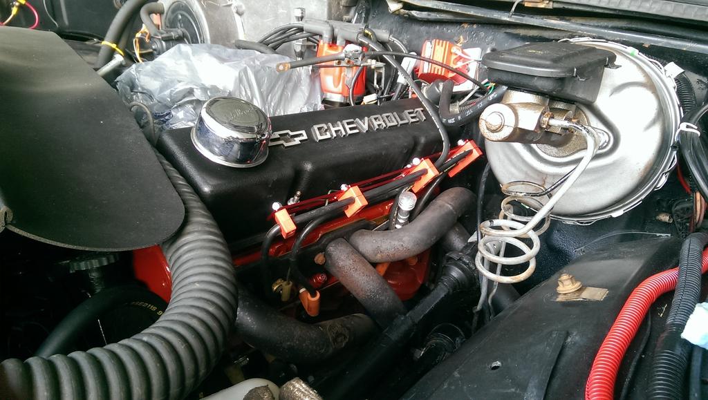

I remembered the bronze/copper '71 not the silver SS, :bow-blue:  many thanks on the extra pics, sorry if it goes vroom vroom we're all just lil boys salivating when we see em in the background one little tip on plug wire routing for those beasts around headers (in my pic) then we'll get back to regularly scheduled programming...

Ya, ya it's a '72 by the way, @WVHillbilly520H, see the turn signals in the grille? That was for the wire comment,😁 also it's Mojave gold

I like to refer to the "bug catcher" as the "ram air" option, since the original hood had battery explosion damage it didn't bother me one bit to take the jigsaw to it, now back to the blade personally I would hang on the the moldboard and angle quadrant then you either find an decent full length frame or someone else may need just those parts to rebuild a worn one since it has more use than just snow removal.

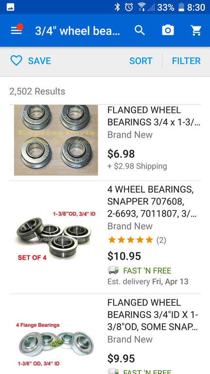

Sorry to lean on you so heavy, @WVHillbilly520H, the left front wheel bearings came out in pieces so where to get bearings and what holds them on the spindles. (414) thanks
WVHillbilly520H
Measure the spindle OD 3/4 or 1"(bearing ID) then eBay has them for cheap...
