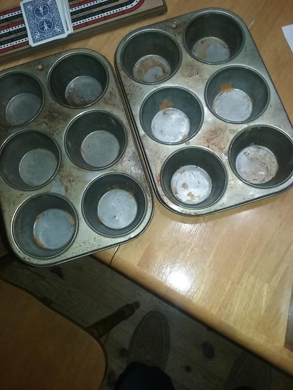

On 12/9/2017 at 10:19 AM, squonk said:
Get a muffin tin or something similar to but bolts in.
Look !
My honey found some organizers under the counter today!
JPWH
I tried that works good till you knock the over. I found as others have said zip lock bags and a Sharpie works best for me.
hmmm... I'd do that.
How 'bout baggies IN the trays???
:ychain:
Go to Staples and get some of the magnet material they make the fridge magnets out of and glue them in to the muffin holes.
