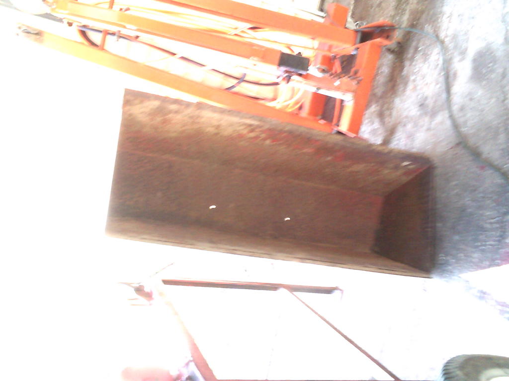

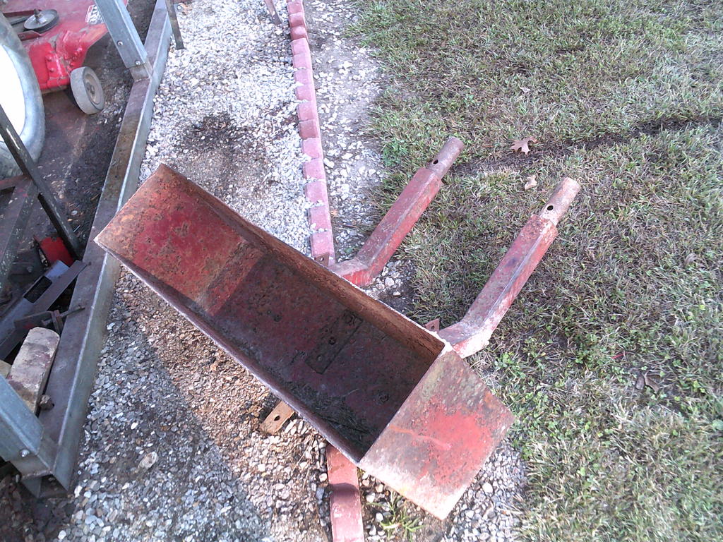

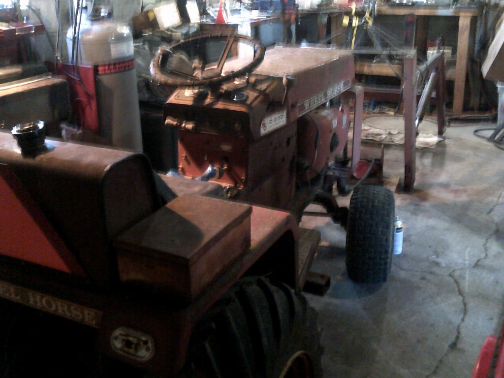

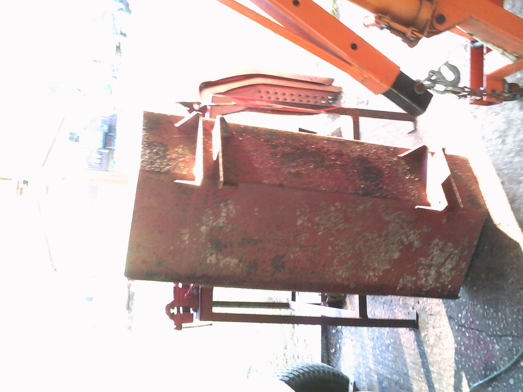

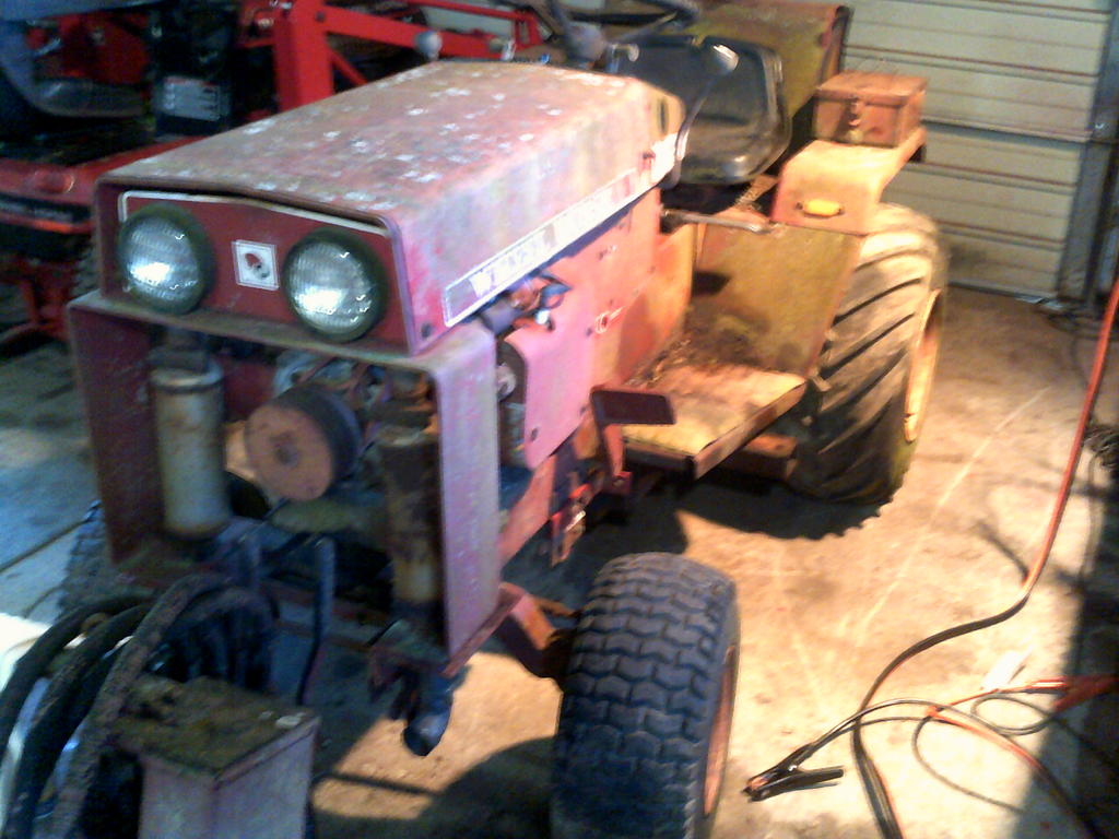

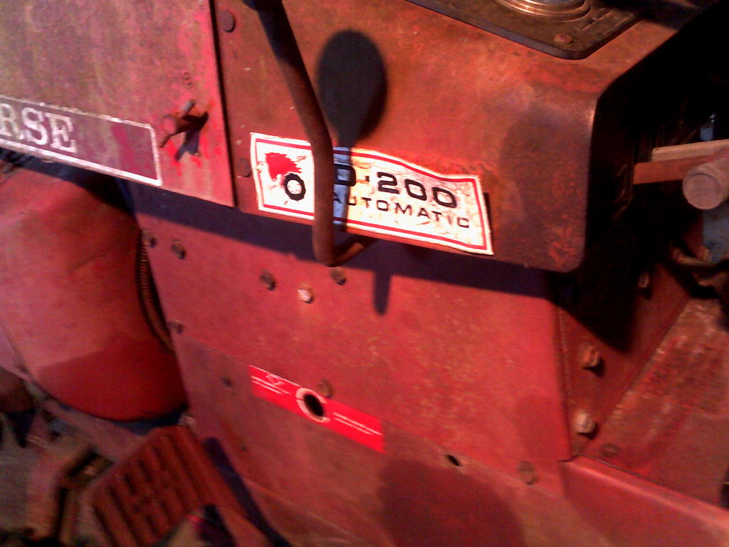

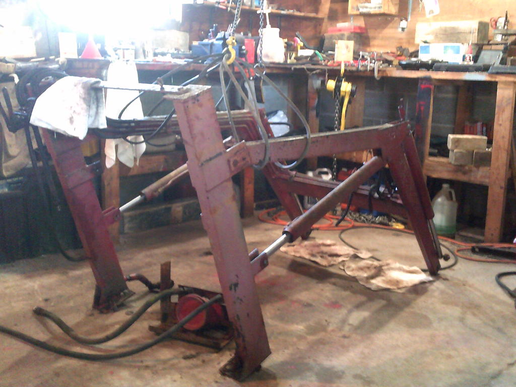

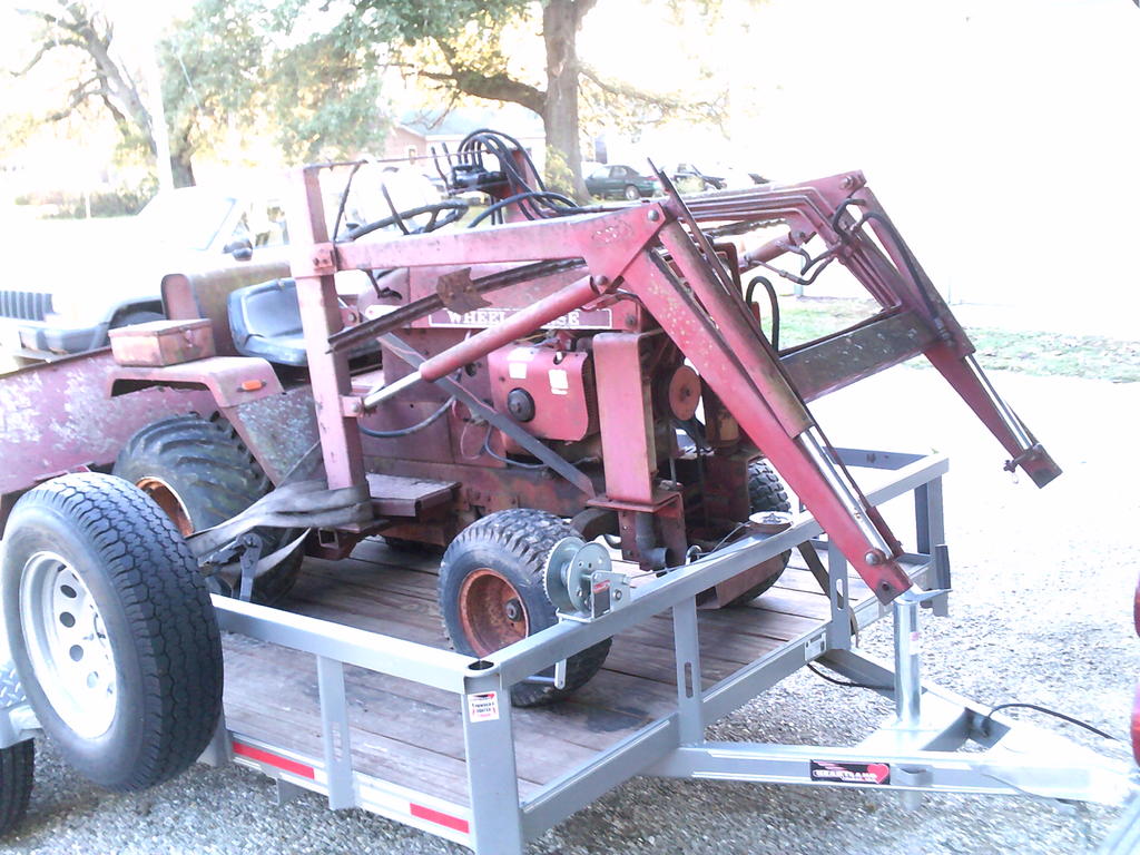

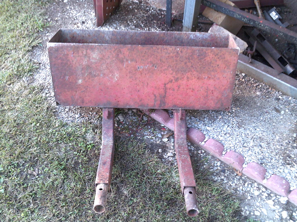

Started another Big Project this morning. D200 With a Ark 550 Loader, got the loader off, needs all new lines, strip the paint and Paint, then start on the tractor, the starter is not engaging, I think its the starter drive, It sat out side for over 7 years, the loader has a good bucker and a wt. box. Will add more pics as I progress. I also have a center grader blade for this beast. This could be a all winter project. I have to get the loader frame work off yet. If someone wants the Tractor, I would take 300.00 cash just the way it sits, no loader. just the tractor.

pfrederi
Great find Loader looks good.  One suggestion, the hydraulic reservoir for the loader is the left hand support column.  if it sat out for several years there could be corrosion inside from condensation and rust chunks .  There is a suction line screen in the bottom hose connection to reservoir.  Clean it and I would add a spin on hydro filter between the valve bank and the top of the reservoir.

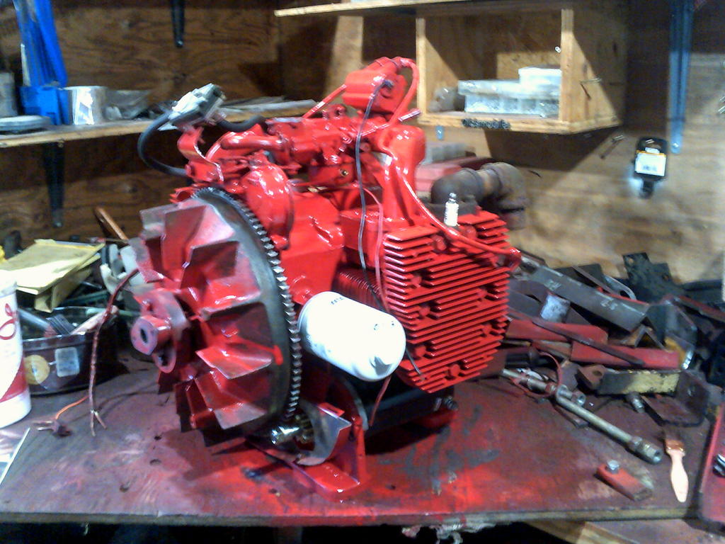

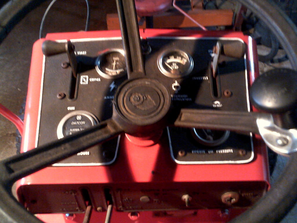

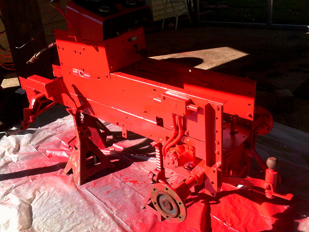

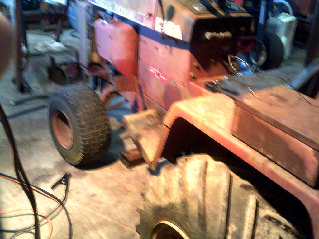

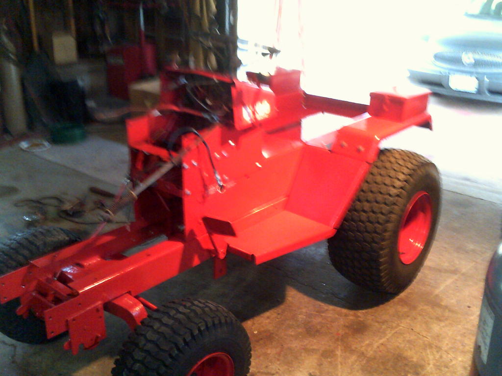

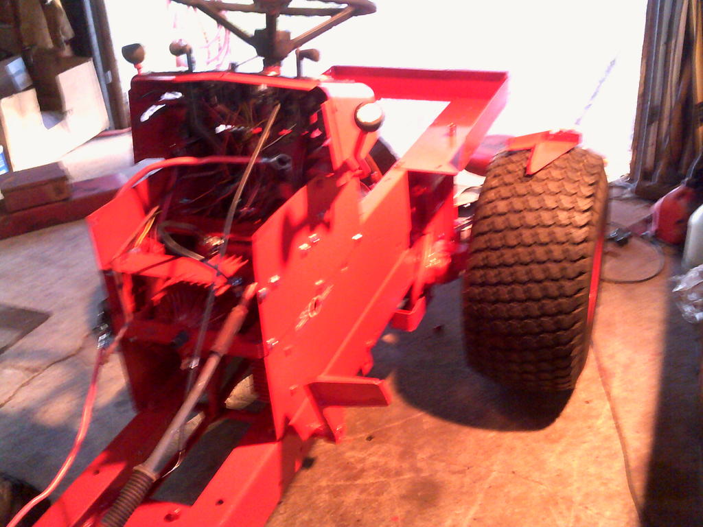

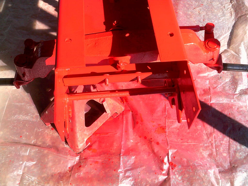

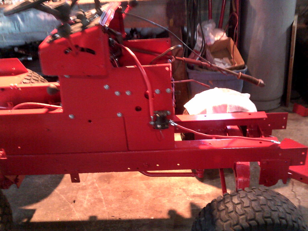

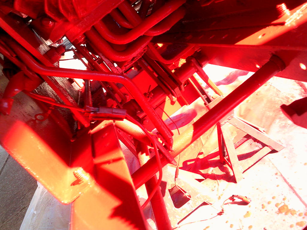

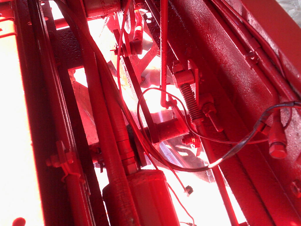

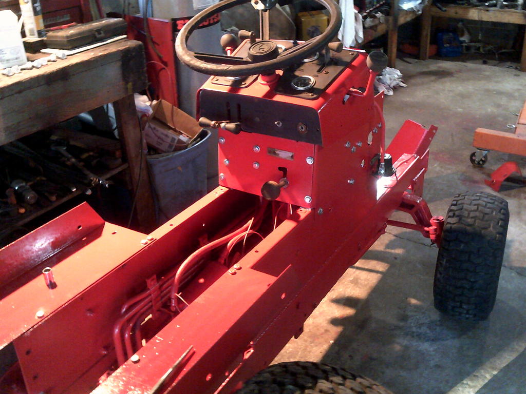

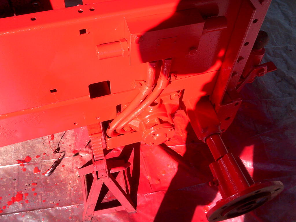

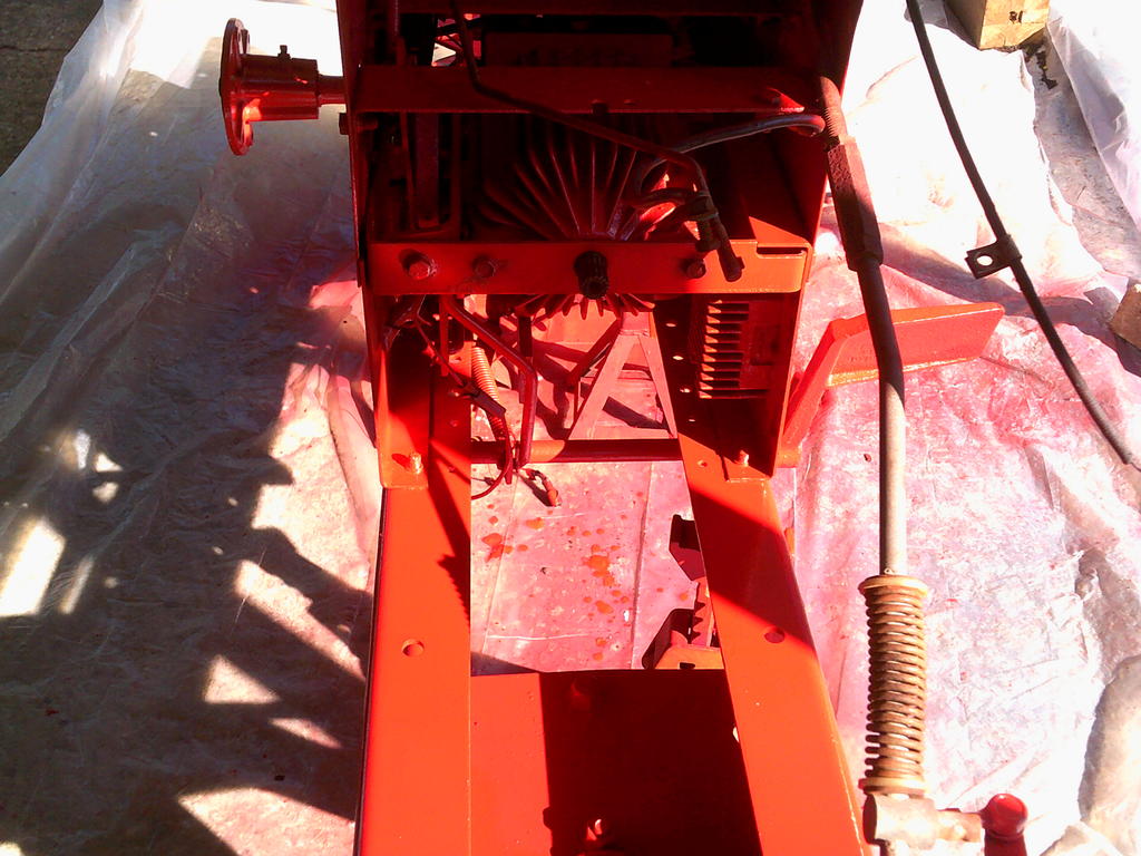

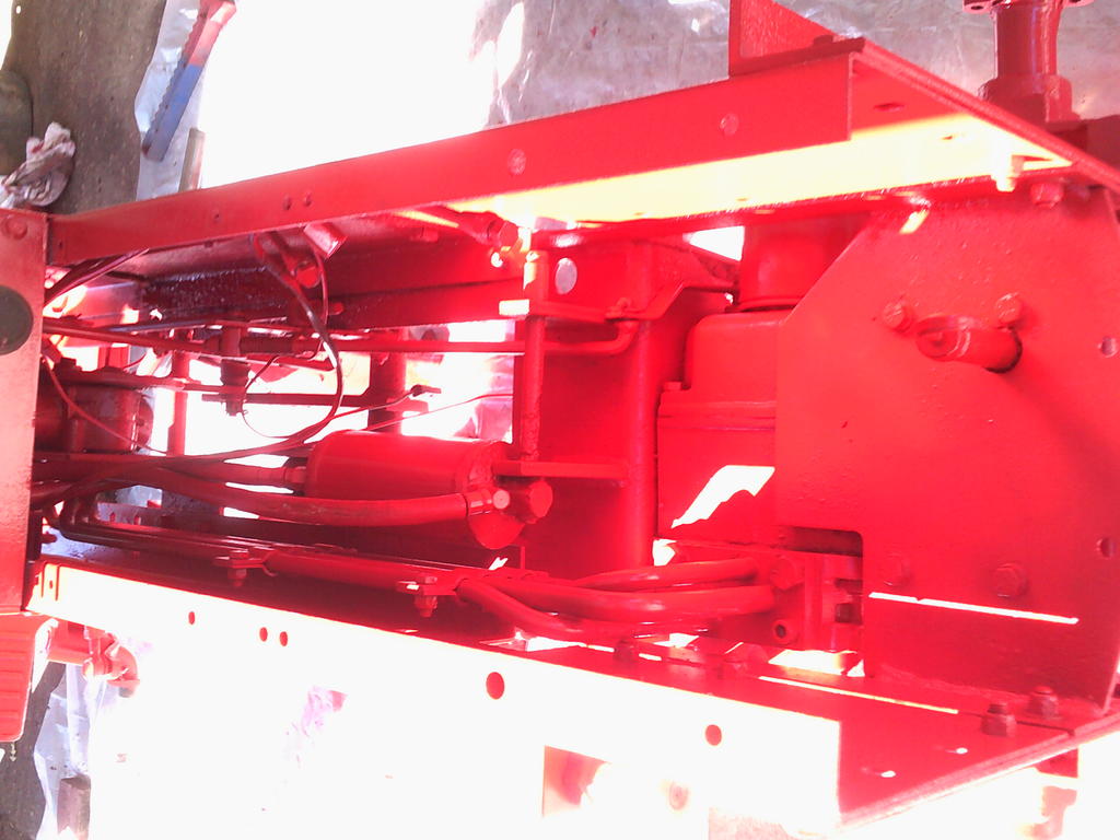

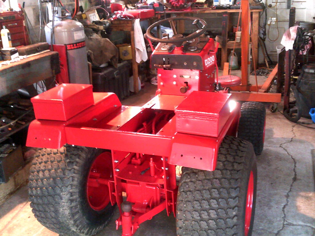

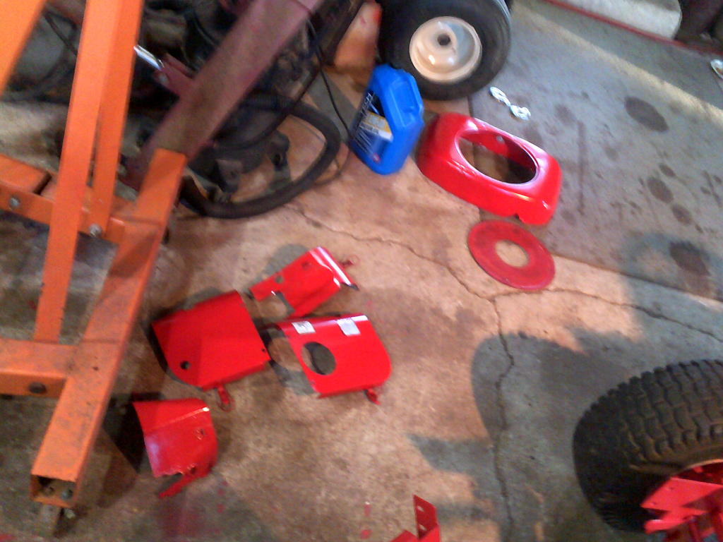

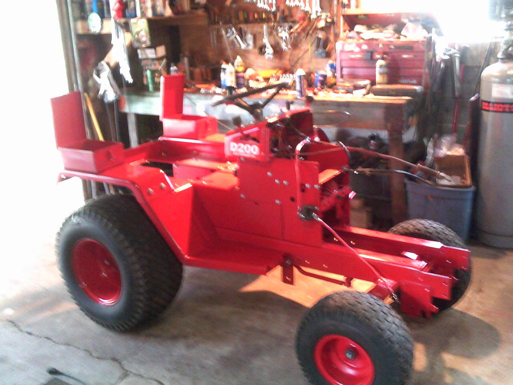

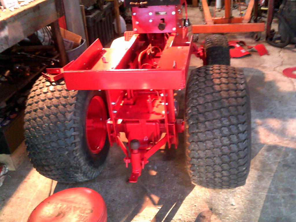

More pics of the project.:)
Edited by elliot ness
more pics
  • Like 2
  • Excellent 2
FatJackDurham
What kind of prep work did you do before painting? I am curious because it seems like you went and painted everything in place, rather than removing every piece and painting separately. Isn't it hard to clean dirt and grease out of all the nooks and crannies? I would think the paint would not last as long. Tell us about it?
Sarge
I'd have to say that took some serious pressure washing and maybe abrasive blasting .

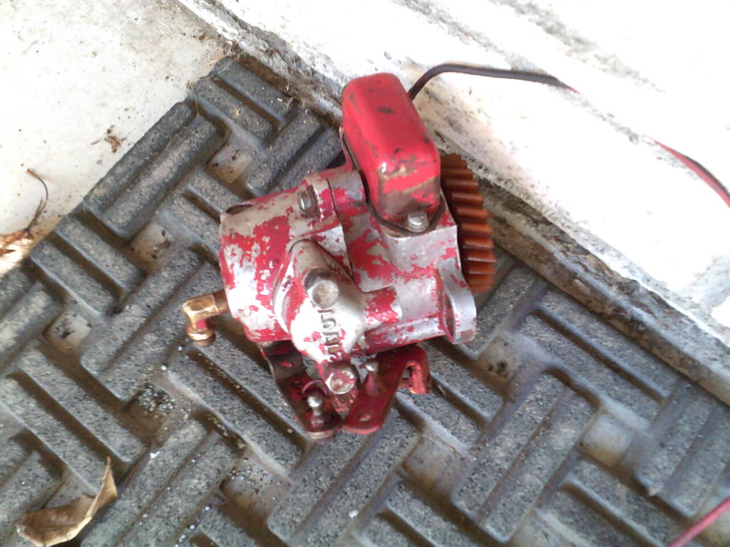

What's up with the governor ?
Sarge
  • Like 1
elliot ness
Sarge
Gasket was leaking, ordered a new one. should be in in 2 wks.
It was blasted with HOT water twice and I finished underside with lots of elbow grease. hand sanded the sides. It's only going to be a work tractor. If I was looking for one to make show room this one would not have been a picked. It sat out side not running for 10+ years, and the right hand side was near a road where it got sprayed with  salt in the winter. As for how long the paint will last, best guess if it put in after using 20 yrs maybe?
