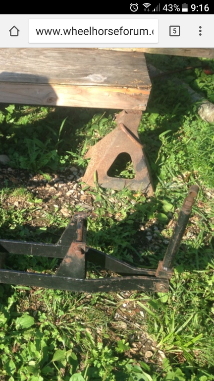

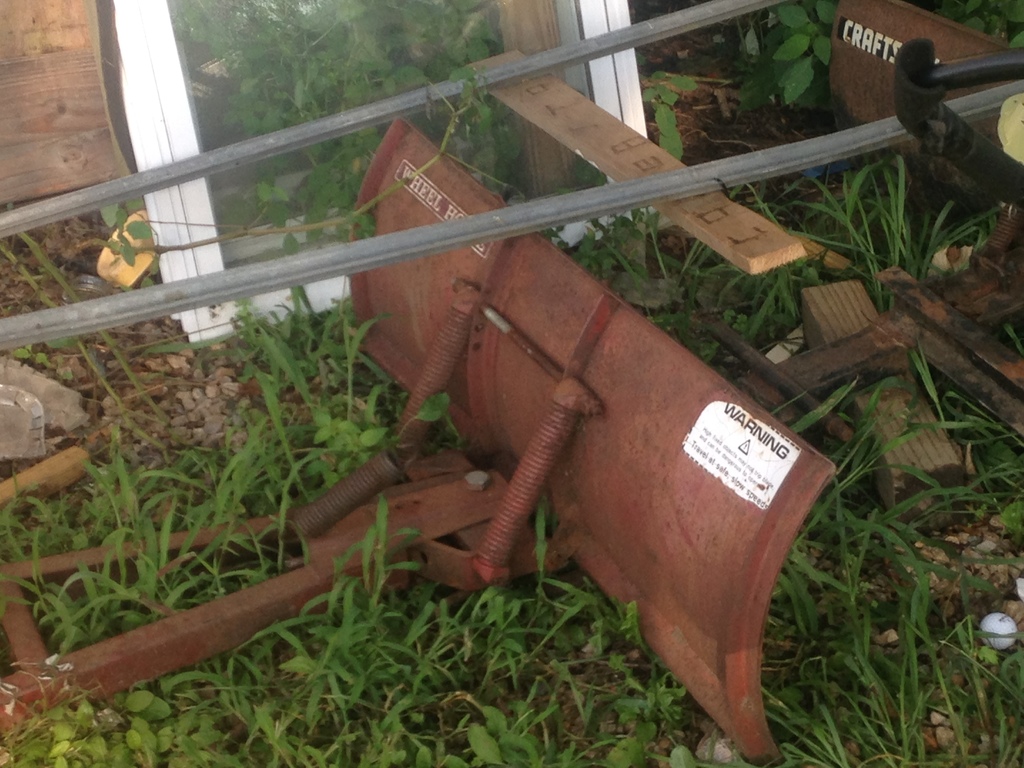

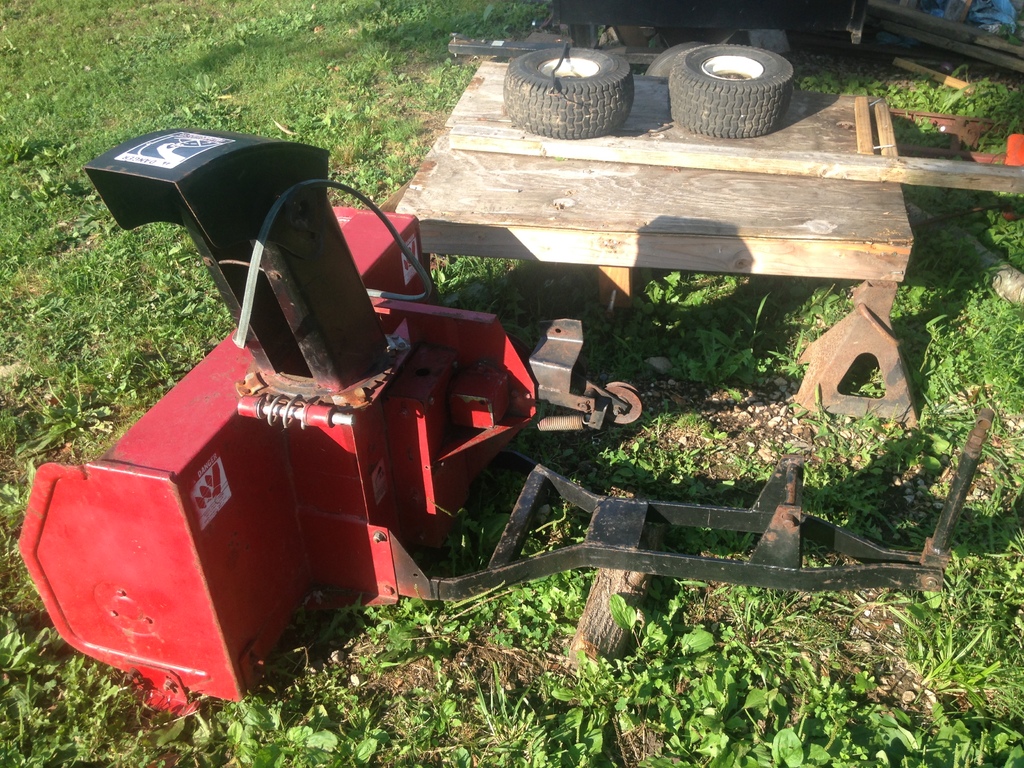

Hello. I recently purchased a 312-8 with blower and dozer blade. I cannot figure out how to hook it up. Please help me!
953 nut
:WRS:       Not too sure about the snow blower, I don't think it is :wh:. Better ask the previous owner. The grader blade will attach to a bracket on the rear axle and a lift link or chain will attache it to your lift. This manual should help.
squonk
Blower looks like a Berco but I have no idea on how to attach it.
Tractor boy
Thank you. Thanks for the Manual. The numbers are
Tractor - 2112k806
Serial 37630
Plow- 86-42bco1-01367
Blower- w-0238
Serial? - 1030
Would it be possible that the lift flag is missing? And I bought it off my boss at work and he said it had everything but the spout rotation handle. I figure I can fabricate something easily.
The front bar goes up into your front attach-a-matic where the mower mule drive hangs and the other swinging bar with tube (lift flag) goes to the lift arm under the tractor sorta like the TORO/WH single stage hook up that uses a long bar and lift flag to lift using the cantilever method,Jeff.
  • Like 1
cafoose
I got the same blower on a 520-HC and had the same problem. The third thread shows how I attached the chute crank handle. Check out these threads:
