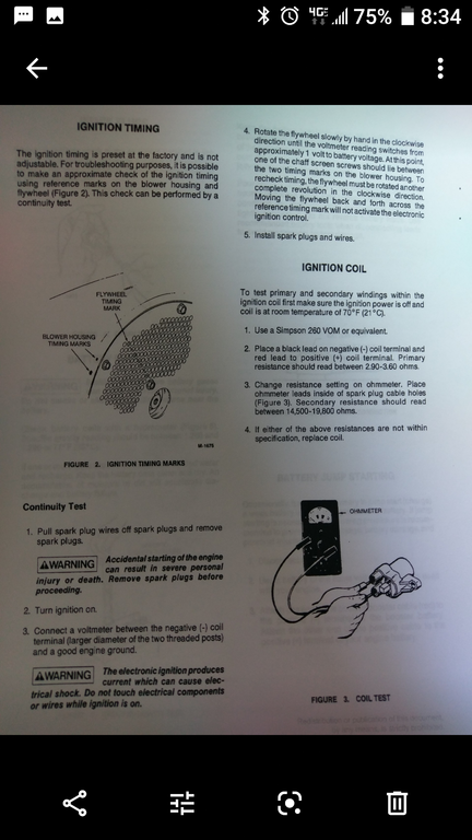

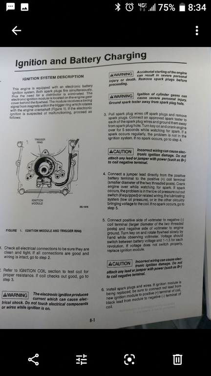

The procedure for checking the ignition parts is in the Engine Manual on pages 8-1 & 8-2.

6 hours ago, Duramax7man7 (Mastiffman) said:
You can test the coil itself but on the Primary coil (small wire posts) as well as the secondary coil (main spark coil posts) for continuity and proper resistance.  I believe the secondary coil will be around 16k-19k ohms...
IIRC, You can also test the wires coming from the ignition module for signal as you are turning over the engine?
 Either way, you can find all that you need to know from the demystification guide for testing the ignition components to find your issue.
Anyone have a picture or ignition module or know where it's located on 520H?

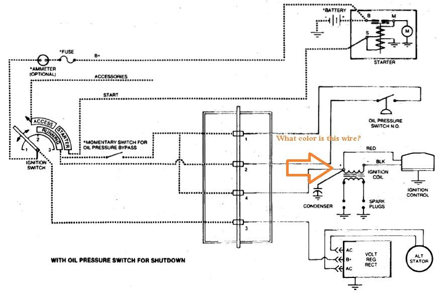

corpline

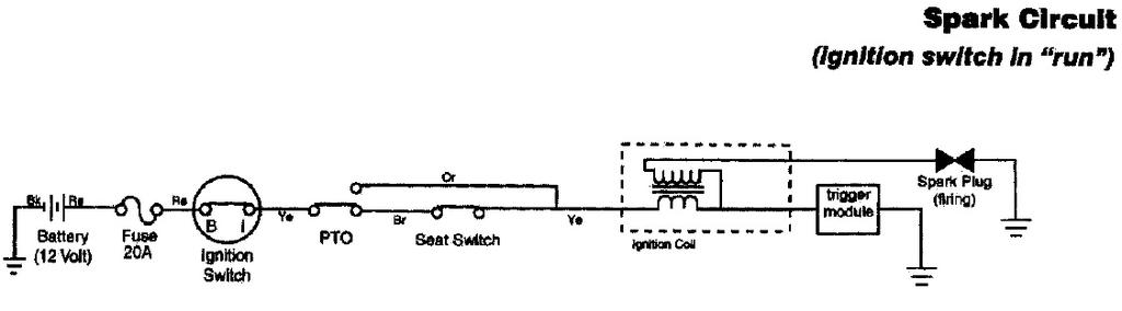

Just to confirm secondary coil test for measurements, do you stick 1 Ohmmeter lead in the spark plug wire on the coil and 1 Ohmmeter lead to negative post? Ohmmeterresult of this measurement NO reading. Or do you stick 1 Ohmmeter lead in the spark plug wire connection on the coil and 1 Ohmmeter lead in the spark plug wire on other coil connection? Ohmmeter result of this measurement also NO reading. I agree you should get a Ohmmeter reading between 16K to 20K ohms. When measuring primary, I got 3.5 ohms so we know this is okay. I did discover shorter spark plug wire to be faulty (no reading) but not the longer spark plug wire (13K Ohms). Of course, neither wires would produce a spark on the plug. My guess this new ignition coil part is bad. I am still curious on the ignition module and where it's located. As mentioned when ignition is turn ON, I am getting 12 volt reading between YELLOW wire and BLACK & ORANGE wire. Looking at the schematic diagram I see ORANGE tied to PTO switch but how can I be getting 12 volts between YELLOW and ORANGE especially when ORANGE and YELLOW are tied together on the coil post?

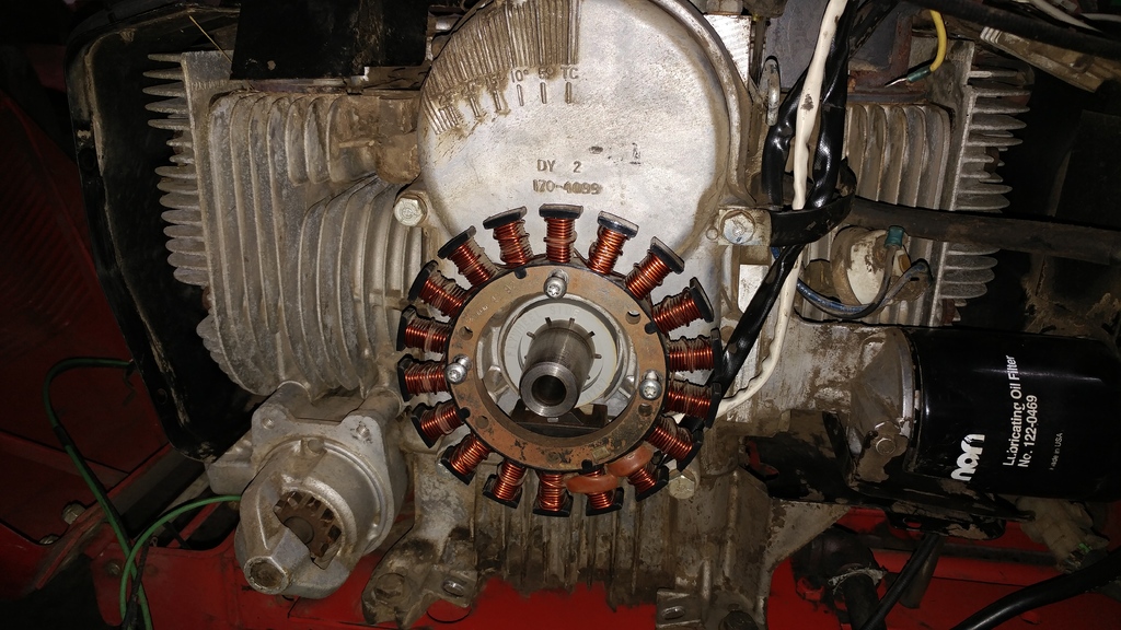

WVHillbilly520H
It is located directly behind the flywheel.
  • Thanks 1
corpline
Thank you WVHillbilly520H for the ignition ("trigger" labeled on spark circuit diagram) module pictures. I see from one of the pics on this module you have ORANGE (or maybe RED) and BLACK wire together in a insulated conduit which I noticed on 520H after removing the ignition coil I am working on. If that's an ORANGE wire then I just answered my question above (previous post) and but puzzled at spark circuit diagram because ORANGE wire shows on the diagram tied together with YELLOW and to PTO section (pic above). Anyone can maybe shed some light? If ORANGE and BLACK wires are coming from this ignition (trigger) module then this is like a "magneto" and sends pulses to fire spark plug but don't see this color described on spark circuit in the demystify document and wouldn't ORANGE and YELLOW (tied together) short itself?

corpline
Just going through a manual "lynnmor" had posted (P8-7) and found another diagram which shows the ignition (trigger) module and ignition coil wanted to share here. Thank you "lynnmor". This picture shows RED (which I called ORANGE) and BLACK wire attached to the + and - posts on the ignition coil. This explains my 12 volt reading between YELLOW and BLACK & RED (called it ORANGE because of the spark circuit diagram) wire. On this diagram I've put a question asking for the color of terminal connector 4. If this unlabeled wire is YELLOW then where's the ORANGE from spark circuit? Maybe ORANGE is in reality RED.

Duramax7man7
Yeah that wire is the yellow one. You have it in your pic just like Cleat does...
 Did you find the section in the manual to test the Primary and Secondary Ignition Coil winding's?
 1.For the rest. First test and make sure that you have continuity from the battery Neg terminal to all of the grounding areas on the tractor including switches.
 2.Test to see if you have power coming OUT of the fuse box from the batter positive terminal on voltage setting. If you do move to next step. If not, Fix fuse box issue. The fuse contacts can loosen up over time and or become corroded.
 3.Next, Turn your key on. Ground your multi meter and then test power coming out of all of the switches. Ignition switch, seat, PTO, etc... If all good, move to next step.
 4. Test coil for proper resistance and NO Cross continuity between the primary (small terminals) coil winding and the secondary (spark plug wire terminals) coil.
 If all good then you most likely have a dead ignition model behind the flywheel (black and red wire with white sheathe. Or a bad oil pressure switch.

corpline
Thank you Garry. Please check this step 3 on Ignition Module testing procedure you had posted which I may add to be VERY useful.

Andrew I will do that once I get spark issue fixed. I just pulled the flywheel and removed the ignition module. I've applied the test procedure Garry uploaded and took the part off and metered the device and "no es bueno". I got no reading what so ever even running a strong magnet in front of it. Now I got to figure out who has this part and order it. You guys have been a wealth of information on diagnosing the issues. I wonder how the part got fried...
Wheel Horse used 12.5hp, 14hp, 16hp, 18hp, 20hp and 24hp Onan engines. It is possible Wheel Horse used a low oil pressure cutout switch on some models but not aware the 520 was one of them.
A tractor model number and serial number to find the correct wiring diagram would confirm it.
Garry

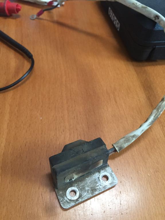

corpline

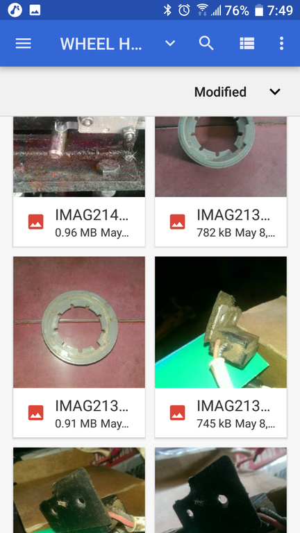

Post-Mortem Analysis of this ignition module I see that any large current or voltage would fry this device. For example, if someone trying to jump start a Wheel Horse with an old-style charger/starter where amperage is greater than (10A) or if someone bypassed in-line fuse and went directly to ignition module looking to test for spark. The specifications of this ignition module device says it's rated for 12 VDC but it doesn't mention how much current. This device requires 12 VDC to activate it and then it switches between battery voltage and 1 VDC which causes ignition coil to fire whenever the magnet passes by. Since this device is expensive (around $271 brand new) there is 20A fuse in-line but believe this is excessive and it should be at lower rating. Just wanted to throw this out and get your opinions. Also, if anyone knows what is the maximum current specified by this ignition module device.
WVHillbilly520H
Hope this helps...

corpline
Finally was able to get all parts installed and fired up wheel horse right after I cleaned up the carburetor from seating a few years. I didn't have a mower battery so used car battery to get it jump started. But what was so strange when wheel horse was running, I disconnected battery and wheel horse would stop running. Based on my previous experience with other types of mowers the engine would continue running even when battery is disconnected. Just wanted to ask the forum if this is normal operation for the wheel horse.
In summary, ignition coil and ignition controller were bad which could not derive spark. Thank you to everyone for your help. This forum gets 100 thumbs up!!!

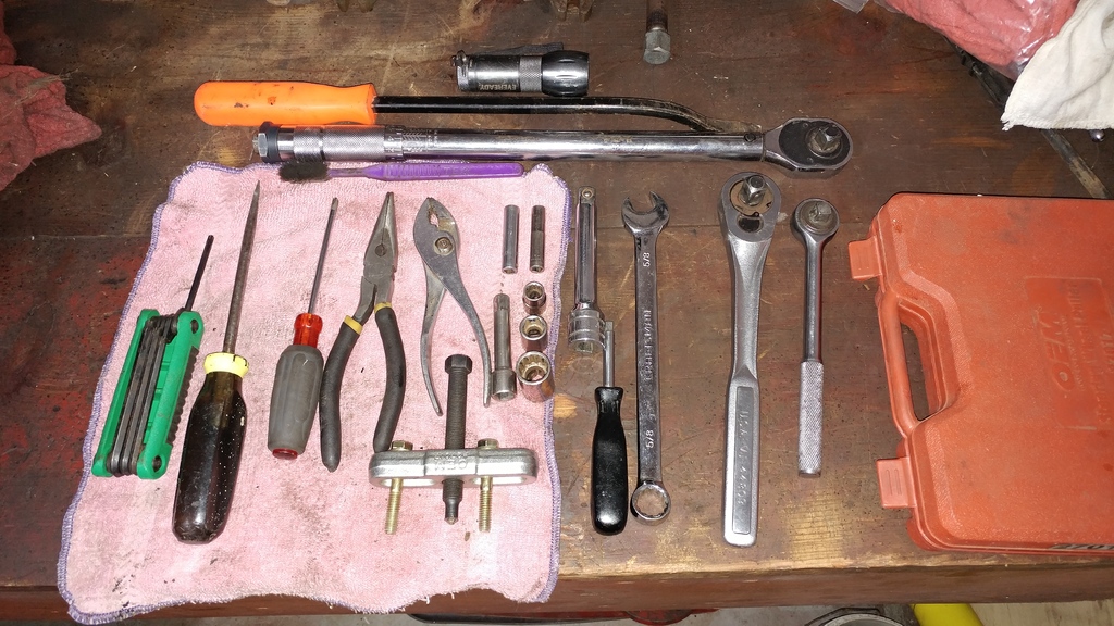

Here is a list of the tools that I needed to complete the job from beginning to the end. They are named from left to right in the photo with the tools at the top of the photo last from top to bottom.
TOOLS:
[From left in Photo]
1. T25 (for the stator screws but also may be three 5/16" head screws)
2. Phillips and Flat Head Screw Drivers
3. Needle Nose and standard slip joint pliers
4. Flywheel puller with 2 5/16" x 18 grade 8 bolts and washers (mine is technically a steering wheel puller)
5. 7mm and 5/16" deep well 1/4" sockets
6. 3" 3/8" drive extension, 3/8" socket 3/8" drive, 5/8" socket 1/2" drive and 5" 1/2" drive extension.
7. 1/4" Socket Driver
8. 5/8" open end box wrench
9. 3/8" and 1/2" drive ratchets
[Top of photo- top to bottom]
10. Flash light (optional but very helpful at times)
11. Pry bar (used to lock flywheel from turning)
12 1/2" Torque wrench
13. Old Tooth Brush (for cleaning of dirt if needed)

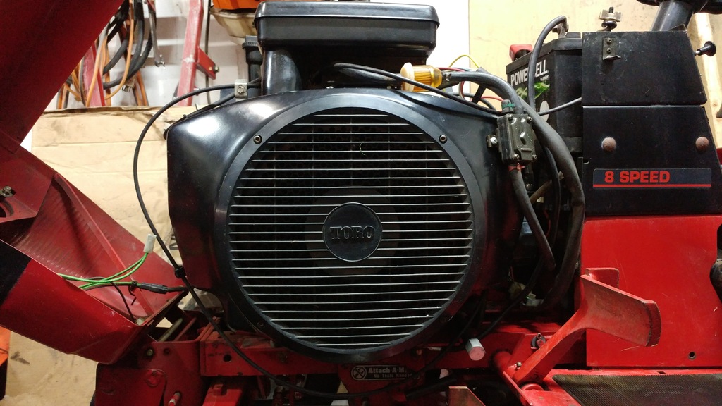

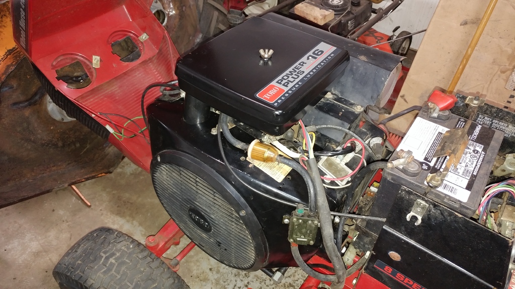

- Obviously the first thing to do for safety sake is to shut of the fuel at the tank and remove the battery cables

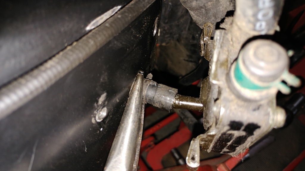

- Next, remove the two screws that hold the fuel pump onto the shroud, move the pump off to the side and replace the screws into their holes for safe keeping.
- Carefully pull the fuel pump away from the shroud enough to work the hose clamp out and use the pliers to pinch the hose clamp and remove the vacuum line for pump.
- Tie the fuel line, wiring harness, choke cable and battery cable all out of the way towards the rear of the tractor allow easy access to remove the shroud.
- Next remove the air cleaner box cap, then air cleaner cap and air cleaner tray by removing the three 5/16" screws from the carb and the two 3/8" screws from the tray and put all aside and out of the way.
NOTE: Close the Choke all of the way and stuff a clean paper towel into the top of the carb to prevent debris contamination.
- Next, twist the air filter box bracket to the left (right side up and left side down) to clear space and use the 7mm, 5/16" and 1/4" socket driver to remove the black condenser wire, the red and black ignition module wires and the yellow ignition switch wire from the coil and then remove the coil using the 3/8" socket. (optional as it can be kept on the shroud but makes it a little more difficult.)
-  Next loosen the rear cylinders top shroud and engine hoist mount bolt with the 1/2" 3/8" sock and extension. (no need to remove the bolt as the shroud just needs to move freely.

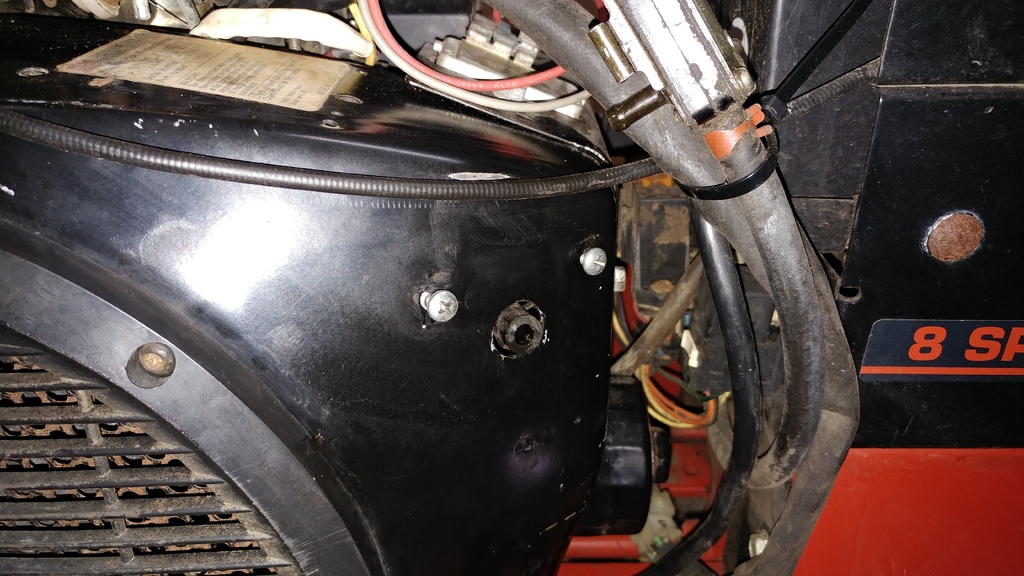

- Next, locate the wire retaining clip at the top of the shroud by the coil and open it up so the oil pressure sensor, stator and ignition module wires can all be removed when taking out the shroud.
- Last step before removing the shroud is to disconnect the throttle to gov arm spring and the throttle cable using  the 5/16" socket and driver.
-Next locate all of the shroud bolts and remove using the 3/8" socket.

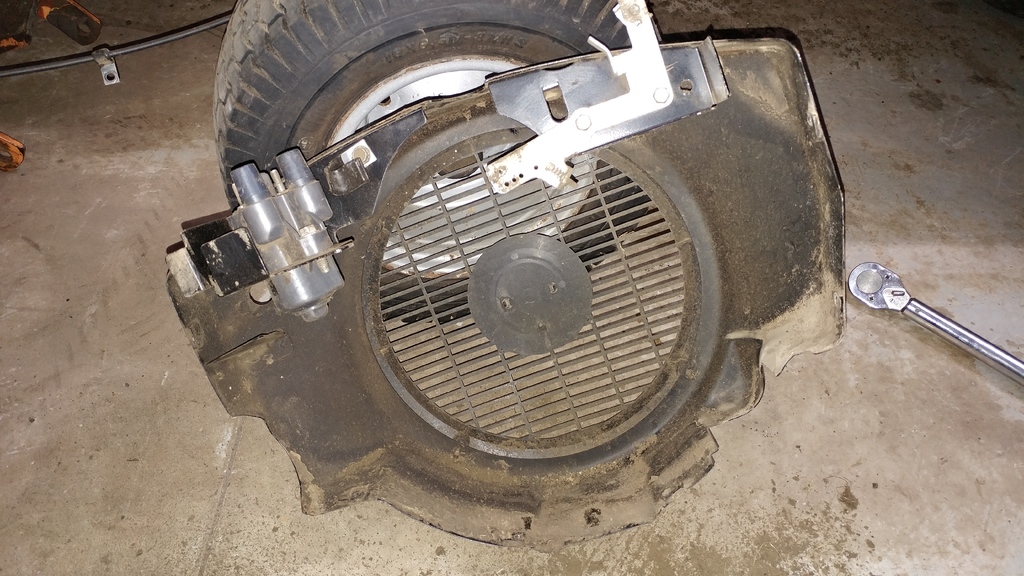

- To remove the shroud, pull the bottom out first and then shift the entire piece upwards while working it from underneath the rear cylinder shroud, underneath the filter box bracket and over the flywheel on the left side. Work slow so you don't bend or brake anything and it will come off pretty easily.
- Although everything was fairly clean in comparison to other engines at this step, my shroud was dirty and this can slightly decrease air flow which is important to maximize and keep optimal with an air cooled engine.
So I took mine outside and pressure washed it to give it time to dry completely before reinstall.
Shroud off...

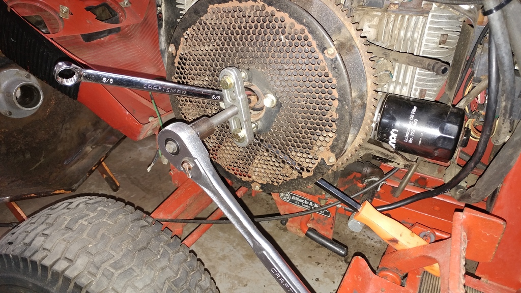

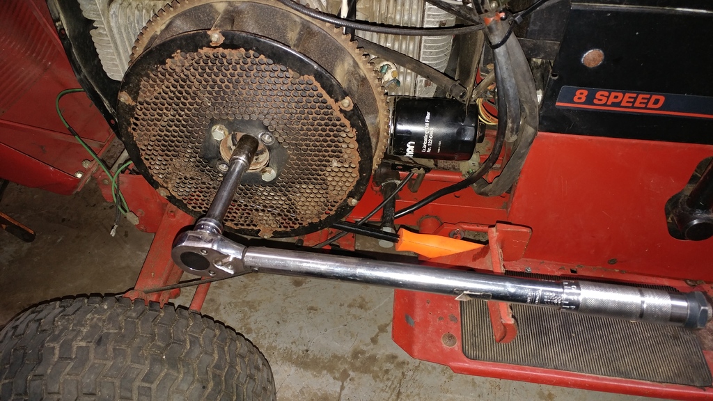

- Next, place the pry bar into the fins of the flywheel and lock the flywheel in place by placing the handle of the pry bar under the foot rest. Then use the 5/8" sock, 1/2" extension and loosen up the flywheel bolt about 3/8" -1/2" out of the hole. This needs to stay mostly in as a pressure point for the puller.
- Next, remove two of the flywheel grill center bolts and then use your two 5/16" grade 8 bolts and attach the puller to the flywheel while keeping the puller parallel to the surface of the flywheel to allow equal pulling pressure on both sides of the puller while cranking on the center pressure bolt on the puller.
- Now it's time to remove the flywheel.  It may be a good idea to use the 5/8" open ended box wrench to stop the flywheel bolt from turning while cranking on the puller center bolt.
- It should only take a 3-5 good cranks after finger tightening the center bolt and the flywheel will give a good pop and be ready to be pulled off. Don't forget about the flywheel bolt first! ;)
- Next, carefully pull the flywheel off of the crank being very careful not to get caught on the stator itself.

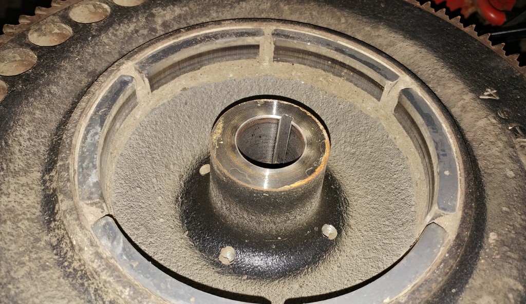

My flywheel was pretty dirty on the inside and between the magnets so I felt it necessary to use the toothbrush and air gun to clean it out.

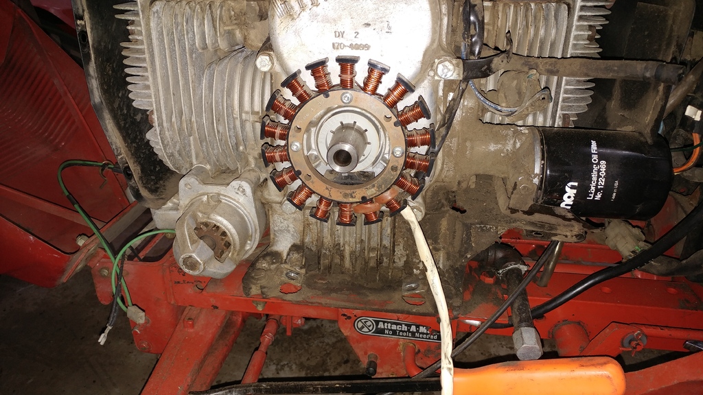

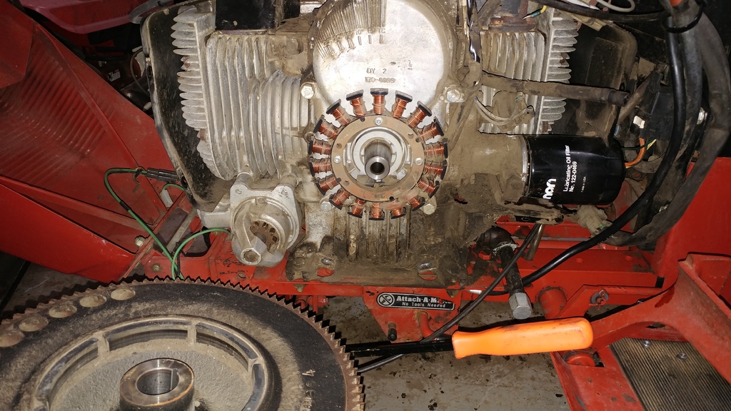

- Now you'll need to remove the stator by using either 5/16" socket or T25 torque bit or driver.
- Next, set the stator off to the side securely on a clean rag or similar. Underneath, you'll see the ignition module on the bottom side of crank. There are two 5/16" head machine screws. Remove those and open the wire retaining clip on the side of the gear cover and the module comes right off. Make sure not to lose the black rectangular insulator that goes between the module and gear cover. That needs to be there.
I'm not 100% sure but I have a theory that these modules may potentially go bad from getting covered with grass and debris over time from not blowing out the air shrouds with a leaf blower or air gun after each use. This debris builds up enough to cause insulation around the module. The module being an IC (Integrated Circuit) is designed to handle only so much heat. Over time the extra heat and expansion with contraction when cooled back down causes a when point in the modules chip circuitry and eventually breaks. Thus causing the engine to shut off during operation for the first time. Once the engine cools, the chip materials contract, allowing the circuit to bridge again only until the engine heats up enough to break that signal and then becomes a cycle until replaced.
- Moving on.. While everything is out, if needed (or your OCD kicks in), clean the cylinder heat syncs and general area before re-installation of the Module, Stator, Flywheel and Shroud. Mine wasn't to bad so I quickly used the toothbrush and air gun to break free any layered gunk and blew it off with air.
-Next, once the insulator, module (and spark ring if chosen to) and stator are all reinstalled and screws all snugged up, carefully put the cleaned flywheel back on, install the flywheel bolt with a tiny tad of anti-seize on it and use the pry bar again in the flywheel fins but with the handle on top of the foot rest and use the 5/8" socket, extension and 1/2" torque wrench set to 55lbs and tighten up the bolt.

      -oil switch  ( don’t think it has any implications other than a visual indication for idiot lights. )
      -seat switch
      ran a pos from batt direct to pos of coil - nothing; no spark.
      Electric is as follows:
      - Starter switch wired to solenoid
      - - solenoid to starter
      - - solenoid to batt
      - one wire from starter switch goes to engine ( I think this is for batt charge / flywheel)
      - I have two yellow wires, which are married up, that go to engine which have constant power; They power coil.  Comes from switch and seat.
      Help - what the heck am I missing ?
    • Rollo416H
      By Rollo416H
      I'm new here, but I have years and miles of dealing with electrical issues with my 1997 416H, engine Onan P216G (I am the only owner) . Problem description: the start circuit turns the starter over fine, but no spark at the plugs or the coil sockets by spark tester.  The ignition trigger tests good by connecting a test light to the coil positive and and the ignition trigger negative lead, plenty of light flash from the test light in unison with the engine turning over. So, I conclude the ignition trigger, replaced 3/18/2021 along with the coil is good.  I have followed the "Demystification" wiring diagram in detail and there is 12V at the coil positive terminal, wiriing is solid (for now), all those damn safety switches, key switch,  and relays work too. I conclude that the coil is bad since the primary side tests 3.1 OHM and the secondary tests infinite OHMS (1. displayed on multimeter).  Two coils (Onan part# 166-0820) have NEW dates of 3/2021 and 8/2021, and yes both have the same test results mentioned. Infinite OHMs to me means the coil windings are broken. The most recent coil came from Onanparts.com and tested as mentioned above when it arrived.  Onanparts won't take anything back!  There are a lot of coils on ebay and various suppliers from China.  Maybe good, maybe bad, who can tell? And most suppliers won't accept returned electrical parts. Please help: What are good test readings for a GOOD coil (primary and secondary). Who do you recommend as a reliable supplier for a new coil?
      Thanks for any help!
      Rollo416H
