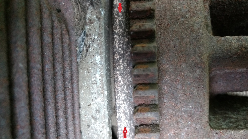

Took of the air shroud and tried looking for the markings. Would this be a T marking, it was the strongest marking I could see.
Tim.0
really hard to tell from the picture..... the T and the S are not far from each other on the fly wheel
  • Like 1

If I remember correctly the timing marks are on this part of the flywheel. I don't see a T.
  • Like 1

Judging solely from the amount of rust in that pic on the flywheel, your timing marks are long gone. The timing was never the problem as it ran before you parked it. First I would have checked for spark. If I didn't have it, checked for 12 volts on the coil with the key on. If present, I would have filed and set points , and recheck for spark at the plug. More than likely there was a coating on the points, or a fuel problem. The timing doesn't get off sitting.

Searcher60 has hit the nail on the head. The timing marks are gone not that you actually need them unless your using a dwell meter and timing light. Its a pretty simple procedure to set a simple set of points. Its not a set of dual points on your 406 Tri-power Ford after all. At .015-.020 it will start and run provided the points and condenser are good as well as the coil and your getting voltage to the coil under crank and run.

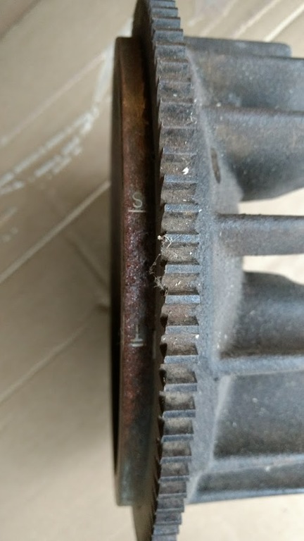

Since there was a lot of talk about the timing marks, here is how to find the approximate location if your flywheel is rusted.
This is where the marks are located, and what they are supposed to look like. This is a K301 flywheel.
So, with the cover off, looking from the front, remove the nut and locate the keyway. Place it at the top (12 o'clock). Your TDC (T) mark will be at 9 o'clock with the (S) mark 5-1/2 to 6 teeth toward the top.
  • Like 3
Interesting info Bob.  I was working on a 10 Hp K241 on a 1075 (has a S/G),  the timing hole is on the rear side of the shroud.  On My 310-8 it is on the front. Apparently when they started putting ring gears on for electric starters they moved the timing marks and the sight hole.  Having them up front near the points makes life a lot easier...

This flywheel is typical of a K-series with Bendix-type starter. Since @Fin_ is working on a K301AS, this should help him locate the marks if they are still there.

Good job on the flywheel pictures. Takes all the guess work out of re-marking the flywheel if someone desires to do so.
