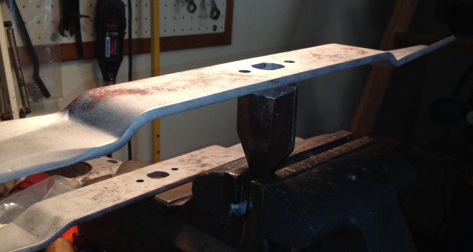

Giff Kucsma
On 4/25/2017 at 6:02 PM, Ed Kennell said:
:text-welcomeconfetti: to the :rs:  Giff.         Clamp a knife edge in a vise and lay the blade center on the edge.      Be careful....don't get cut.
Thanks, Ed.  I don't know why I tend to over-think problems like this.  I didn't have a knife handy but did have an old wide blade chisel that worked as well.
  • Like 1

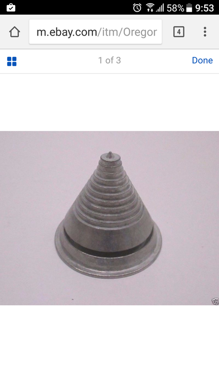

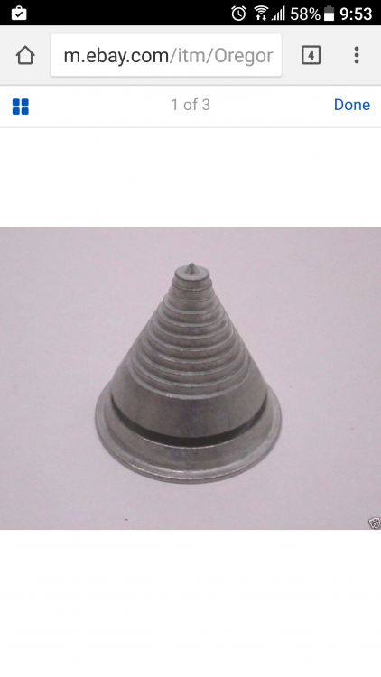

WVHillbilly520H
My dad has had/used one of these aluminum balancers for as long as I can remember and I have used the plastic version with success but have finally got myself an aluminum one, 18 years on my 520 deck and no stress cracks or dad's CC ORIGINAL he's owned since '76-'77, well worth the $7, Jeff.
