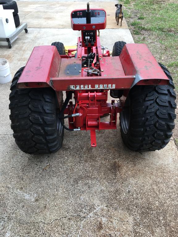

squonk 38,911 #330 Posted May 12, 2018 What's a tractor without a few dents! 2 Share this post Link to post Share on other sites
squonk 38,911 #331 Posted May 12, 2018 I like the looks of that with just a motor, steering wheel, seat and a Rat Fink Shifter! 2 1 Share this post Link to post Share on other sites

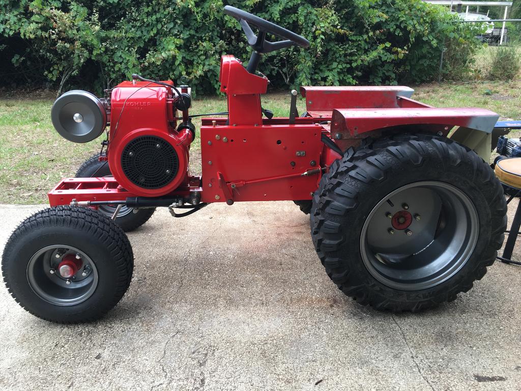

19richie66 16,942 #332 Posted May 12, 2018 Well she’s a little farther along today. Waiting on some muscle to help me set the engine in it. 3 8 Share this post Link to post Share on other sites
19richie66 16,942 #333 Posted May 12, 2018 @squonk that’s as close as I can get. 2 7 1 Share this post Link to post Share on other sites
squonk 38,911 #334 Posted May 12, 2018 Shoulda put the chair in it! 3 Share this post Link to post Share on other sites

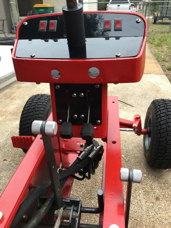

953 nut 51,650 #336 Posted May 12, 2018 Gonna get a few questions about your Eaton from those who haven't been following along! 1 2 Share this post Link to post Share on other sites

19richie66 16,942 #338 Posted May 12, 2018 It wouldn’t fit on the other side with the 3point valve there. Im sorry but I tried. 1 Share this post Link to post Share on other sites
