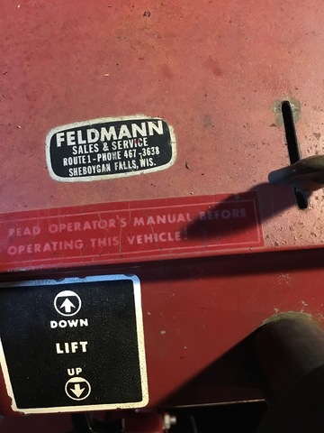

Get us pic of that tag below the dash & try and get that service sticker right below it...just curious as to where horses might have come from in our area.
Here is the sales and service sticker from the B80.  The Charger is outside under a tarp right now.  I will have to get a picture of that tomorrow.

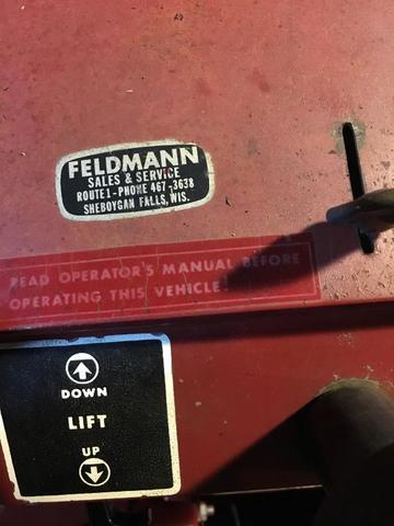

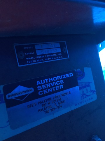

Here is the service tag and ID plate.  It is a 1969 model.  That would mean it has the 1 1/8" axles, correct?
pfrederi
It came with 1-1/8" But after 47 years and multiple owners you better measure.

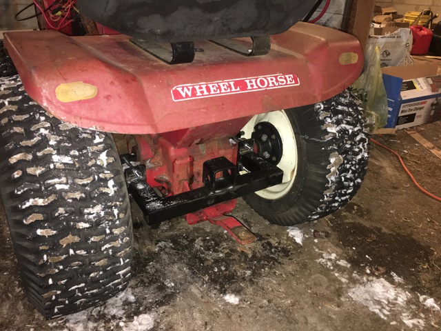

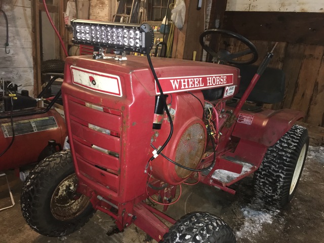

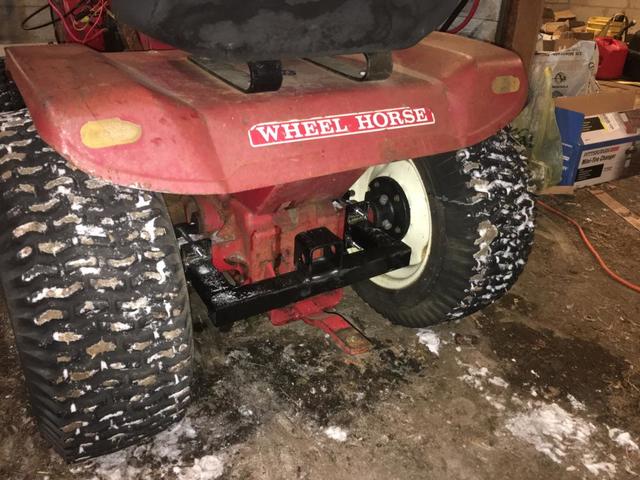

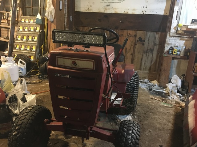

Got the light bar and 2" receiver installed, brake adjusted so that it works, and engine and transmission oil changed on the B80. Now it is good enough to drive around.  Now I can get it out of the workshop and see if I can get the Charger going.

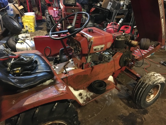

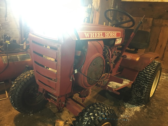

I got a start on the Charger this evening!  After rearranging my workshop to fit a fifth tractor inside it, I managed to get the Charger in.  Unfortunately, I only had enough time left after that to spray some penetrating oil into the cylinder, find out the battery was dead, and pull off the duallies.  The good news is that I now have four six inch wide rims, and that I have three 6-12 ags in very good shape.  The bad news is that the duallies were mounted in more of a decorative fashion.  They were simply bolted on with two carriage bolts per assembly.  No rim spacers or anything! Also, one of the tires had a hole in the sidewall large enough for a cat to crawl through.  One more piece of good news, I have confirmed that it has the 1 1/8" axles!

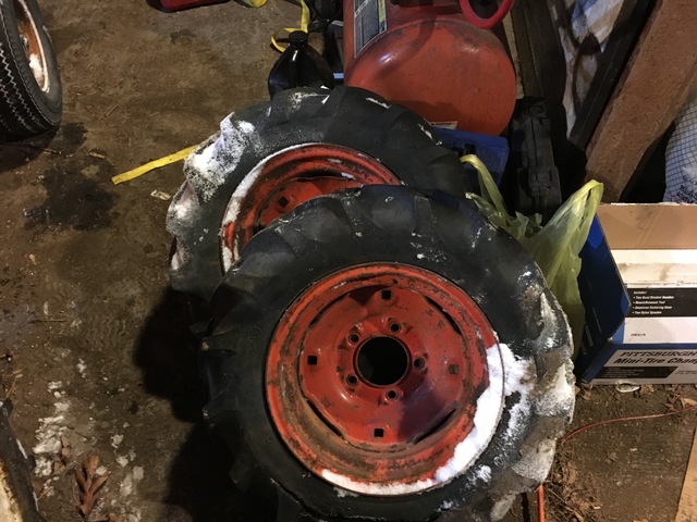

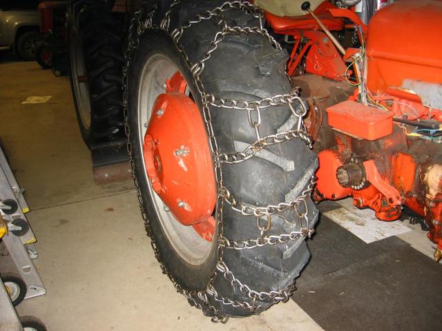

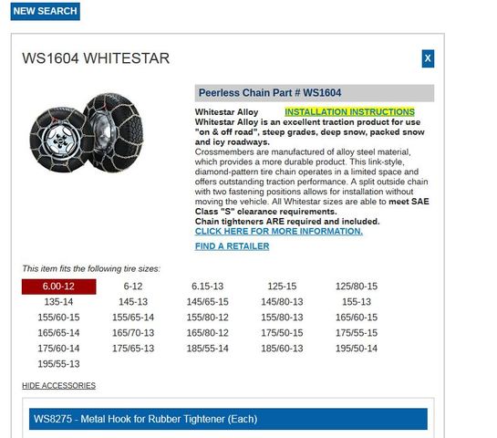

Just found some chains that would go really well on your 6.00x12 AGs.  Add some wheel weights and with your 10 pinion LTD Slip you will have a real snow fighter.  The longitudinal links will keep the cross links from getting drown between the Ag lugs like and be just like theduo-link chains on my Case DC3
Thank you!  Once I get it running and confirm that the transmission is good I will look into those.

You can also look into the Euro style chains , they are similar but use a tight X-pattern to prevent side slip and some are available with welded vees on them .

Did they have them to fit 6.00x12  I couldn't find that.
Sarge
I think you'd have to take some measurements for circumference and width and call them - one of the ATV sizes should work and those are available in double diamond pattern or H pattern - those would be my first choice albeit the price tag . In Europe , those are very common on road graders and heavy equipment in areas that see a lot of snow and heavy duty use , proven to work very well with no clogging .

Deadguy
The Charger runs! To troubleshoot the fuel delivery issue, I pulled the fuel line where it attached to the fuel pump.  Gasoline flowed out, so it was not a clogged fuel line. I next pulled the fuel line where it attached to the carb, and fuel flowed out, so the fuel pump was probably good.  So, then I pulled off the carb and removed the bowl.  Oh my! If was coated with a thick layer of ethanol varnish and sticky brown goo.  The same varnish and goo was present in all the passages and jets in the carb body.  So I scrubbed the bowl out with Seafoam and a rag, and spent a few minutes pumping Seafoam through the jets and passages to get the goo out.  I then put the bowl back on and reinstalled the carb.  It started right up, and I was able to drive it around!  It runs strong, but is a little smoky.  I will Seafoam clean the head and change the oil, and see if that helps.  It will need a new voltage regulator, and new throttle and choke cables, but it runs!
Hard to stop an ol' :wh: .
Congrats.  :clap:

The voltage rectifier is now installed.  I have also Seafoam cleaned the head and changed the oil.  The smoking is down a bit, now it just smokes when starting under choke, and lets out a puff when quickly pulling the throttle out.  Hopefully it will continue to improve.  Tomorrow i change the transmission fluid and filter!
