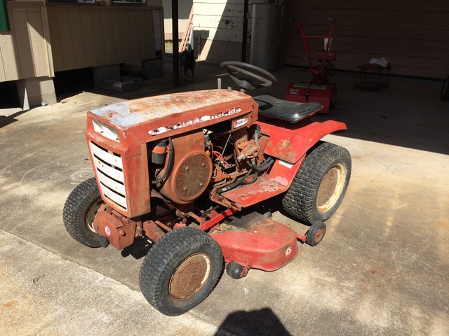

Hacksawhero123
It runs!!!!
953 nut
:woohoo:                    :WRS:                         It is always amazing how durable these old horses are.             :handgestures-thumbupright:

Retierd Wrencher
:WRS:     Mark looks like good worker for you. Get it running and enjoy it. At least it is sun backed not rusted like up here.

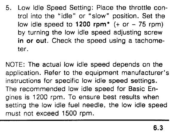

pfrederi
I know a lot of people like the sound of the 16 singles at a low idle...BUT..  these are splash lubricated and Kohler recommend the idle be set at 1200 rpm which is a lot faster than you think.  Cars of that era idled at 500+/-
