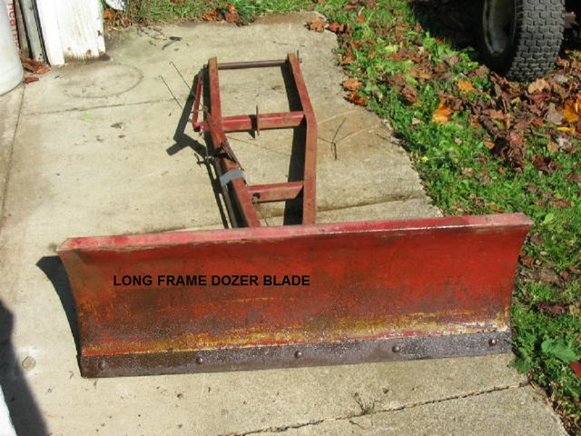

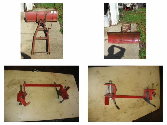

here is a long frame, and a short frame....  get the long frame with either a 42 or 48" blade.
The axle bracket for the C-160 is also shown.
