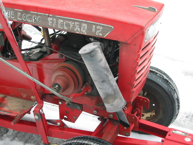

Would like to relocate muffler, does get hot in carb, fuel pump aria after mowing for an hour or so. Have heard some people have had vapor lock issues. I like the look of the factory muffler, but the heat. Don't want a big stack sticking up n the air. I have seen some with the smaller "shower head" mufflers but was wondering about noise (are they louder).  Have also seen a few pic's of newer tractors that looked like the muffler was mounted horizontally above the PTO. I think I even saw one with a small chrome heat shield. Also looks like the air from the engine fan helps to dissipate the heat. Looking for any one that has good pic's of or ideas about this.

Pepper pots and shower head mufflers are very noisy. Actually never experienced vapor lock...
Here is one idea on a 12hp
