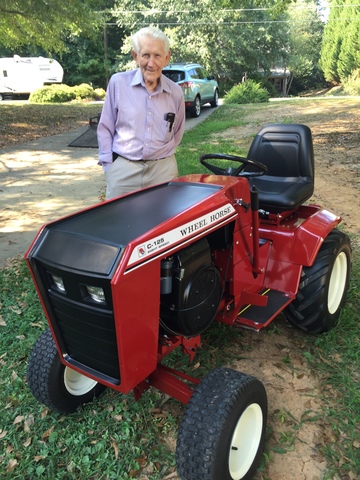

It took time to get to Homer's so he could see the restored machine. Dealing with the elderly and their trips to docs and hospitals. His 88 year old wife, Mary Jo, had double pneumonia. 25% capacity remained and she couldn't get a breath. She's already running around her house and had to come out to see the WH. Tough stock.
Homer admired the C-125 yesterday. Told me the story of his son's hauling it down from St Louis in his pickup bed. They hoisted it out using a tree branch and drove it around the back of the house where it promptly locked up - trans Hi/Lo fork was floating in the oil. Well, fixed that...Homer's happy.
He immediately noticed that generic muffler and suggested we make one like the original so we'll be doing something together soon. Maybe I can get him to give me the one on the C-120 he has out back...  he's not ready to let go of any of his other tractors :unsure:
