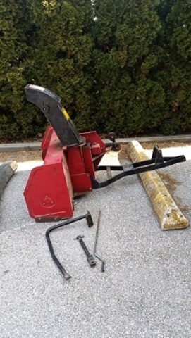

Does anyone have any pictures of how the lift assist springs attach to the Ber-Vac snowthrower on the 520-HC? I know it's past the snow season but I would like to get it done while it's on the tractor so I can remove it to put the deck on and be ready to attach it next year without any delay.

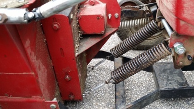

I got it figured out I found a picture on the internet and got a 5/8 x 8 inch galvanized bolt and put two nuts on one end to lock it and attached it to the front quick hitch. Then I got two stainless steel 1/4 inch turnbuckles and S hooks from Lowes to attach the springs to the frame. It works great.    :woohoo:
