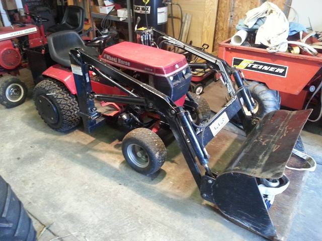

Working/playing with my 310-8 loader Horse.

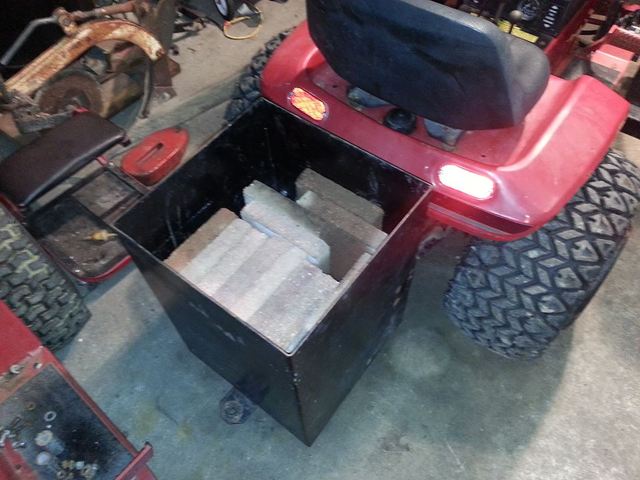

Looks like you are enjoying the 310. Would you please post a photo of your weight box, also how much weight is it?   :text-coolphotos:

slammer302
I love the fact that you have the loader on a 310-8. Its such a great horse sum would opt for a larger higher hp horse but its hard to beat a good running 310
  • Like 3
Here you go Richard, it's about 15"x15", maybe 24" deep & I also have some heavy wheel weights bolted up.
The counterweight box bolts up to the back of the sub frame & the drawbar hitch.
They can be filled with whatever to add weight, I put landscape blocks or paver blocks inside....not sure of the weight that I added.
Yeah it all hangs out the back pretty far, but with other FEL/GT's I've had, they don't work as well without a counterweight.

Wheel-N-It
I really enjoy seeing the loader married up to a 310-8 !!! Looks good!

Rollerman
I will add, that the right "setup" with a loader tractor makes all the difference.
I had an ARK550 on a D250 & I feel it was a better loader than the Kwik-Way,  but the tractor was so horrible & I believe the pump was to weak that my 310-8/Kwik-Way will work circles around it.
(I've had a few FEL/GT's  really...a few were really beat or used up & one I got from Bob Rock was just to pretty to scratch)
The right HYD pump, good lines, good cylinders, secure mounts & the right amount of counterweight.
Yeah that's all obvious, but if one is off....it turns a loader tractor into a not so useful tool that just sits.
