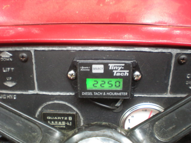

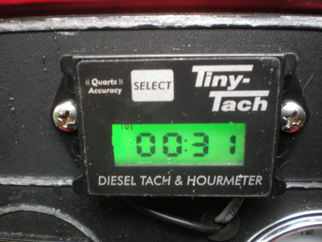

On Sunday I installed a Tiny Tach Diesel Tachometer/Hour Meter on my DC-105. This is the new version that has a flash memory and is connected to tractor's battery instead of the old internal battery with a five year life span. I can now install an ammeter in place of the old hour meter.

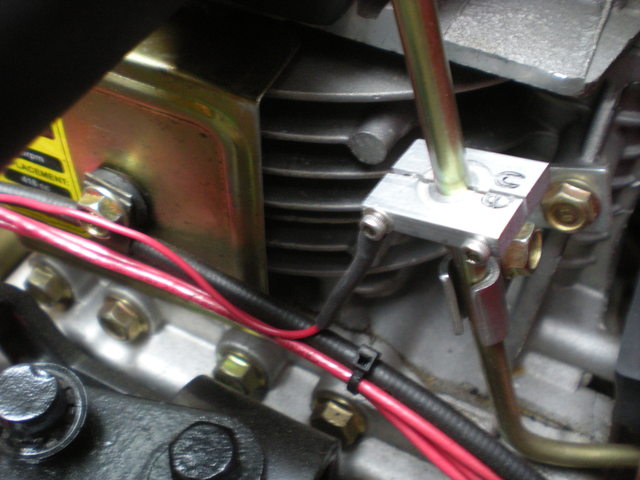

I had originally bought it to install on the 523Dxi but realized that the Carol Stream 10 hp diesel uses an injector pump as well. The inducer (6 mm size) is installed on a straight portion of the fuel line. Because I am still breaking the engine in, I was curious as to the rpm I have been using. The manual recommends to not run at high rpm until twenty hours of use. It has 6-1/2 hrs on the engine so far. Because it counts the pulses with the transducer, I can't add the other six hours like a gas version hour meter though. While breaking the engine in, I try to make three passes up and down my street which take approximately 1/2 hour! Pretty boring at this point and wish there was a youngster around to do it. My dog has trouble with the clutch and can only manage a hydro. :ychain:
