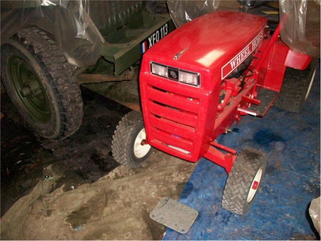

wheeledhorseman

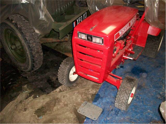

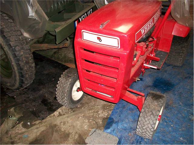

Thanks James - Mark and Richard added these to tractors a while back so nothing new here. Despite the LEDs being much brighter I've actually kept to original spec for my C-120 and the headlamps I added to the C-100, it's a necessity here as the tecky alternator wasn't designed to power headlamps but this project is a kind of custom so I'm not sticking to factory.
Here's the before and after.
post-4509-0-63347200-1393525474_thumb.jp
post-4509-0-97887900-1393525490_thumb.jp
In a way I should perhaps have kept the blanking plate as its rare to have one in pretty good condition but I'm really chuffed with the way the tractor looks now as my original aim was to mould it into a kind of miniaturised C series here and there.
I included the wiring for front and rear lights in the loom I made but haven't connected the headlights yet - saving that for a nice day when I can work outside in warm sunshine, yeah like that's gonna happen soon!

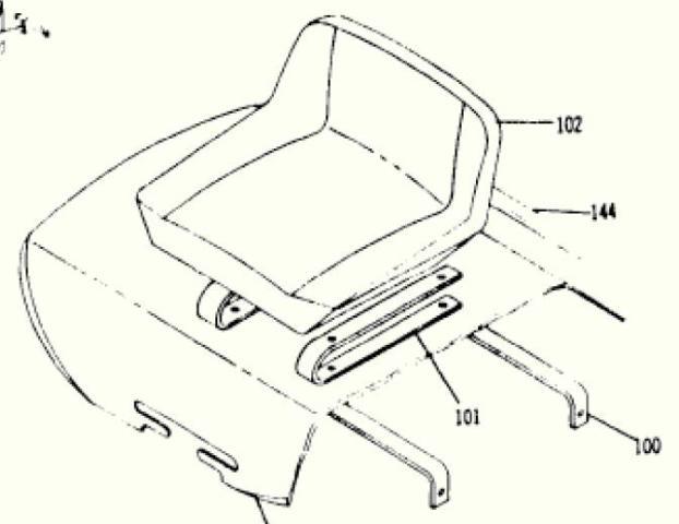

The second issue that's been puzzling me is the rear fender arrangement. The standard C series fender is too wide for the tractor and looks out of proportion with everything else. It also has central cutout which is of course not symmetrical with the centre line as on a C it has to take into account the belt guard and creates a large opening through which the gear shift protrudes. All very strange and hardly what you'd expect from the WH design team.
Although the diagram in the manual is an artist's impression rather than accurately drawn, it does show two things, first that there was to be a 'gate' cut out for the gear shift and second that it doesn't much look like a C series fender.

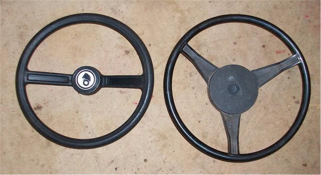

Another 'cheap' option for the A-800 in Europe was a rigid plastic steering wheel (albeit made by Kelch) more akin to something you'd find on a child's pedal car IMO. So I've cleaned up a soft touch wheel from a B-165 I parted out which is the same as the early C series.
post-4509-0-27355200-1364853571_thumb.jp
Spot the difference? Chalk and cheese I'd say and I think from Hammerhead's example that they used the soft touch wheel in the US model.

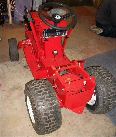

So here's where the project has got to as of today's work.
post-4509-0-81956200-1364854450_thumb.jp
Remanufactured a suitable choke cable using the throttle cable from a 200 series parted last year so the POs adaption i.e. manually operated from the side of the engine has gone. Steering wheel looks good I think.

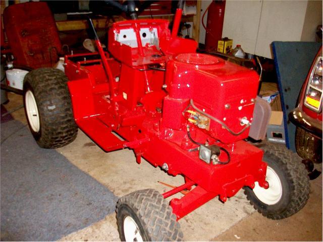

Engine tin is back though Garry's manual indicates that the HT lead should run inside the tinwork - I was wondering why there was a hole above the spark plug, now I know.
post-4509-0-05668300-1364854796_thumb.jp
It's coming on but there's still lots to do. You're right about paint and the cold temperatures Richard - I've been struggling and the finish is unlikely to be as good as I'd like but if I leave it till it warms up a bit I'll have little time to work on the project. The hood is painted and hardening off - a slow process given the temperatures but when I can fit the hood I'll be much maore able to judge what to do with the fender to make it look more in keeping. Ian (Stigian) always makes his steel 'nip and tuck' surgery look so simple - I suspect I'm going to find it the greatest challenge of the project.
