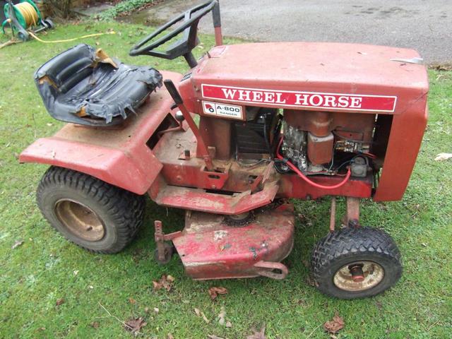

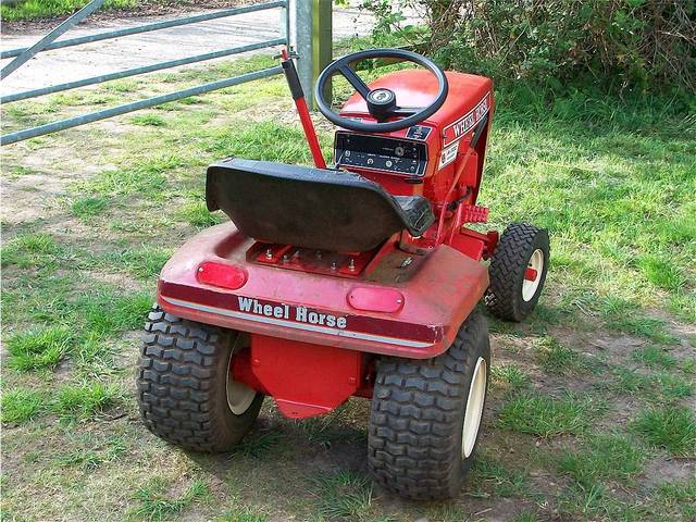

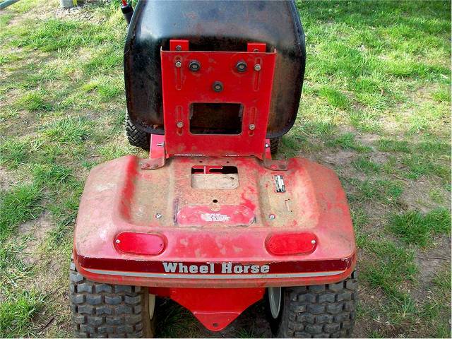

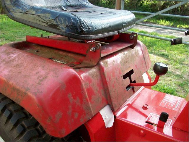

With its non-adjustable seat mounted directly on a standard fender, the original layout made it a bit of a 'low rider' which to my mind detracted from the overall tractor appearance though I guess the intention was that larger guys would fit between seat and steering wheel. With the height of the 210 fender set (using wood mounting at this development stage) to achieve the right sort of clearance over the wheels the seat height was always going to be higher as a result which led to much experimentation to achieve a balance between overall look and ability to sit on it to drive (kind of important).
post-4509-0-47845300-1367956520_thumb.jp

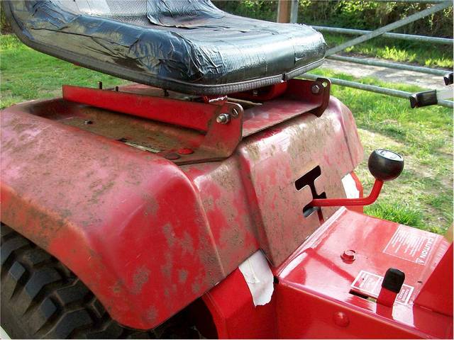

After a frantic search I managed to locate the seat fittings from the 210. The hinged mount originally had the large coils springs at the rear like the 300 / 400 series but these were quickly discounted from the equation as the seat was too high to be practical and the look was wrong for what I'm hoping to achieve. Instead rubber buffers were used to provide clearance for bolt heads but the front hinge mountings had to be redrilled to suit.
post-4509-0-07052800-1367957100_thumb.jp
The seat then has become adjustable and it is possible to sit reasonably comfortably to drive the tractor.
post-4509-0-94298200-1367957271_thumb.jp
The hinge brackets will need trimming down to restore the normal contour based on the new hole position but I thought I'd save that just in case things still need altering although in a way the development reached the point of no return when the gate for the gear shift was cut out. A very long and tedious task trying to work on such an ungainly object - I can see now why these were usually cut into a small flat panel which bolted on separately.
post-4509-0-96652100-1367957685_thumb.jp

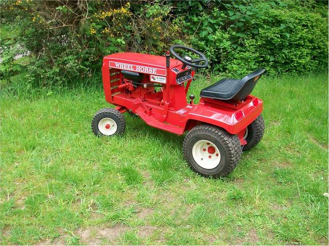

I do believe it's beginning to look like the little tractor I wanted to achieve from the potential I saw in it in the first place from the vendor's photo on 'teatray'.
post-4509-0-67112800-1367957984_thumb.jp

Yep ! , the back end is looking much more 'In proportion' as a result of your changes Andy :thumbs: . Are you re-covering the Old Seat Shell in the pics or do you have a replacement?.
Stigian
Congrats Andy on moving on from "Resto" to slight "custom", the fender pan looks right at home on there now.. Nice job on cutting out the shifter gate, I bet that was fun to do.

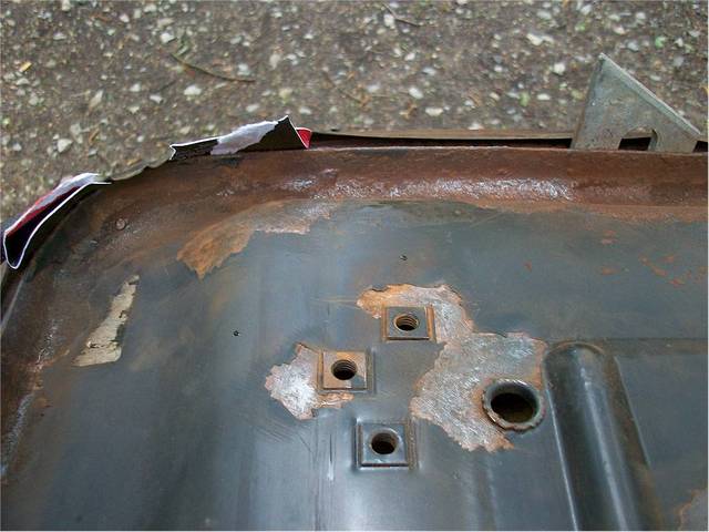

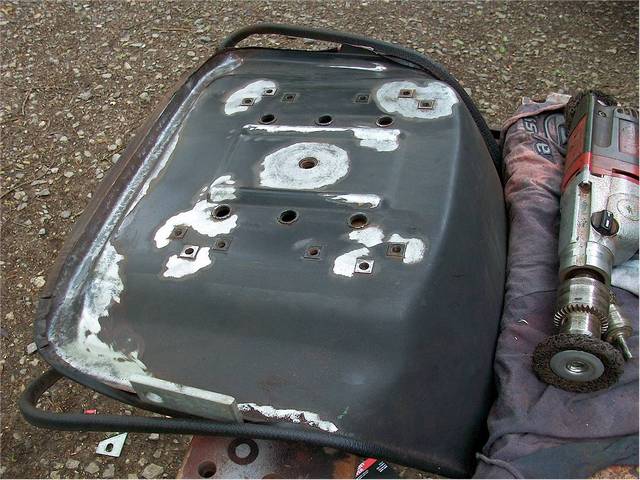

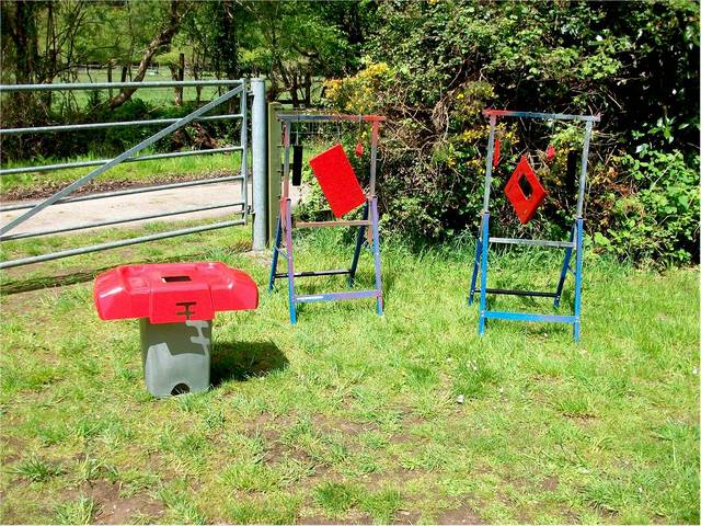

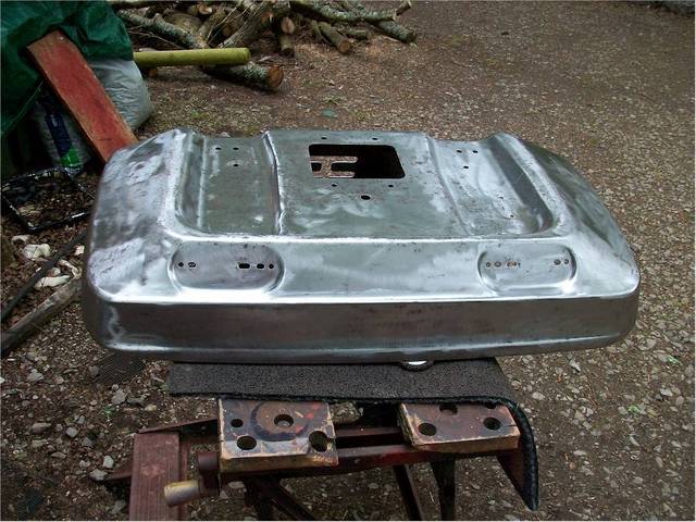

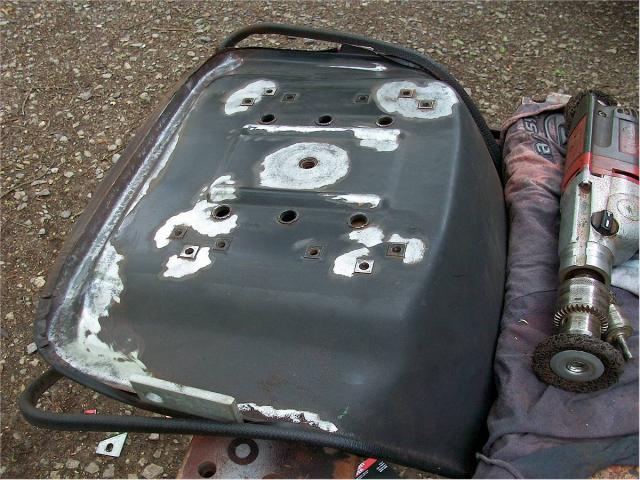

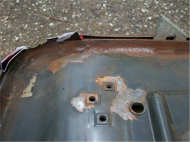

It has surprised me just how many hours have had to go into the fender part of this project but I can finally see what the finished tractor is going to come out like.

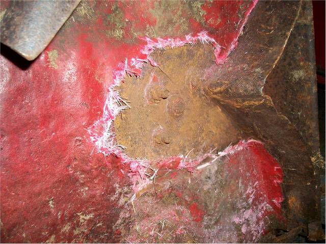

The modified fender pan was quite rusty in amongst the faded red paint and there were some obsolete holes to weld over but it came back to bright metal ok.
post-4509-0-41818400-1368997035_thumb.jp
I did leave a couple of obsolete holes for 'authenticity' as you seem to always get one or two of these for some appendage that wasn't fitted to your model. I'd remembered the seat from the 210-4 as being in generally good condition when it was put on the D-200 but it's amazing just how much rust can lurk beneath the paint used on these which was a kind of plasticote I guess and holds firm whilst the rust travels along underneath it.
post-4509-0-03437300-1368997459_thumb.jp
I've taken to using a 'Paint & Rust Remover' wheel by Oakey which is a strange composite but way more effective than wire wheel / abrasive flap wheel etc. and which digs out pitting well. Not quite as good as shot blasting but closer than anything else I've tried.
post-4509-0-30035100-1368997728_thumb.jp
Foretunately the rust was confined to the under seat area so the back can remain original for now.

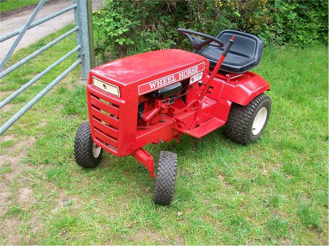

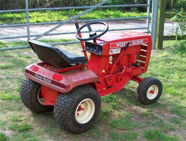

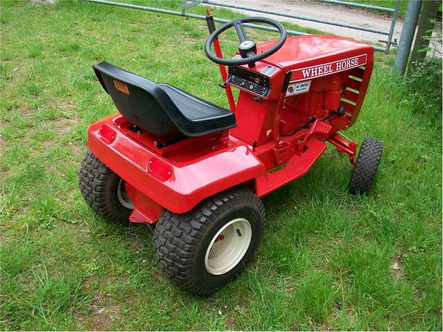

So finally the point of reassembly was reached and a good idea of what the finished tractor is going to look like.
post-4509-0-38455100-1368999084_thumb.jp
post-4509-0-71864500-1368999115_thumb.jp
post-4509-0-88241100-1368999598_thumb.jp
post-4509-0-70901800-1368999617_thumb.jp
I've deliberately not photographed it along side a 'C' yet - will save that for the next update!

Looking fab Andy, you would never know its not the original fender!
Stigian
Your almost there now Andy, it looks like it should of come from the factory with that fender fitted.. Nice work :handgestures-thumbup:

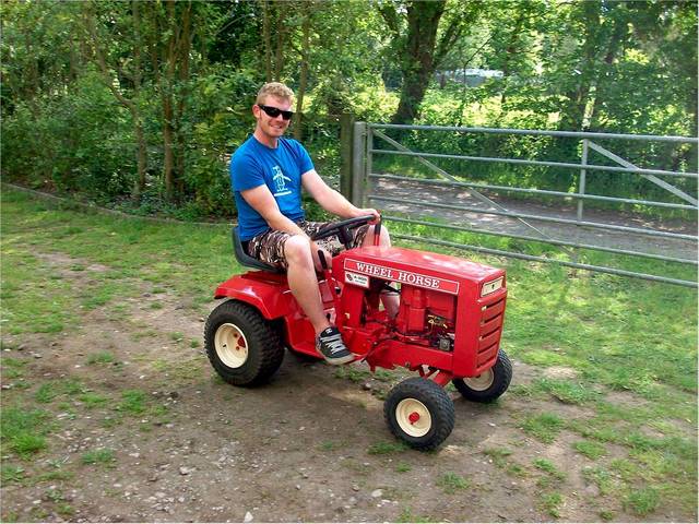

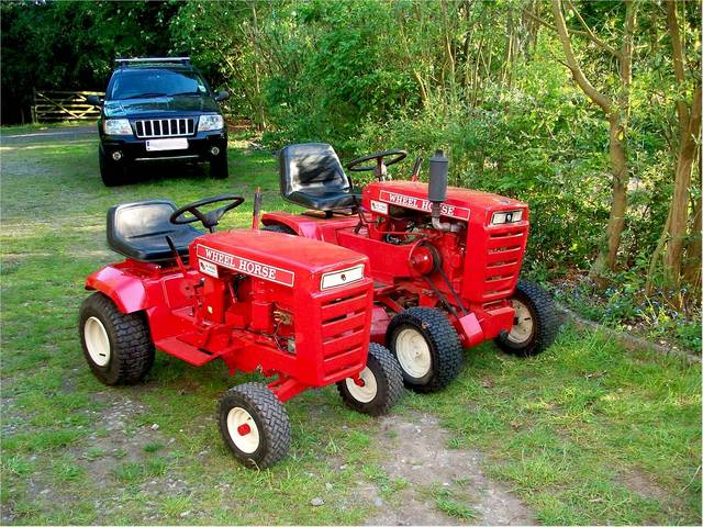

So after a further delay fixing that it was fired up for the first time today and here it is standing beside the C-120.
post-4509-0-50652500-1370204943_thumb.jp
Being closer to the camera it doesn't look as small as it really is but the front wheels are a clue to this I think. Hmm, how can I give a better idea other than an aerial shot........ I know, put my son on it which wasn't difficult as he wanted a go anyway.
post-4509-0-92275400-1370205142_thumb.jp
Ok, he's 28 and six foot and a bit tall but it is a small tractor, trust me. The clutch is a bit fierce at the moment with a new drive belt and pulleys that have been derusted and havent obtained the polished surface yet so when I first rode it I managed to pull an impressive wheelie without trying, it being pretty light at the front with bags of torque.

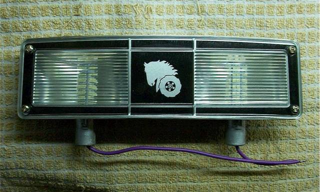

Well, managed to pick up a headlamp assembly during the autumn, I have a couple of circuit designs in my head to try out on the charging system, and tonight I 'won' an A-800 deck in way better condition than mine on the bay.

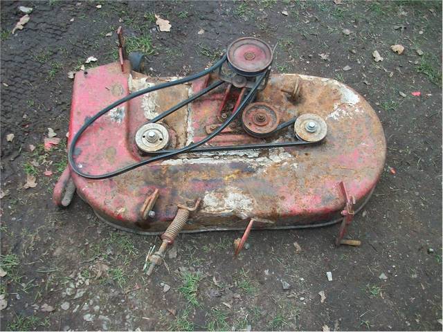

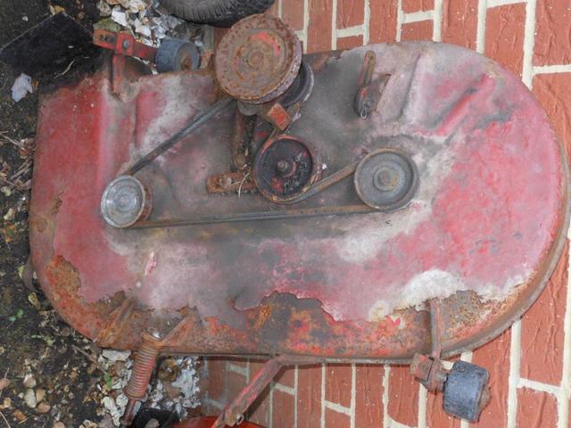

Here's the one that came with the tractor which I was assured did still cut grass.
post-4509-0-81642600-1391990909_thumb.jp

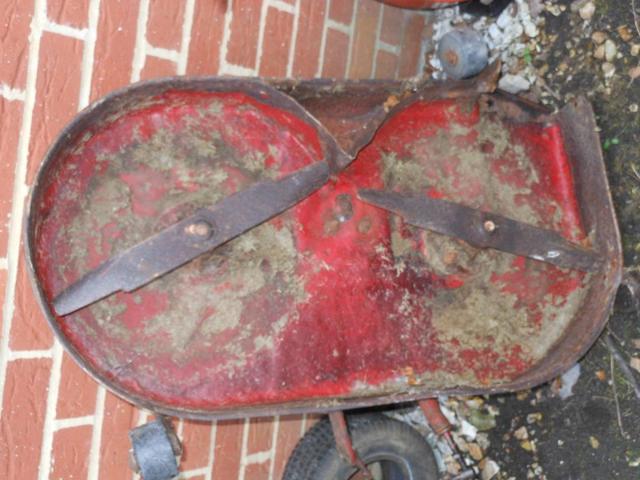

There's more plating on this deck shell than I've ever seen before - the remains of the original are held together with a large plate on the underside to which the spindle housings and main drive pulley are also mounted. There's also much use of filler and some of the plating round the sides has rotted through.
It was going to be a very time consuming undertaking to attempt to fabricate  a new shell that would look something resembling the original. Patience is a virtue they say and this is the deck I'll be picking up during the week.
post-4509-0-74808400-1391991256_thumb.jp
post-4509-0-02287100-1391991286_thumb.jp
Not perfect but pretty good for its age I think. The bearings etc are good on the one I have as it was used regularly to cut grass and some parts like pulleys have been replaced so between the two I'm hopeful of putting together a nice looking functional deck now.

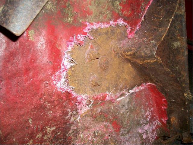

Started up the genny but its a little thing we take camping ok for a bit of lighting and small power tools but that's it so out came the deck. There's no play in the bearings and they feel ok when turning the blades but experience  says until they're spinning at speed for a while you can't tell for sure but it's a good start.
post-4509-0-09301300-1392250277_thumb.jp
Although whoever did this didn't do a good job of cleaning the rust completely back the resin had bonded securely too it and it had to be prized up and broken off a bit by bit but so far so good. It's bone dry underneath so the shell, what ever condition it's in elsewhere, has been held in a time capsule ever since.
My guess is that it was done when the first rot holes appeared so maybe there won't be too much to sort out. Round the sides of the shell the fibreglass got pretty much destroyed by stones over time but the rest is pretty impregnable so maybe it's a good way to preserve if properly derusted and treated first. Whoever did this work went to the trouble of putting red pigment in the resin, another good idea perhaps.

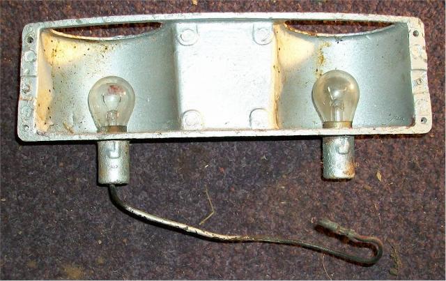

Various parts arrived this week from various locations resulting in some distractions from my main project of the moment i.e. restoring two dump carts.
As a result the 316 has rear light lenses at last and the second D-200 has the correct rear lights rather than the fog guard units fitted by a PO. The headlamp lens arrived for this project (cost an arm and a leg) so refurbing the bucket housing I picked up on the bay became a further distraction.
These things can look pretty grotty having been daubed by POs.
post-4509-0-86529100-1393113464_thumb.jp
Under the silver paint was a really thick layer of white hammerite, the old formulation, which took a lot of soaking in paint stripper to remove. Paint strippers like 'Nitromors' no longer contain dichloromethane which has been banned by EU legislation which doesn't help and the new formulation is pretty poor by comparison. Having removed all the paint and then the greyish oxidised layer that appears on diecast metal over time using wire wool, the reflective surface was sprayed with chrome effect paint then LED bulbs fitted.
post-4509-0-56188500-1393113990_thumb.jp

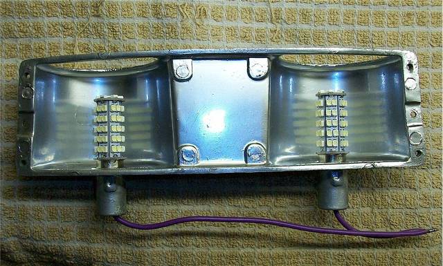

As Richard (Anglotraction) mentioned, the low current requirements of LED are essential for the A-800 as the Tecky engine only has a 3 amp alternator to charge the battery but not designed to run headlamps.
post-4509-0-47011700-1393113897_thumb.jp
The screws aren't OEM I know but this is a custom of sorts anyway and it was hard enough to find screws in my collection of odds and ends with the right thread on them.

Looking good Andy :handgestures-thumbupleft: . If your sticking with SMD LED Bulbs, are you covering the Vents up ?.
I did it in order to reduce the moisture ingress on the exposed bulb PC boards, as well as improve the reflecting power.
Those Lense Screw sizes feature a lot in CPU Cabinets and many PC hardware units.
wheeledhorseman
Correct as always Richard :techie-eureka: - the screws were from my jam jar of computer screws amassed over years of putting PCs together.
Also the top vents do need sealing to keep dust, spiders, and moisture out. For the moment if I do get to fit the headlamps later today I'll use bolts rather than rivets so the unit can be removed again and tape over the vents as a temporary measure.
The design of the headlamp assembly has always struck me as being wrong in terms of the parabolic reflector being suited to a bulb with a vertical filament rather than the horizontal filament of a standard 21 watt bulb. Paradoxically, it is suited to SMD LED bulbs though light from the LED elements that face upwards is of course wasted.
Rather than simply block the vent off and silver it which would trap the light but not really project it forwards my first thoughts were of experimenting with using plastic cut from of a car rear light lens with the little prism shapes moulded into it. However, today when I was removing the fog guard lamps from the D-200 the internal chromed plastic reflectors gave me another idea.
Maybe if I cut a section of the mirror out and glue it on a plastic vent cover at the correct angle then light from the top elements of the SMD LED bulb can be projected forward effectively. Just an idea at this stage that will need some experimenting with to get the angles right.
Andy.
meadowfield
Nice work Andy, same led bulbs as we use. I never thought to block the vents and I've never looked inside after 3 years....

      Operator manual #810661R1
      Part 1 - 3 pages 4.39MB
      Part 2 - 4 pages 3.59MB
      Dated 06/89
      Fits some 200-Series lawn tractors
      Power grass collector 07-31PS01 available for this deck.
      This is a better copy than the one that can be downloaded from Toro.
      See product service bulletin "WH89-90 #T28 216-H 30in Mower Belt"
      Mower 35-30SL01 serial # 20987 and lower requires longer belt # 114421 if used on a 216-H tractor
      Mower Rotary 1990 30in SD model 35-30SL01
      1990 serial numbers that have shown up for the 35-30SL01
      0020987 - Shown in PSB #T-28
      0022777 - Build date 1990 0005 January 05 Friday
      0023367 - Build date 1990 0078 March 19 Monday
      0023422 - Build date 1990 0078 March 19 Monday
      0023423 - Build date 1990 0078 March 19 Monday
