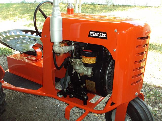

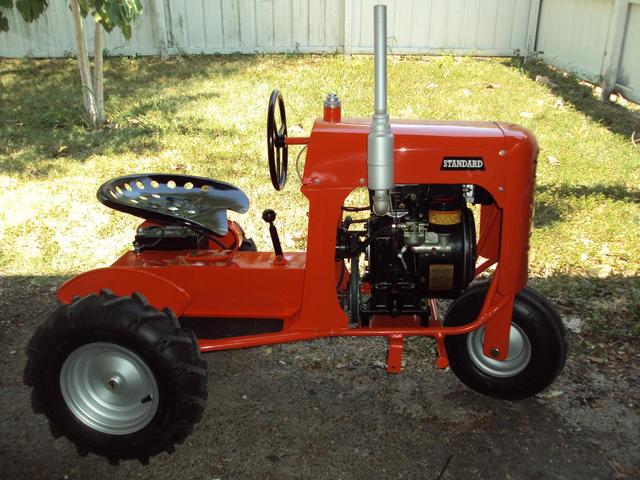

Heres mine (IH-1 Tsc Faemall Cub Muffler) dont forget the rain cap lol.
post-8378-0-55049000-1348423106_thumb.jp
kpthorsefan
There is no model or make its home made... :hide:
MR49
That is sweet! Good work :thumbs2:

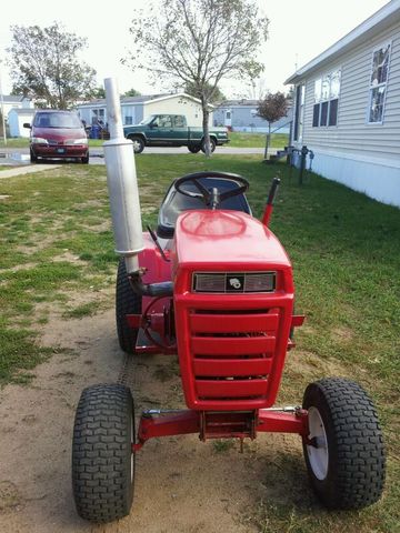

Stacks rock! Here's my C-121 with a tsc ac-1 or a ac-4, can't remember which I decided on. Either way it's for a Massy Fergy Son.
post-6649-0-20688300-1348437211_thumb.jp

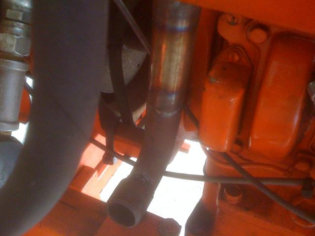

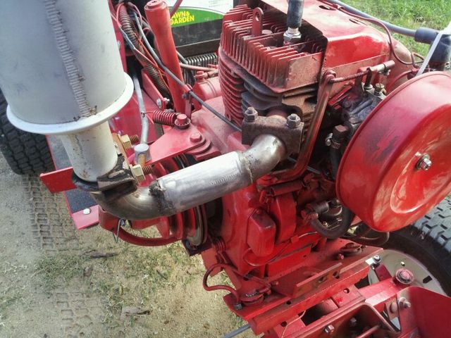

I cut the 90 off the old muffler and used it for the stack, but the hood would hit it while opening. Had a local shop extend it for me and left it to color naturally. Kinda ruff, but it's a worker.
I have no idea why the first pic is on twice.

Fellas keep in mind that there is a lot of weight on the 1" pipe that is threaded into the cast iron block!
An additional bracket to the frame will decrease the possibilities of having to replace a broken/cracked block, or re-threading it.
roscoemi
If I decide to add a brace, it will be to the motor to stay in sync motion wise and not the frame.
Thanks for the mount pict too Roscoe. :thanks:

The stack is pretty light, compared to the stock muffler with a busted bracket. The pipe stub out of the motor is pretty stout and I really don't want to clutter it up with a bracket. After the snow season I'll have a one piece pipe bent to go from the muffler to the stub to clean up the look of it.

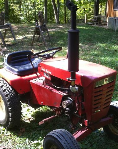

i personaly don't like stacks on my tractors. at my place there are too many trees to snap back into your face! that said i do have one with a stack. a charger v8, the stack was on it when i bought it at the 2004 big show. it's just 1in. galvenized pipe nipples & elbows with a tsc. flapper on it. the boy driving loves "his" tractor sounds great. but if i ever restore this horse about 5 years ago i bought a N.O.S. nelson muffler for it i think i paid $40 for it Jay

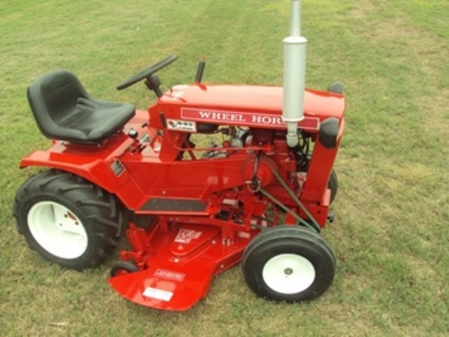

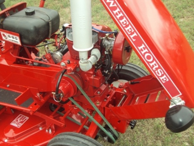

Here are mine. My B-80 with a tsc muffler, and my son Danny's Bantam with one I made out of a Briggs hot dog muffler. :thumbs:
Matt :flags-texas:

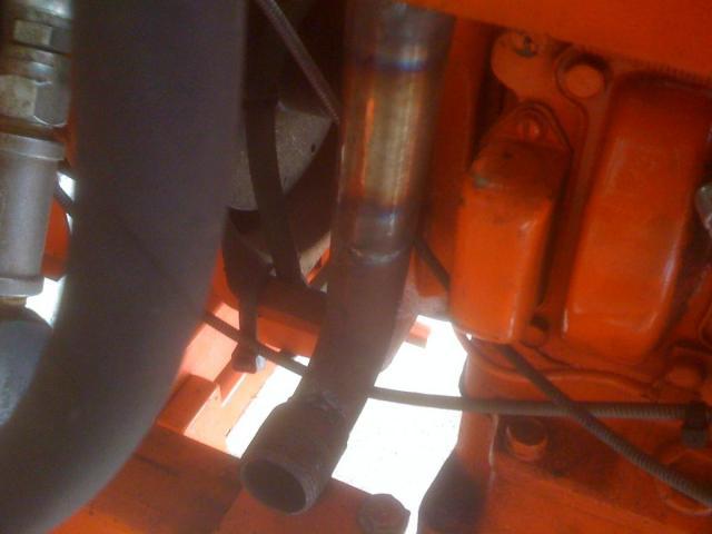

Maybe you guys chould include a close up pict that shows how you fabbed up your mount too. :scratchead:
Not the best picture but its raining heavy outside, so had to take picture in the workshop and not alot of room.

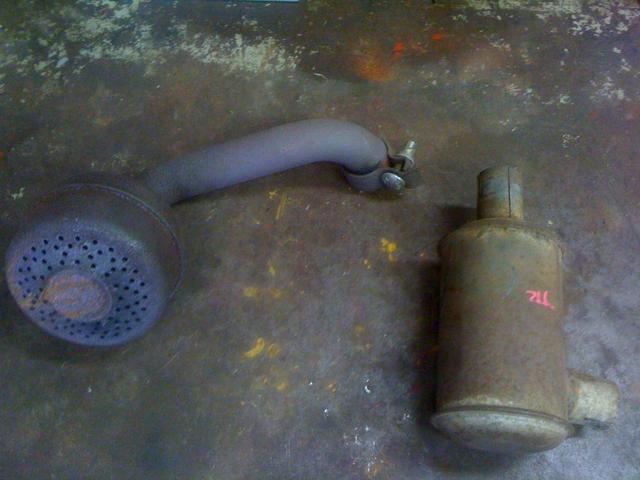

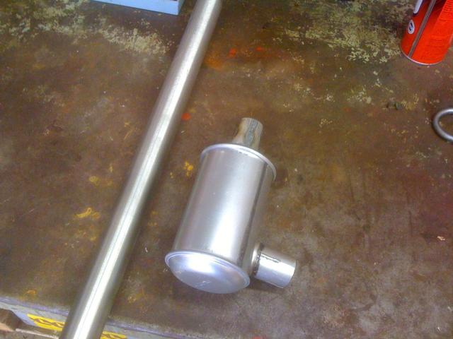

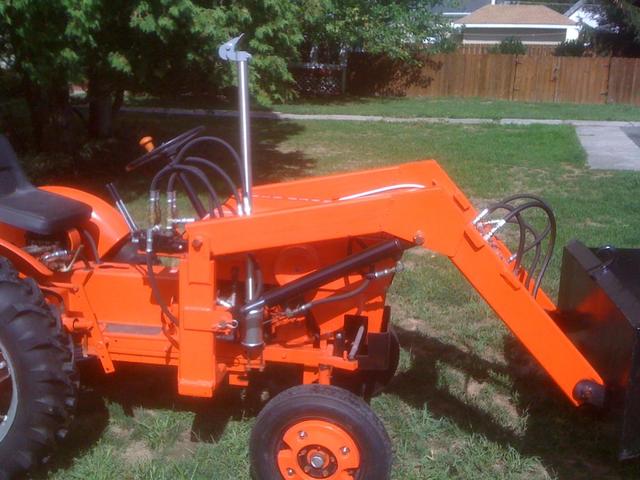

Off brand stack. Power King 2414. Came with a pepper pot that blew exhaust all over my loader hoses. Extended the pipe with some scrap chrome moly, used a Gravely rear engine muffler from Napa, raincap from TSC and a stainless Handicap bathroom bar from a dumpster at work. :thumbs:

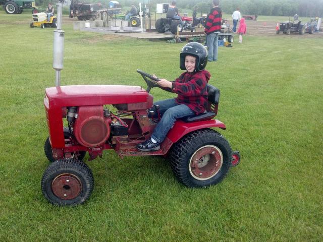

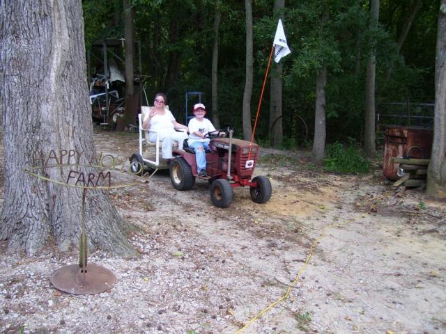

My Son on the puller, TSC Cub muffler with a rain cap. The elbow is a piece of tubing I had laying around can't remember where it came from...maybe an old MTD or something
