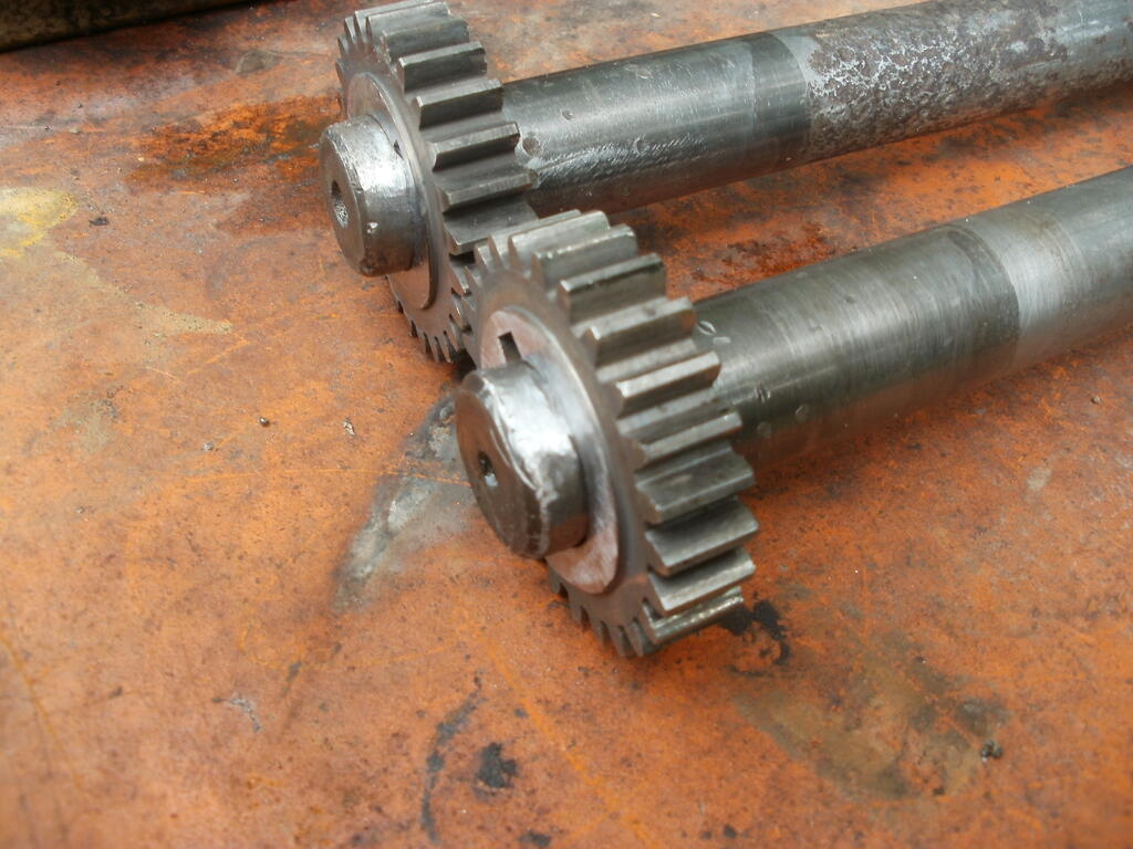

UNBOUND

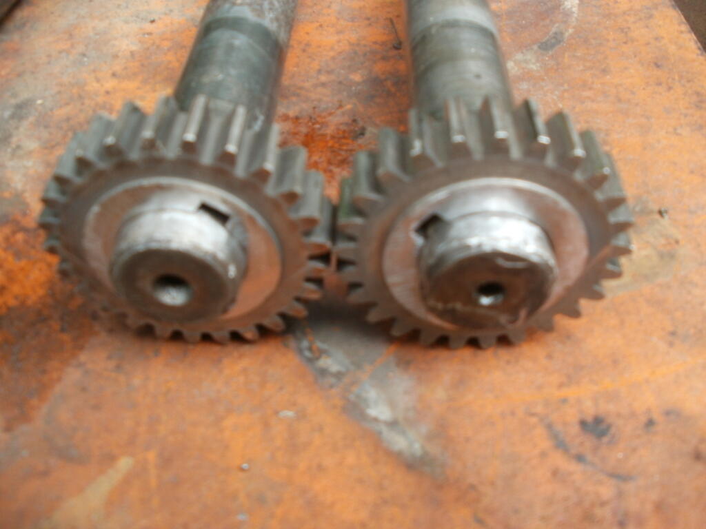

Got the gears today from Jake. Now need to find someone to weld them on.
  • Like 3
  • Thanks 1
stevasaurus
That looks fantastic !!!  :USA:  A plan comes together.

UNBOUND
Got the gears welded today and diff put back together. Waiting for the trans gasket to get here. The vender I ordered it from was showing several in stock but couldnt locate them. Ordered from another vender, but will be a few days.
  • Thanks 1
stevasaurus
Do you have any picks to show us??  :occasion-xmas:
UNBOUND
I didnt take pics of the welds, but were good. The diff is sitting in trans waiting for gasket so I can put other half of trans on. When I turn one axle the other goes in opposite direction.

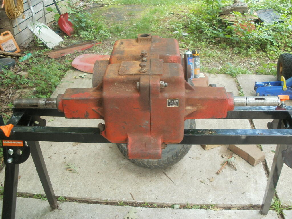

UNBOUND
Got the gasket today. ready to go back in.
  • Thanks 1
stevasaurus
WOW!!  I wasn't sure we could save this one as easily as we (you) did.  There is some great information in this thread on this particular transaxle.  Excellent work there @UNBOUND, you should have another 60+ years to enjoy that horse.  It was a pleasure working with you...this is what it is all about!!  :USA:

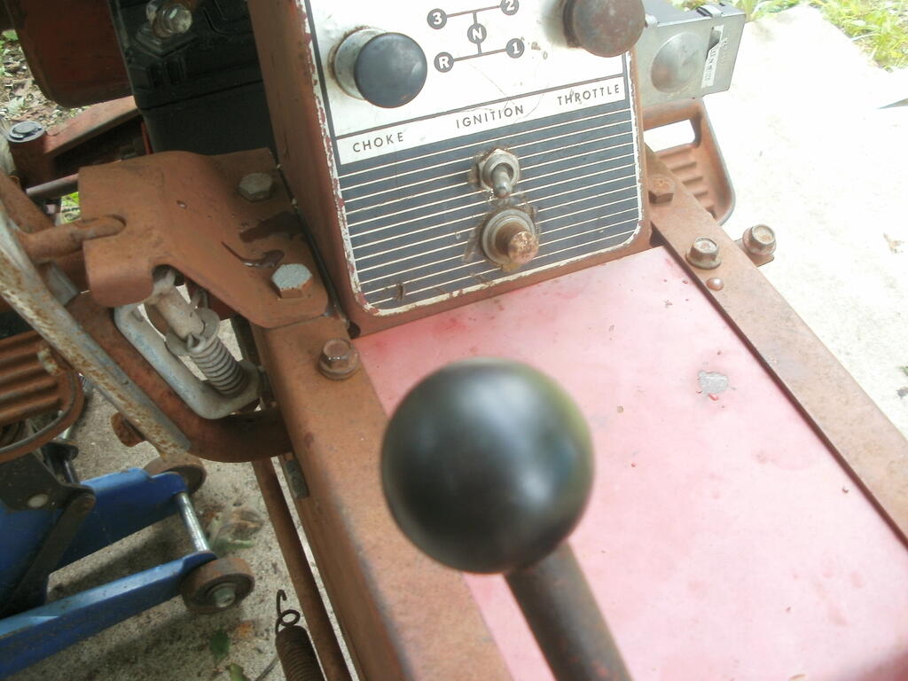

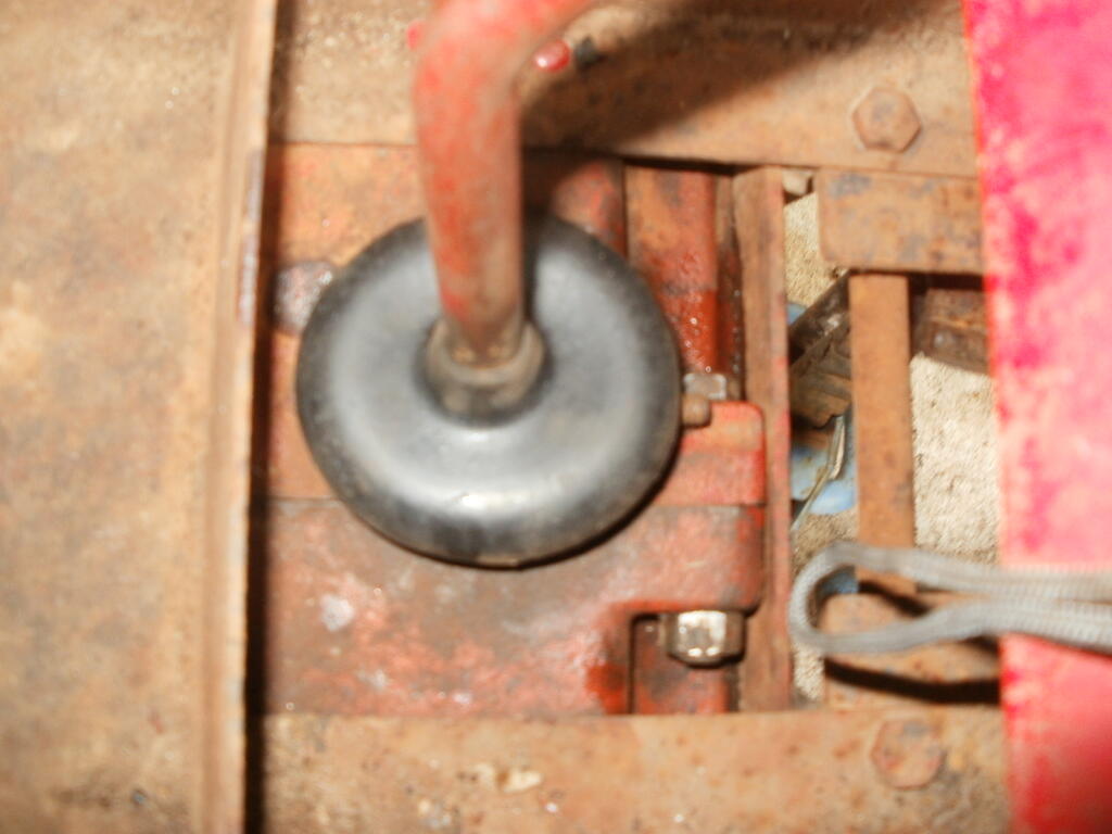

UNBOUND
Its in. I am rounding third and headed for home, I am third and goal on the one yard line. Got my new shifter boot and shift knob. Can anyone see what aint right about the dash?
  • Thanks 1
UNBOUND
It moves in every gear and no odd noises. I would like to thank all of those who participated in helping me get her going . Stevasaurus for finding me the gears I needed and all his wisdom.

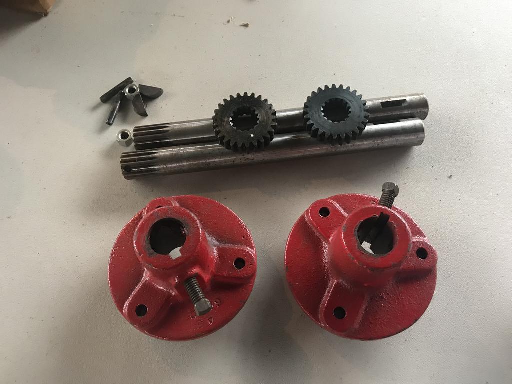

UNBOUND
Just for reference, Wheel Horse made a kit to get rid of the welded gears. P/N 7168. The hubs are probably common as well as the gears but the axles maybe not.
