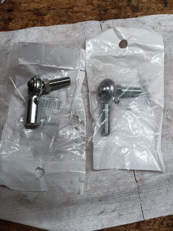

ebinmaine
Here's a pic of the two that we use.
Note that one is female and the other male. I purchased these as I said above from McMaster-Carr for maybe $10 to $12 a piece.
If you bought the ones with female Inlet sides and purchased a piece of threaded rod the correct size, you could use the right length threaded rod as your cross piece between the two. The Tie Rod Tube itself.
If you are a family member has access to someone with a metal lathe and threading tools you could have them make up your Center tubes. That's what I've done in the past.

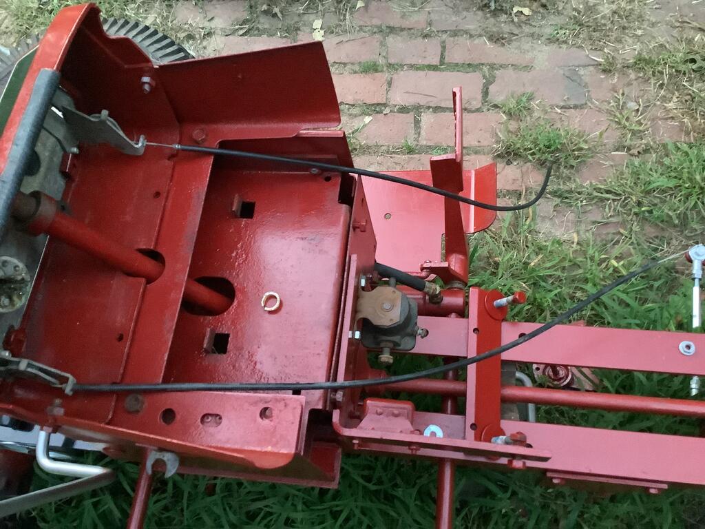

TonyToro Jr.

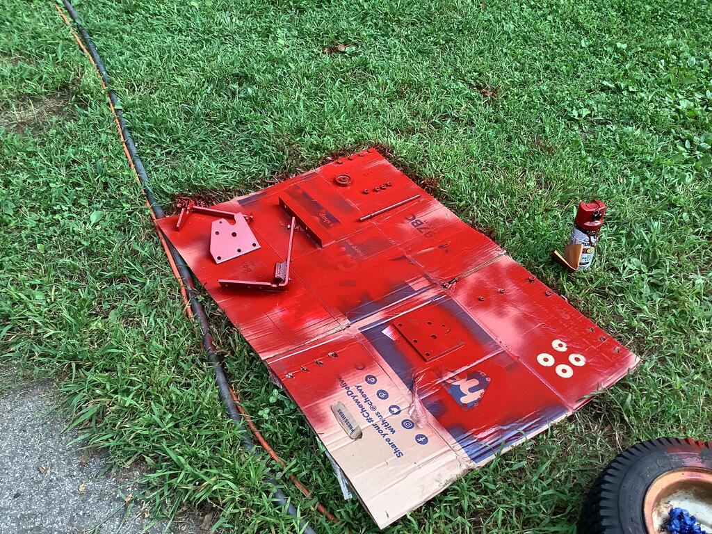

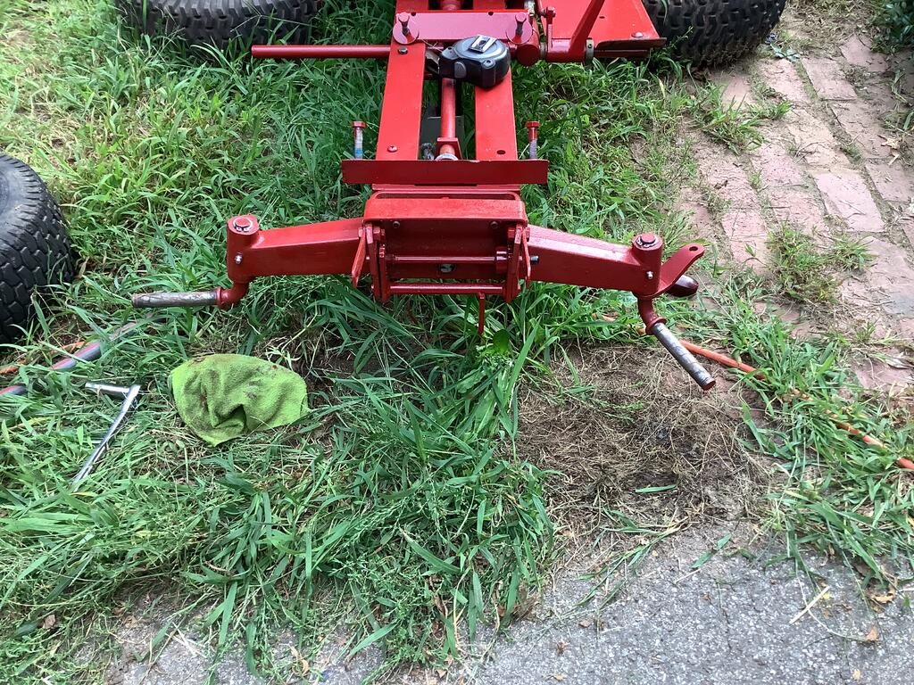

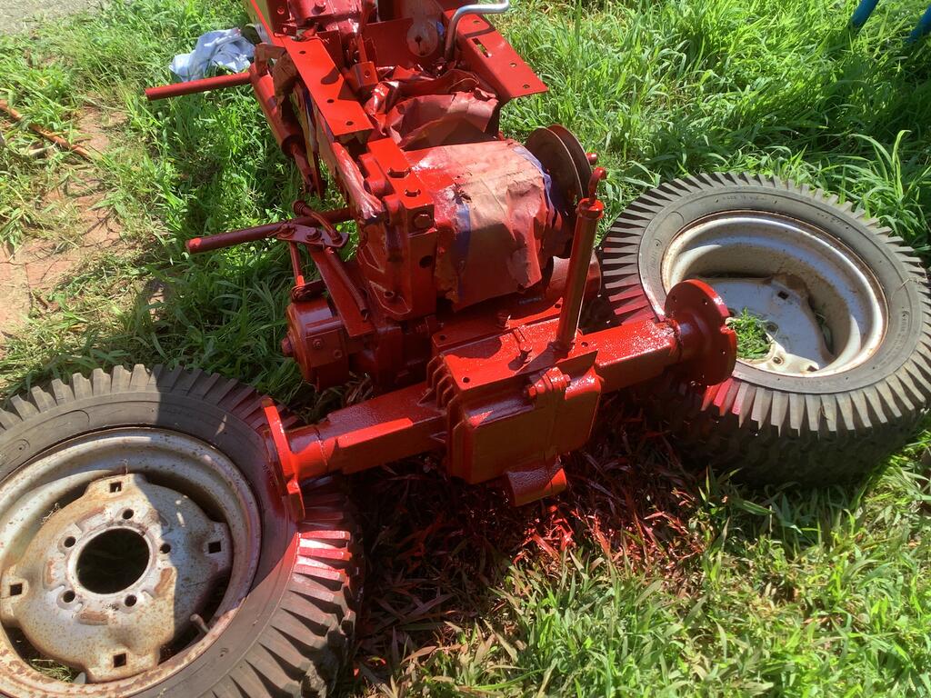

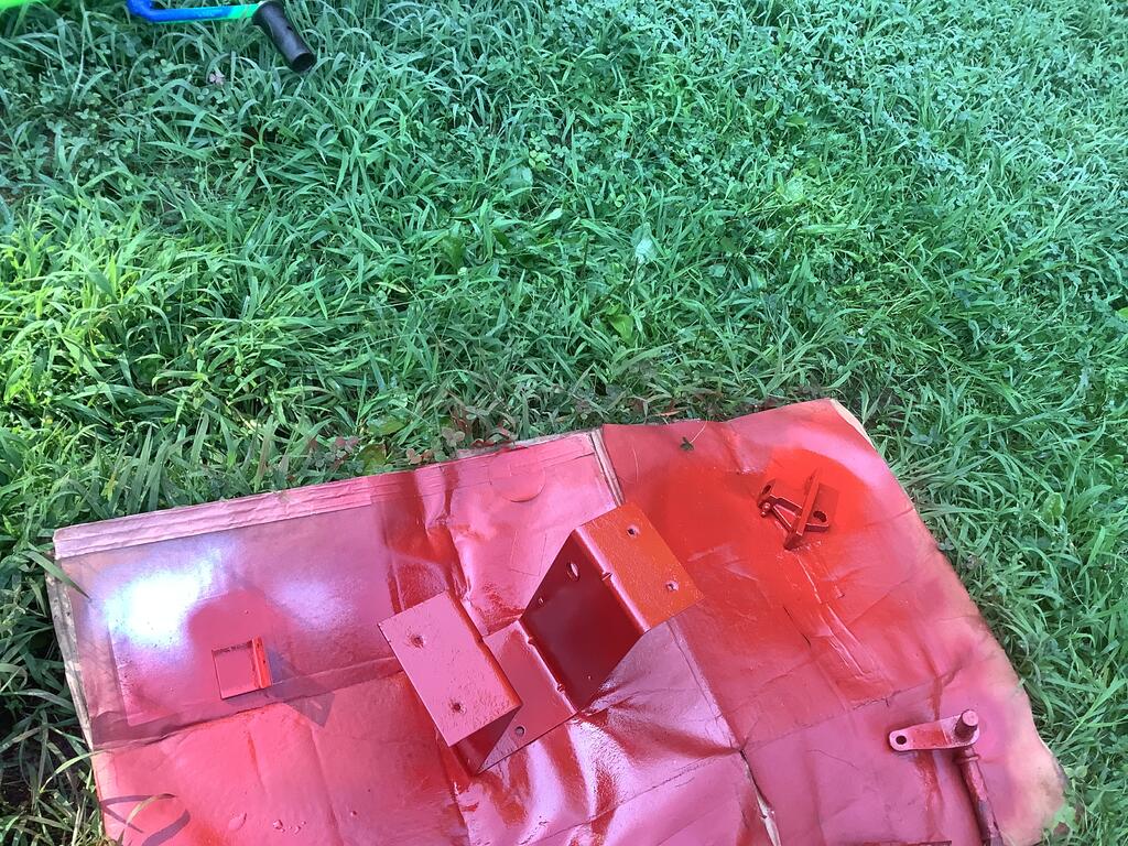

Day 5:
Got the rear half of the tractor painted and the underside.
But the fender mounting bracket back on. Painted the Hydro lever bar a rust oleum color I found in the cabinet. And put the front end back together, Waiting for the new tie rods to come (Hopefully they’ll work) then I can put the front end back on the tractor.

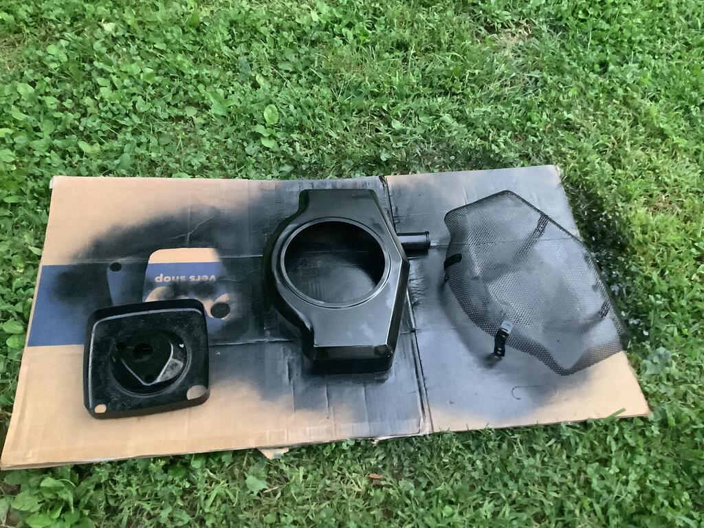

TonyToro Jr.

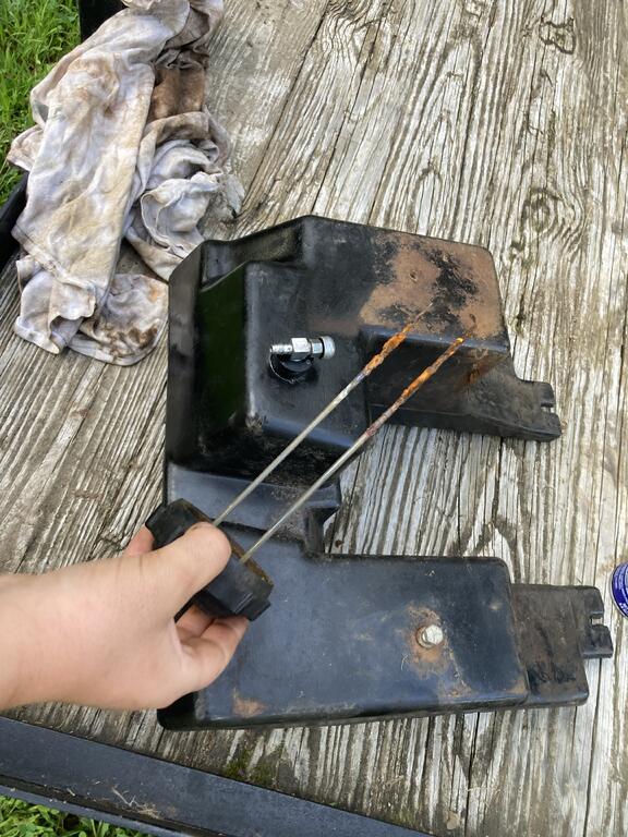

Day 6:
Yesterday got some stuff done. Got the fuel tank mounts painted and mounted up. Got the seat pan mount and that support piece painted. Got the steering tower sanded and painted. And painted the 2 black covers for the amp meter and all the controls for the hydro, hydraulics, brake etc.
Also opened up the gas tank to find a whole bunch of rusty water! Swished around bad gas in there until it came out how I put it in. Replaced the fuel tank grommet and put the shutoff valve back in.

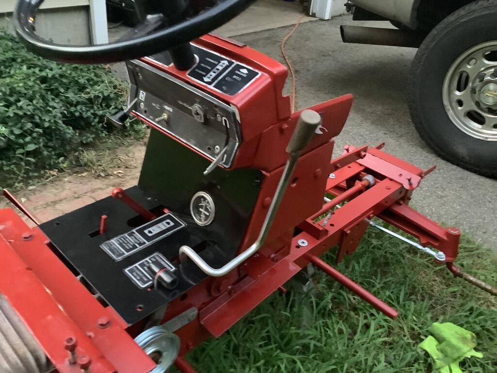

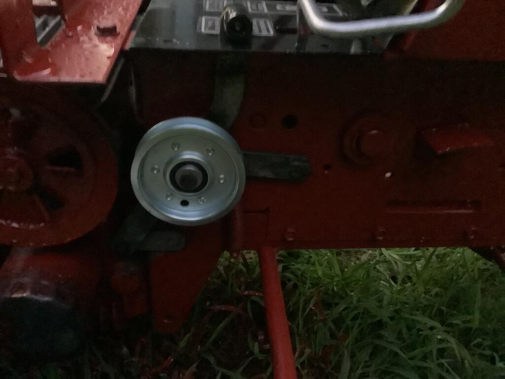

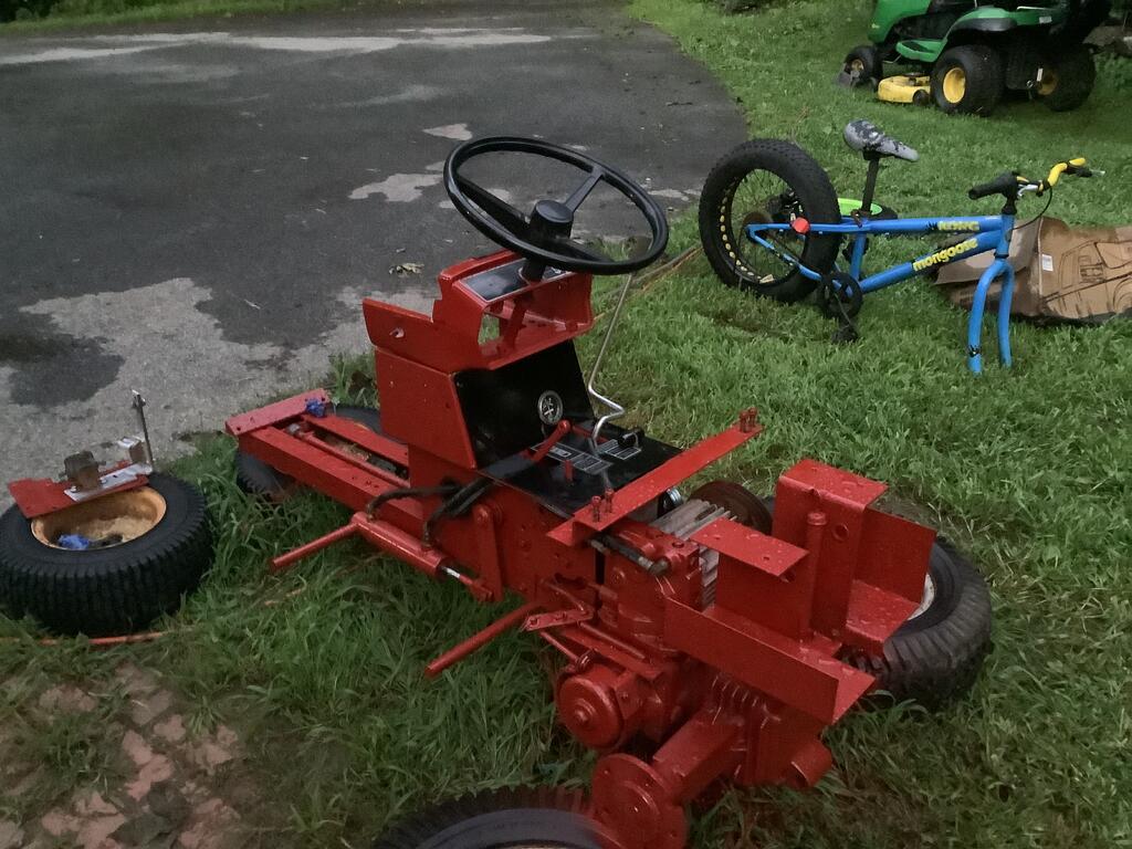

Day 7:
Well it’s starting to look like a tractor again! I put the steering colum and battery tray on. And both of the black plates for the controls and amp meter. Also installed a handle for the release for the belt and replaced the idler pulley.

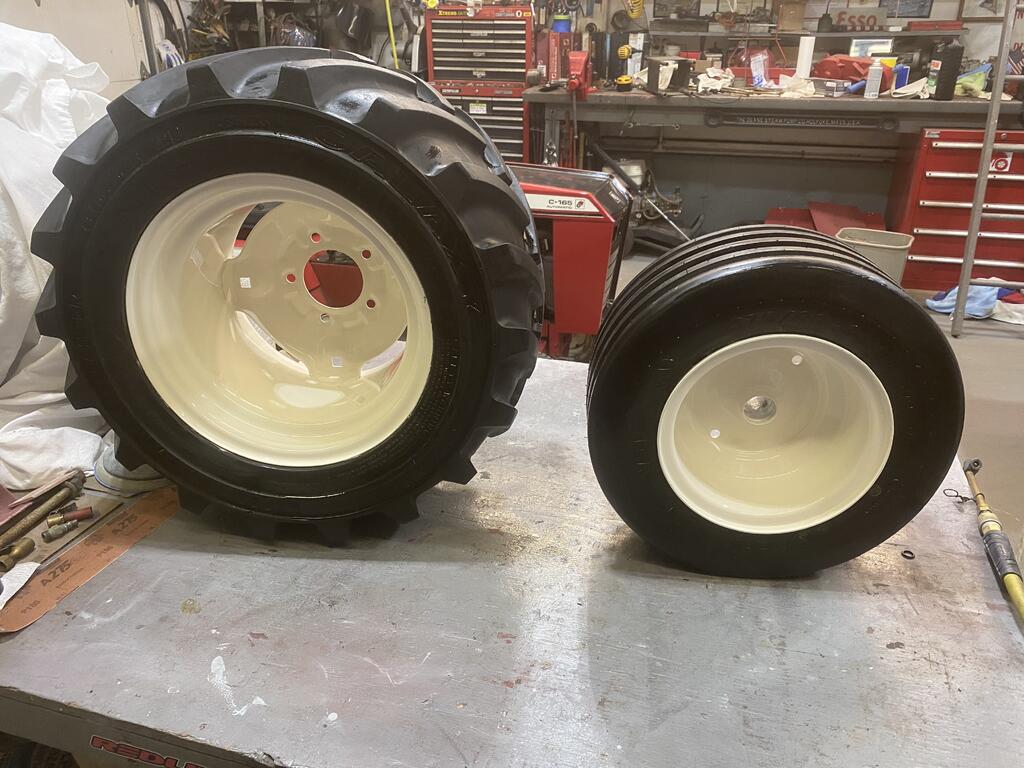

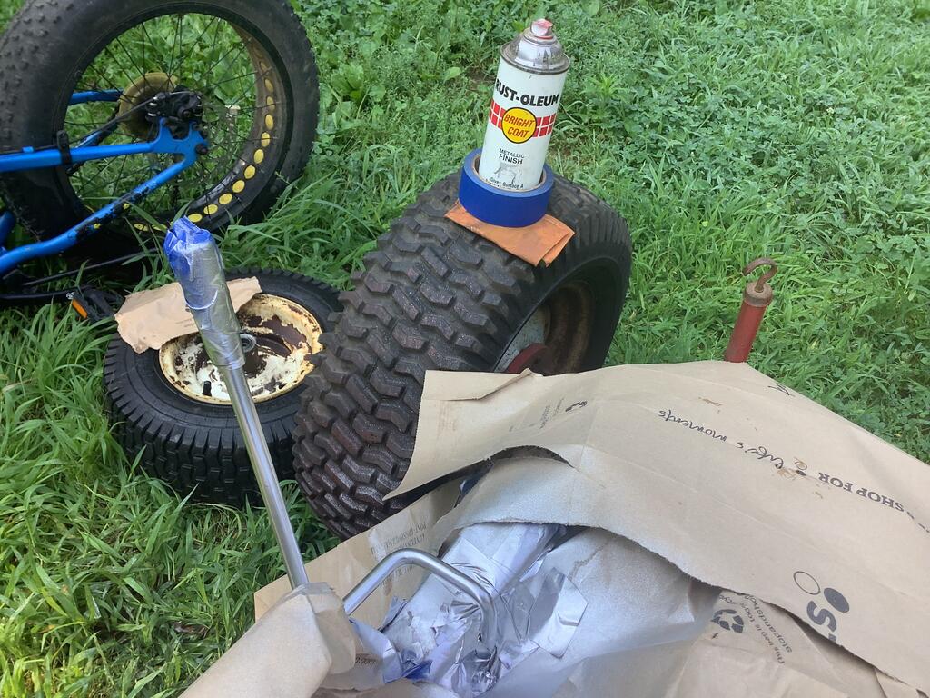

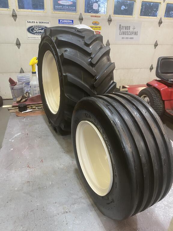

Alright so I’m going to need your guys help with this, 2 questions.
1. What kind and how much oil should I put in the transmission. It’s a sunstrand.
2. What color should I paint the rims? I want it to be as close to factory as possible.

Got the front end back on the tractor. My dad is going to shorten the tie rods tommorow then the front end should be complete. Got the front attach 0 matic on. Put on the brake linkage. And adjusted. Got the rear shaker mount block on. Got another belt guide painted, And mid attach o matic painted. Still not sure what color I should paint the rims. Thoughts?
What's your favorite?
I like a shade of off white most of all.
We usually use Rust-Oleum 2X Navajo White gloss.
Some folks like a darker shade like Almond.
  • Like 1

TonyToro Jr.
That’s the issue. I’ve never painted rims before so I really don’t know. What color do you think is the closest to factory?
  • Like 1
ebinmaine
To be honest I'm not sure. Particularly in the late 70s where you're trying to match.
@c-series don might be a good authority.
We've had a mid 60s wheel with a good non rusty interior that had (likely original) Wheelhorse tires on it. The paint on the inside was a dead match to the Navajo White we use. So close I lost sight of the sample on the rim.
  • Like 1
  • Thanks 1

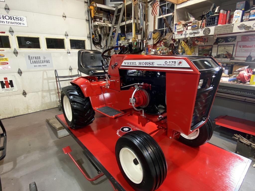

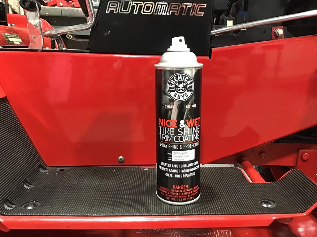

Brockport Bill
Don: do you treat sidewalls with a shine product? it almost looks like the sidewalls are painted black they look so good  -- the seat also nice and shiny????? Do you slide off seat when driving?
  • Like 1
  • Haha 1
c-series don
@Brockport Bill This is what I use on the tires, spray it and leave it on not wiping it. Just wiping whatever may get on the rims. It’ll stay shiny for quite some time, it’s not exactly cheap but it works well. I forgot what I used on the seat? Maybe the same stuff? Whatever I used does make you want to slide off the seat! Reminds me of Armoralling a bench seat so it was super slippery, then making hard right turns so the girl would slide over next to you!!! Kids now will never experience that!!!
  • Excellent 1
