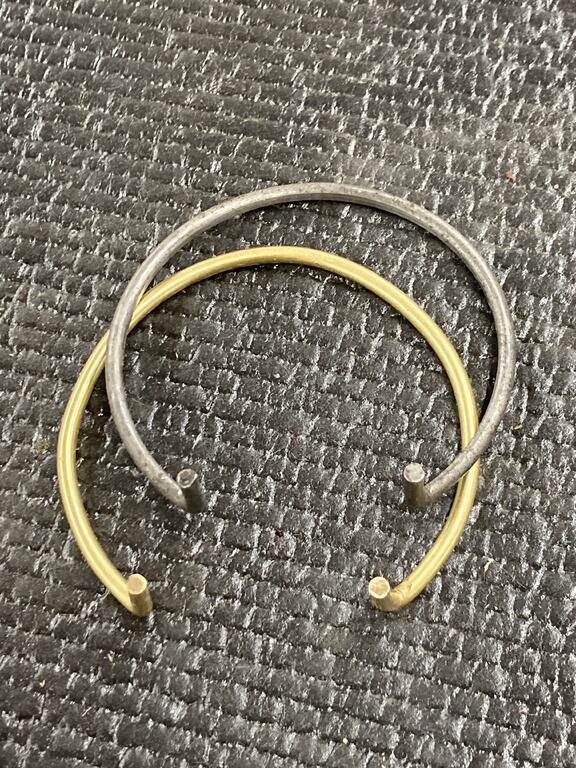

Finally found a rj35
Frankenstein 58
Will do. Thank you. I did make one but I would prefer an original one.

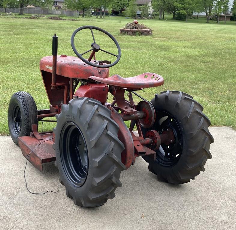

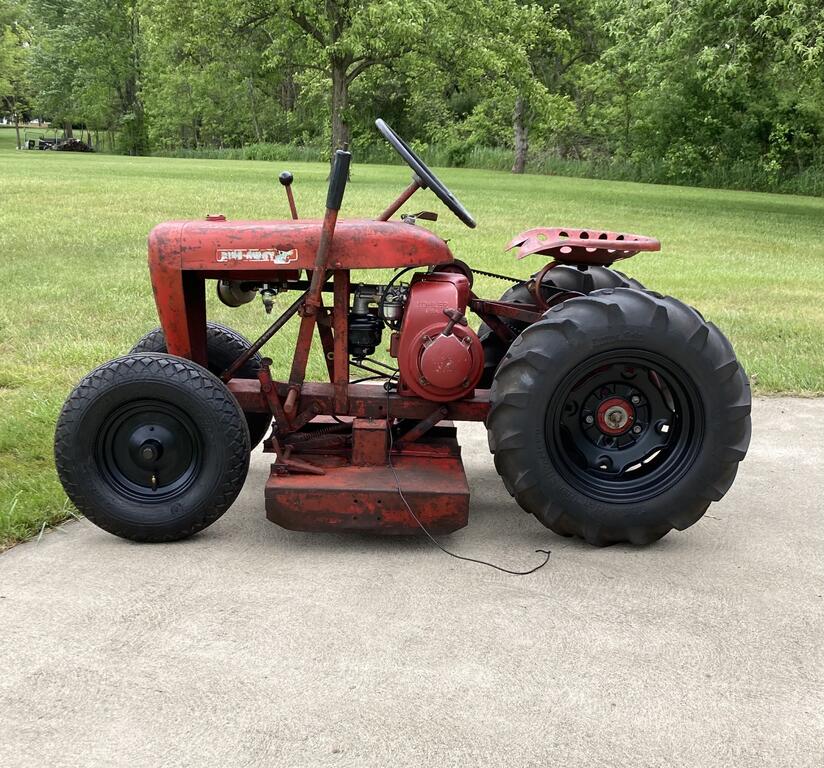

I’m stoked. Put all the cannibalized parts back on the kohler an it runs.
Frankenstein 58
I think it turned out pretty cool. I’ll pick up some belts next week and see if it can move on its own.

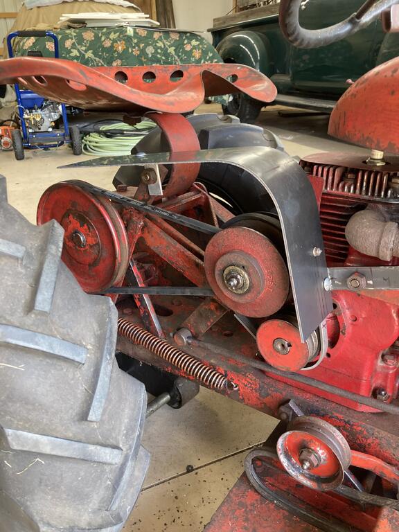

Frankenstein 58
Here is my mock up of a belt guard. Did the best I could looking at a couple pictures I found. It’s getting late so I will see if it works next weekend.

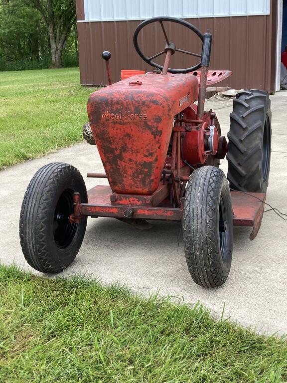

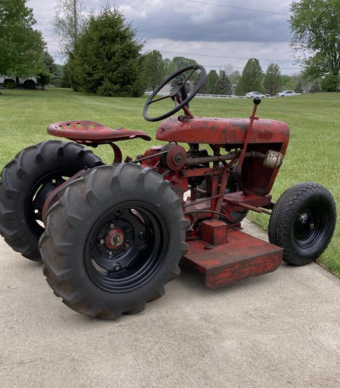

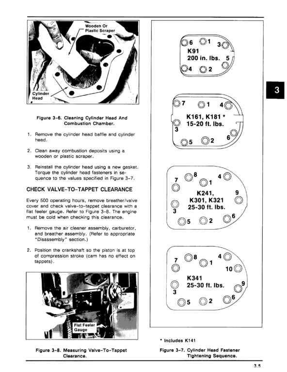

I’m not having any luck finding those parts yet. Members have given me suggestions but for some reason I can’t get in touch or I don’t get a response. So I figured the Wheel Horse Gods just want me to make my own parts. Did put new bearings and bushings in. New back inner tubes also. Rims turned black again. Working on the motor now. It was striped of everything but the exhaust. It was rebuilt at one time .020 piston is in there. All still looks nice and tight. So new coil, wires and points. Need carb gasket and torque the head. Then we will see what happens.
What is the torque lbs on the head bolts?
