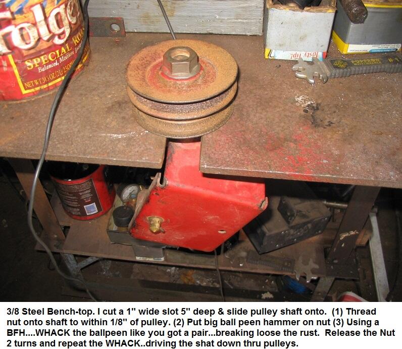

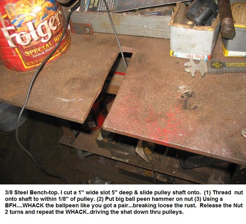

daveoman1966 3,317 #3 Posted February 3 Here's what works for me to get the stubborn pulley(s) off of the mule drive. 1 2 1 Share this post Link to post Share on other sites
GAJoe 725 #4 Posted February 3 A great set-up you have there. Thanks for going to the trouble of making the pictures. I really do appreciate it. The top pulley came right off and after some Kroil the snap rings came out of both. I was able to tap the bearing out of the pulley that came off without too much trouble trying to save it. The remaining bearing isn't worth saving so it should come out with some persuasion. Share this post Link to post Share on other sites

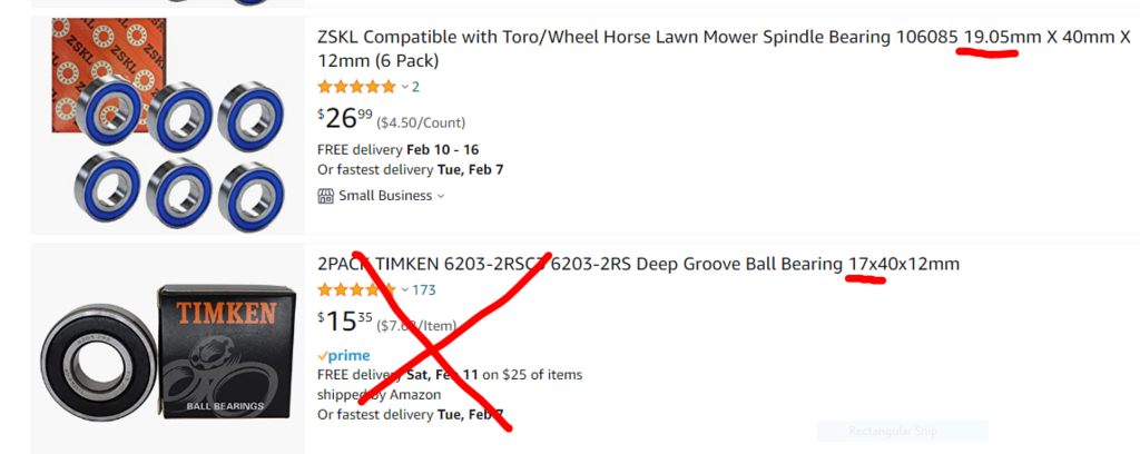

GAJoe 725 #13 Posted February 5 (edited) 10 hours ago, GAJoe said: 10-4 Got my syringe full of Lucas Green waiting for the new bearings to arrive today for repacking. Bearings were the wrong size. I hate it when you put a search in Amazon how they will list items that aren't the correct size. They just want you to buy something, anything, even if it isn't what you are searching for. The same with Google search. Edited February 5 by GAJoe correct grammar Share this post Link to post Share on other sites
ineedanother 939 #14 Posted February 5 This is a timely post and I think I would really enjoy working with @daveoman1966 I have to get a mule drive ready for work and did a search and surprisingly came up with this thread from this week. @GAJoe if you wouldn't mind linking the correct bearings, I suspect I might just want to go ahead and replace them once I employ the BFHs Share this post Link to post Share on other sites

GAJoe 725 #16 Posted February 5 (edited) 6 hours ago, ineedanother said: This is a timely post and I think I would really enjoy working with @daveoman1966 I have to get a mule drive ready for work and did a search and surprisingly came up with this thread from this week. @GAJoe if you wouldn't mind linking the correct bearings, I suspect I might just want to go ahead and replace them once I employ the BFHs @ineedanotherThe number on my original bearings is "6203RS3/4" The best source that I found was Amazon. But be careful which ones that you select. The bearing number 6203RS search will get mostly 17mm bore diameter. You want the 3/4" or 19.05mm. Here's a link to the search: https://www.amazon.com/s?k=ZSKL+Compatible+with+Toro%2FWheel+Horse+Lawn+Mower+Spindle+Bearing+106084+19.05mm+X+40mm+X+12mm+(6+Pack)&crid=2Z3UB3M1MWOMK&sprefix=zskl+compatible+with+toro%2Fwheel+horse+lawn+mower+spindle+bearing+106084+19.05mm+x+40mm+x+12mm+6+pack+%2Caps%2C152&ref=nb_sb_noss and here's what it comes back with. Here's the ones that I selected (stainless steel) and confirmed that they are the correct size, but they only come in a six pack: https://www.amazon.com/Wheel-Horse-Spindle-Bearing-106084/dp/B073FYGNL1/ref=sr_1_1?crid=2Z3UB3M1MWOMK&keywords=ZSKL+Compatible+with+Toro%2FWheel+Horse+Lawn+Mower+Spindle+Bearing+106084+19.05mm+X+40mm+X+12mm+(6+Pack)&qid=1675586221&sprefix=zskl+compatible+with+toro%2Fwheel+horse+lawn+mower+spindle+bearing+106084+19.05mm+x+40mm+x+12mm+6+pack+%2Caps%2C152&sr=8-1 If you go to a local bearing source to get one or two and give the 6203RS3/4 number stress the bore diameter is 3/4" or 19.05mm and NOT 17mm. Edited February 5 by GAJoe to direct the reply to a person Share this post Link to post Share on other sites
