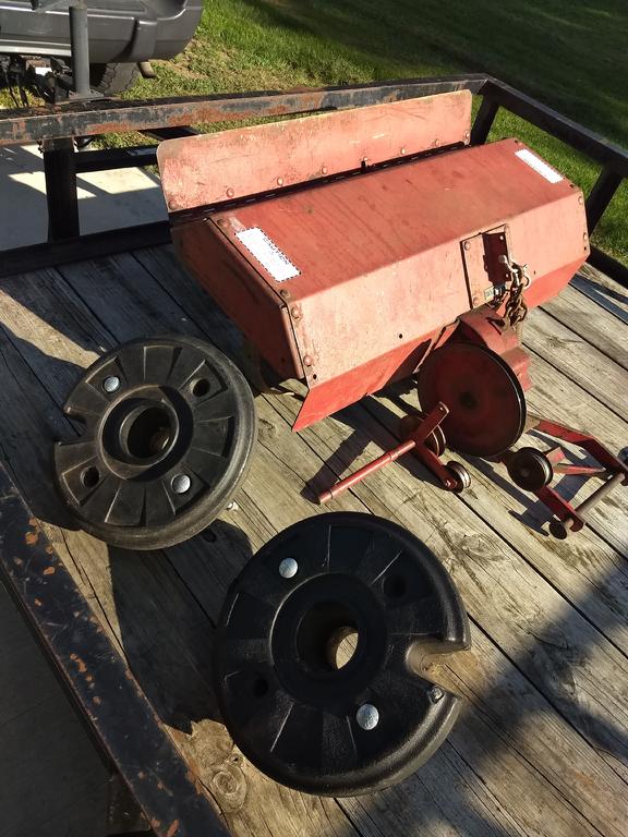

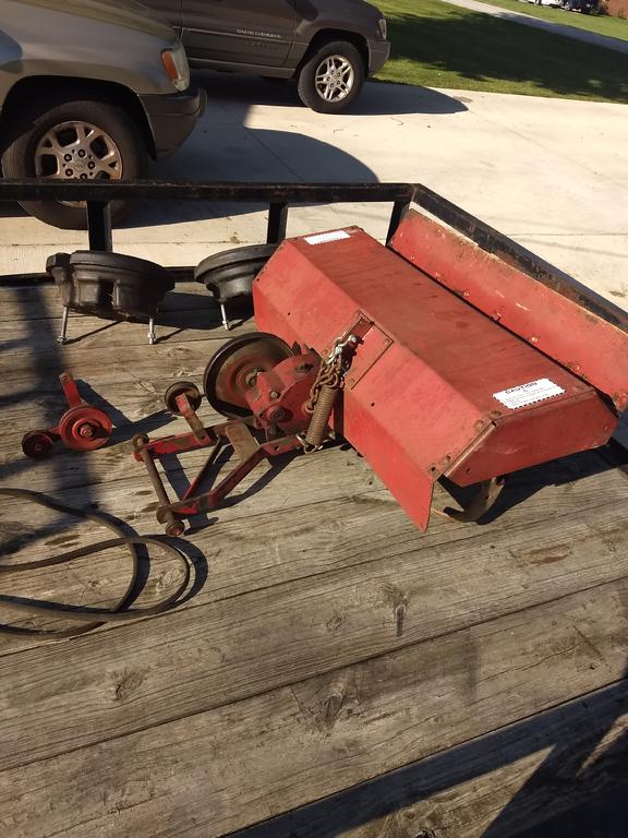

As promised here are the photos of everything for $350. Don't think I did to bad!!!!
