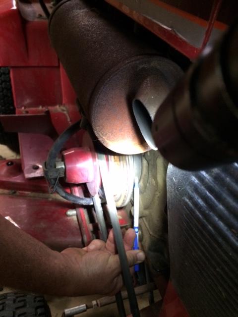

953 nut 51,511 #4 Posted August 27, 2018 If you could post a picture of the indicating what pulley is or isn't turning we can help get it going good as new. 2 Share this post Link to post Share on other sites

953 nut 51,511 #18 Posted August 28, 2018 Success! The PTO clutch disk is bolted to the drive pulley on your engine so if the PTO is driving the mower then the drive pulley on the engine is turning. Share this post Link to post Share on other sites
JAinVA 4,619 #19 Posted August 28, 2018 Great picture but I don't understand what the issue is.The pen is pointing to the main drive belt.Does this belt move when the engine is running. Share this post Link to post Share on other sites

N3PUY 1,031 #22 Posted August 28, 2018 The belt he is pointing to is not moving, but the mower belt is moving. So the drive belt is slipping …. too loose.... clutch pulley or spring. Share this post Link to post Share on other sites
gwest_ca-(File Mod) 10,478 #23 Posted August 28, 2018 As it is attempting to drive stick your toe behind the clutch pedal and pull it back so it applies more tension to the belt. There is a damper on the linkage next to the idler pulley behind the belt guard. The first damper version was a simple air shock. They will get full of dirt and fail to function. They can be washed out and returned to service. If you remove it for cleaning take notice where it is mounted as that affects when it controls the clutch pedal. Item #53 in this illustration is the damper. Item #54 are the two nuts that adjust it's position. https://www.partstree.com/parts/toro/mowers-lawn-garden-tractor/21-12k806-312-8-toro-312-8-garden-tractor-1989/clutch-brake-and-speed-control-linkage/ Item #48 is the pedal return spring on the left side of the transmission. They do get tired. Garry 1 2 Share this post Link to post Share on other sites
