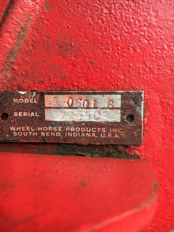

Hello! Just picked up my first wheel horse. Runs great but the blades are shot. Can’t seem to find the right blades with the   double d center and two locating pins.
I plan on getting the deck all straightened out but just need to cut right now 393966E8-4A08-4F67-B687-ED9B9C58F34D.jpeg.2c88b83156f8930049a8ab36e2e8e07a.jpeg28B9AD5C-E68E-4726-A733-38369CDB1E9C.jpeg.2a7f1236e0042f45624475b8eba44bb5.jpeg

I thought these blades were no longer available but perhaps they have been brought back. The 3-blade set is Toro part number 8969. Shop around.
https://www.partstree.com/parts/toro/parts/8969/

I believe you find that set of blades through RPCW.com, Jacks small engine or Parts Tree.  The middle blade is a little longer than the outside ones.  I believe the blades are mfg by Stenz and are less money than Wheel Horse ones. The ones I have ordered have come as a set.
