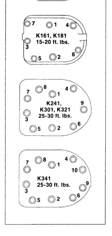

I'm trying to find somewhere here the sequence on the head bolts for K301S. I'm trying to find it with no luck.
Thanx
rotation in removal is not relevant
Installation is
