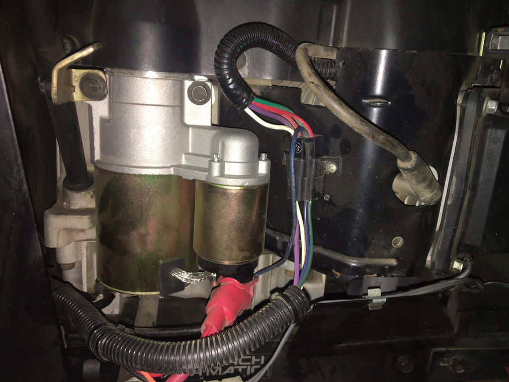

So, I have a 2001 268-H, 72087-210000269 that had the motor go out. I’ve since replaced the CV18S with a CV20S...changing the stator and flywheel over to keep stock wiring and charging. Everything is stock for wiring and all functions work great EXCEPT for charging?!?! Eventually the  battery drains  and it won’t start, just clicks.

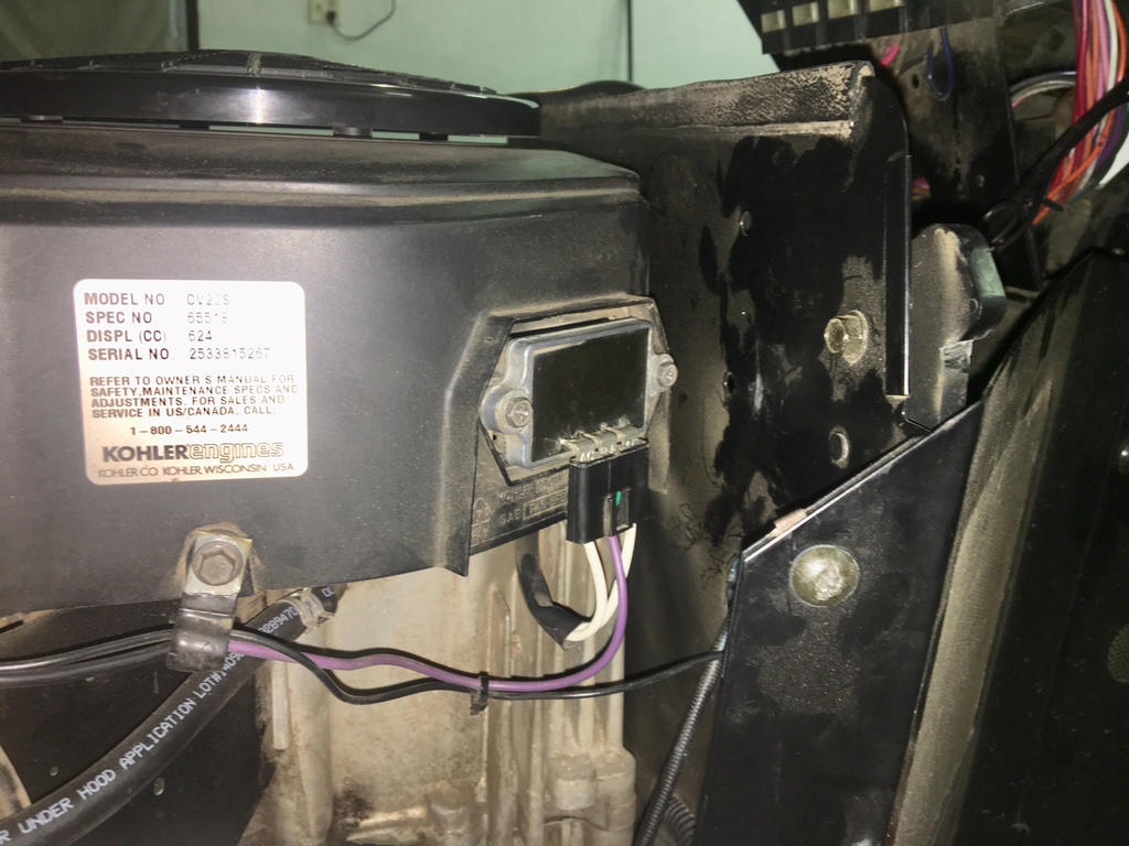

The battery icon dash light is on stating there is an issue with the charge circuit, I checked the regulator B+ terminal and it’s putting out 12.4v at idle and high speed. I believe it doesn’t ramp up to full charge unless it see’s a need to charge correct, so it’s not seeing the battery?
Regulator is brand new.

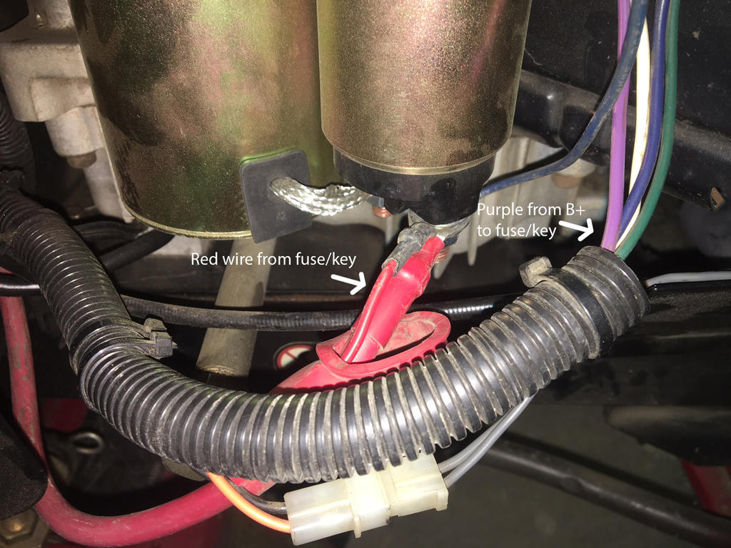

What am I missing? Not the best at wire schematics but the demystification guide shows the purple wire going into the key from 25amp fuse(power from stator), then a red from the key going to starter post along with positive battery cable, I’m guessing thats where the charge is supposed to come from once started?

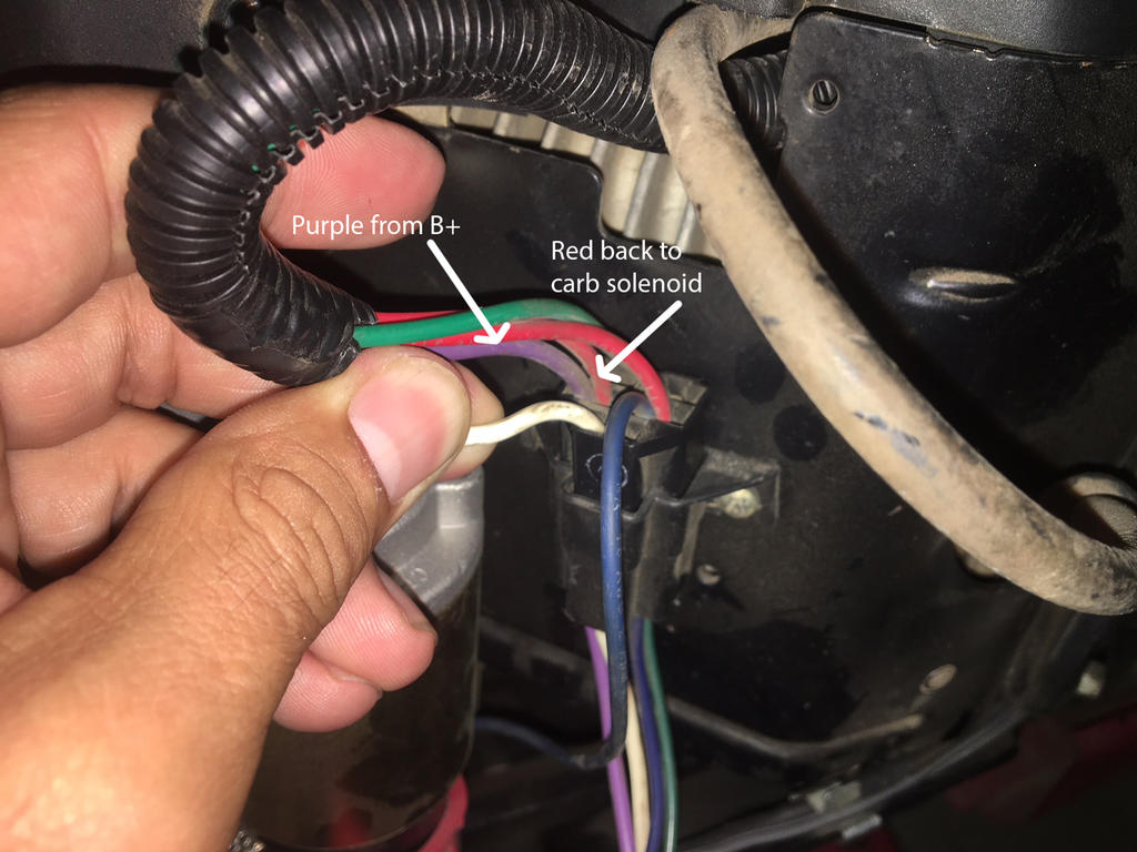

Well I'm even more stumped. I can take the new regulator and put it on my 416H....charges to 14v, on the 268H seems to do nothing. The old regulator from the 416H charges to 14v on that tractor, does nothing on the 268H. So both regulators work fine it seems. There is no ground wiring going to the regulator body on the 268H and is bolted to the plastic shroud. I thought i grounded to the carburetor solenoid as the purple wire pairs with a red wire at a connection, but I believe that energizes the solenoid to open it, not a ground.

In the regulator photo there is a black wire cable-tied to the purple. Can you tell where it goes? Wondering if there is an eye terminal on the end of it that should be under one of the regulator mounting screws. Black is often used for ground wires.
With the key OFF hook a test light or voltmeter to the battery + post. Touch the other lead to the body of the regulator. If you get a light or reading the body of the regulator is already grounded.
If it does not light add a ground wire to one of the regulator mounting screws and see it it charges.
They are using that purple to power the carb solenoid with the key in the RUN position.
To power the carb solenoid in the START position they use the motor starter solenoid circuit because the purple is not powered when starting.
Both circuits have a diode so one circuit can not backfeed the other.
The carb solenoid is powered in the RUN position allowing the motor to run so we have to assume this part of the wiring is all good.

If this kohler has the plastic shroud then you need a ground wire from your regulator mounting screw to the block
Posted (edited)
Gary and Wildman thank you! I did the light test like Gary said and no light from battery + to regulator body. Added a ground wire like you both stated and 13v at idle and 14.3v at high RPM! Now.......why is the idiot light still on?!?!  :-)  My older horses have nice gauges where I can see the voltage, now I'll constantly wonder why it's still on. At least I know for now, it's charging again.
