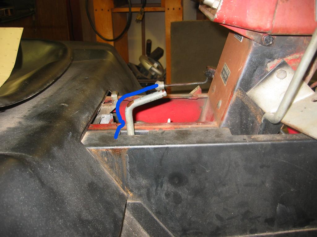

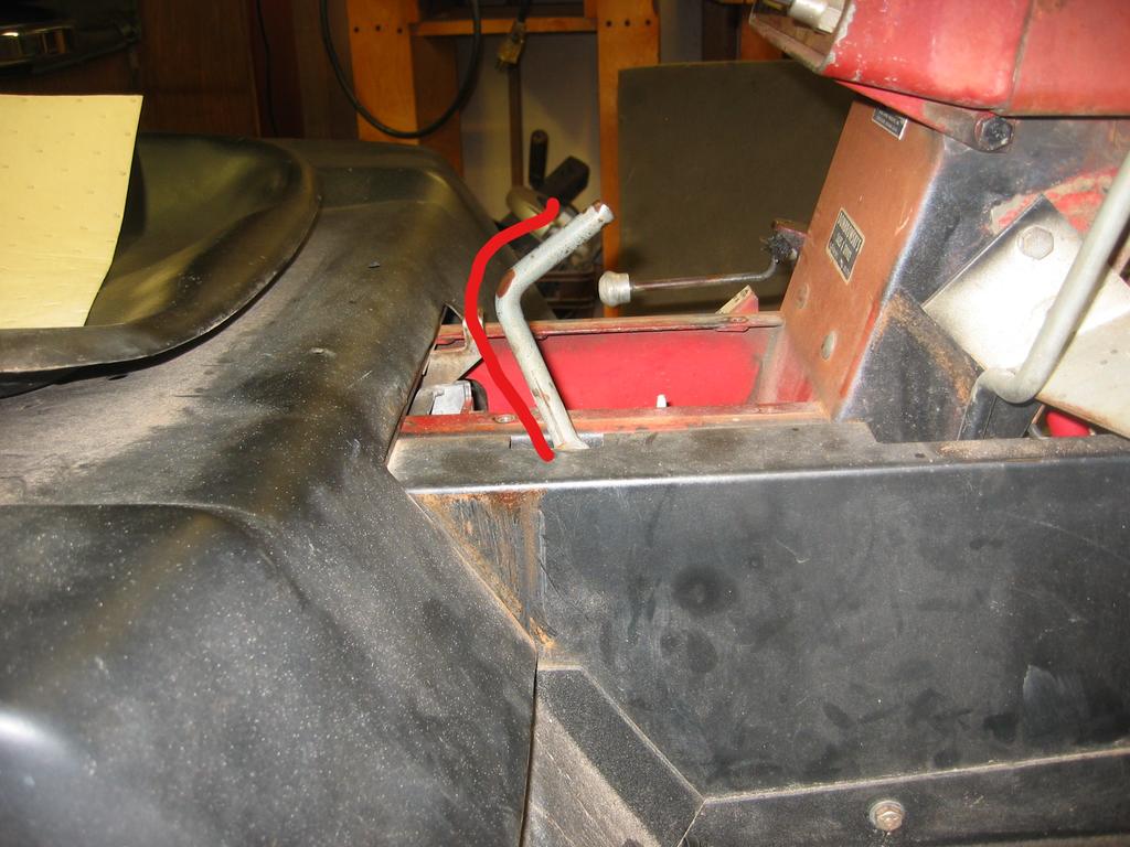

pfrederi 17,147 #14 Posted July 26, 2018 Engines do not normally whine but hydros can. When you are cranking the engine do you have the handle pulled up (red outine) or down Blue. You want it up to disengage the hydro... Share this post Link to post Share on other sites

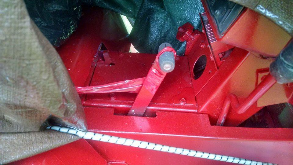

Paul Boy 31 #15 Posted July 26, 2018 Mine is somewhat different than your s appears to be. Its pouring here again today but I took a quick photo. It seems to be in the forward position. I have a plastic bag over the seat so that red that you see going toward the seat is the tie. Does the position of this lever make a difference or maybe cause the problem I described? The plate at the center was so rusted that it could not be read. Share this post Link to post Share on other sites
pfrederi 17,147 #16 Posted July 26, 2018 Interesting I have 6 Chargers none have that style engagement/parking Lever...In any event pulled up should take the tension off of the drive belt. I am wondering if the whine is from the hydro and the drag from it is keeping your engine from starting. Does the drive belt move while you are cranking the engine? Does the engine seem to crank with good speed??? Share this post Link to post Share on other sites

Sarge 3,462 #22 Posted July 27, 2018 The picture you showed of the parking brake/hydro lever is in the engaged position - it should be pulled straight up to disengage it when starting/warming the engine. If you start it with the lever in the engaged position and the direction control is not in the center neutral position that tractor will take off unexpectedly. Download the Kohler engine manual - go through the rebuild section for the starter to troubleshoot the noise. My 16 Auto has one of the loudest starters I've heard in years, works fine but it is really loud. Needs a bushing kit, but for now a lack of time is keeping it as-is. Removing the starter is easy - just be sure to remove the negative battery cable first to avoid a bad short/fire. Just a couple of bolts, and it's out after removing the cable. Sarge Share this post Link to post Share on other sites
