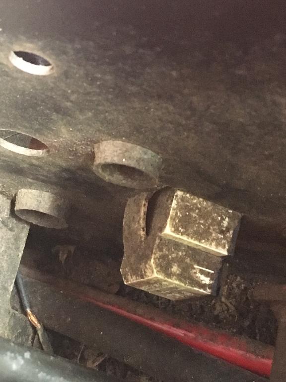

Tractor boy 238 #1 Posted July 14, 2018 So the 312-8 that I’ve been working on has a butchered harness. The tail lights are broken. The front ones are completely gone. And as the title states all but one switch is cut. Both fuses are going to get properly replaced. As for now I have a 20 and a 30 amp fuse in the slots. There should be a 15 and a 30 amp in the slots. According to the ampmeter on the tractor it is pulling a little bit over 12 Amps on the gauge. Haven’t checked when running. Besides these, as I dig deeper I find a lot of small stuff such as wirenuts holding stuff together, way too short connections and the infamous cut switch’s. I guess the whole reason of this post is these questions. 1. Can someone with another 312-8 take and post a pic of “test” switch as the leads on mine are disconnected and I’m not sure how to reattach them. 2. I’m assuming the seat switch is routers up through the pan through the hole for the tranie dipstick? 3. Finally any one know where I can get this part number for cheap? Part number- 111332. Thanks -Tractorboy Share this post Link to post Share on other sites

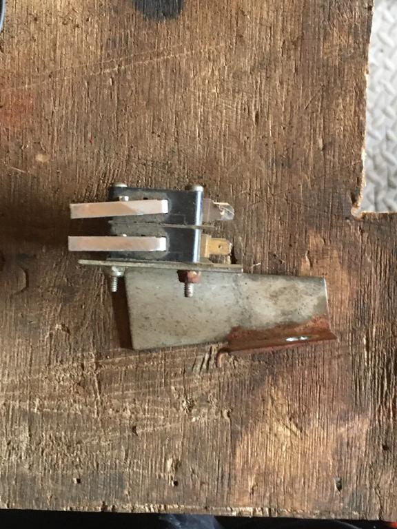

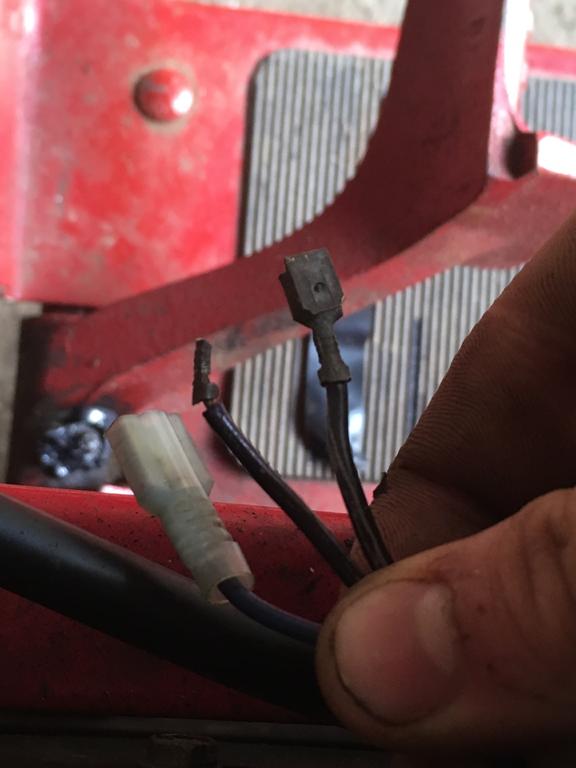

Tractor boy 238 #7 Posted July 17, 2018 Garry, this was on the right side of the battery with the three wires running to it. Should there just be the three or should there be six wires running to it? And I’m assuming this is the clutch petal switch you were referring to? Share this post Link to post Share on other sites
WVHillbilly520H 10,369 #8 Posted July 17, 2018 1 hour ago, Tractor boy said: Garry, this was on the right side of the battery with the three wires running to it. Should there just be the three or should there be six wires running to it? And I’m assuming this is the clutch petal switch you were referring to? Your second pic is of the PTO engaged/safety switch yes only 3 wires, the 3rd pic is the clutch safety switch IDK how many wires there, if you haven't already downloaded the demystification guide I suggest you do it will have ALL the wiring diagrams/schematics and trouble shooting suggestions, Jeff. Share this post Link to post Share on other sites
