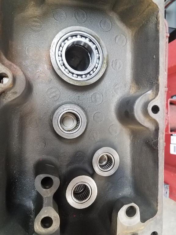

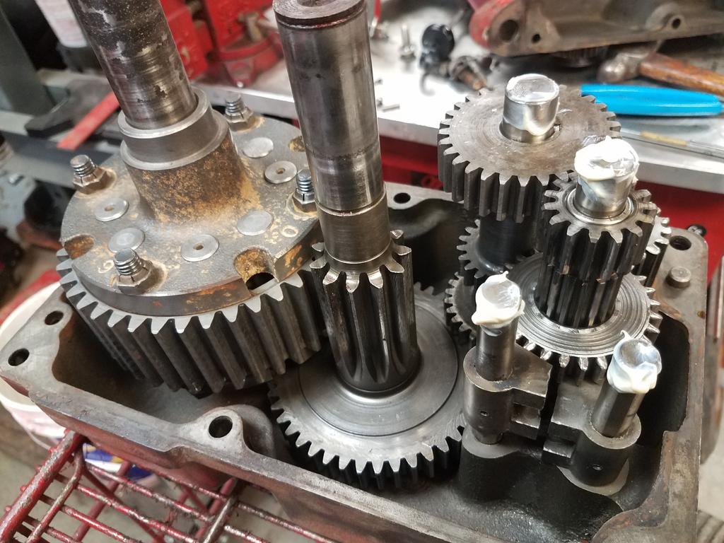

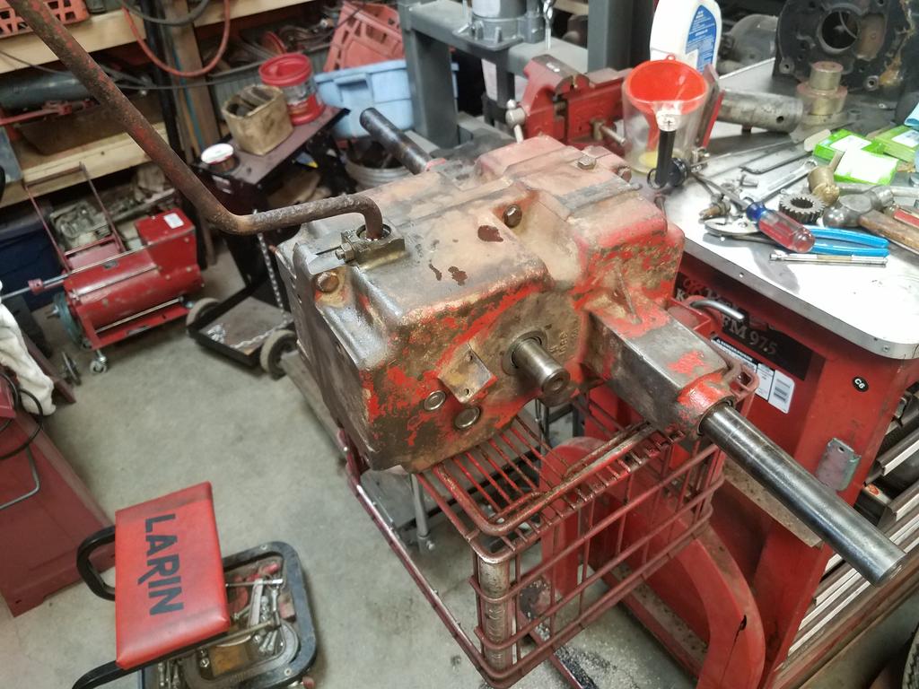

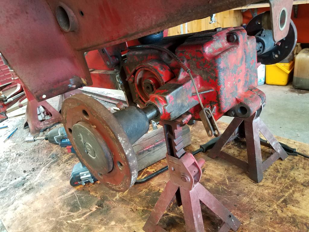

Shynon 7,427 #26 Posted August 14, 2018 Got some time today, put in all new bearings, did a dry assembly to make sure i had it correct with the 8 pionion differential in it. All was good, so i put the gasket in and sealed it up. Filled with oil, oh and when you do this put the drain plug in first . 3 1 4 1 Share this post Link to post Share on other sites
AMC RULES 36,937 #27 Posted August 14, 2018 Imagine what that sounded like. 2 Share this post Link to post Share on other sites
ebinmaine 62,359 #28 Posted August 14, 2018 11 minutes ago, Shynon said: put the drain plug in first That's funny stuff right there. Good to know you're human. Sounds like something I may have done in the past... 1 Share this post Link to post Share on other sites
Mows4three 824 #29 Posted August 14, 2018 I'm good for at least one oil change on the floor in our machine shed or in the garage every three years or so! 3 Share this post Link to post Share on other sites
ebinmaine 62,359 #30 Posted August 14, 2018 5 minutes ago, Mows4three said: I'm good for at least one oil change on the floor in our machine shed or in the garage every three years or so! Not sure if I should admit this in public but it's definitely a lot more often than that for me. 4 Share this post Link to post Share on other sites
19richie66 16,824 #31 Posted August 15, 2018 Been there, done that. Maybe twice 1 2 Share this post Link to post Share on other sites
dells68 7,494 #32 Posted August 15, 2018 Hate to say it, but I put almost 3 quarts in my truck when changing the oil and looked down and saw a caramel river running toward my feet😊! We've all done it before, just hard to admit our own mistakes, but easy to laugh at other's mistakes! 2 2 Share this post Link to post Share on other sites
WHX?? 46,404 #33 Posted August 15, 2018 (edited) 1 hour ago, 19richie66 said: Been there, done that. Maybe twice I've NEVER done that.....yah right! Nice lookin innards anyway Tom! Note the lubriplate fellas .... that how to do it right! Edited August 15, 2018 by WHX20 1 Share this post Link to post Share on other sites
cleat 4,895 #34 Posted August 15, 2018 16 hours ago, Shynon said: Got some time today, put in all new bearings, did a dry assembly to make sure i had it correct with the 8 pionion differential in it. All was good, so i put the gasket in and sealed it up. Filled with oil, oh and when you do this put the drain plug in first . It holds more oil that way. 2 Share this post Link to post Share on other sites

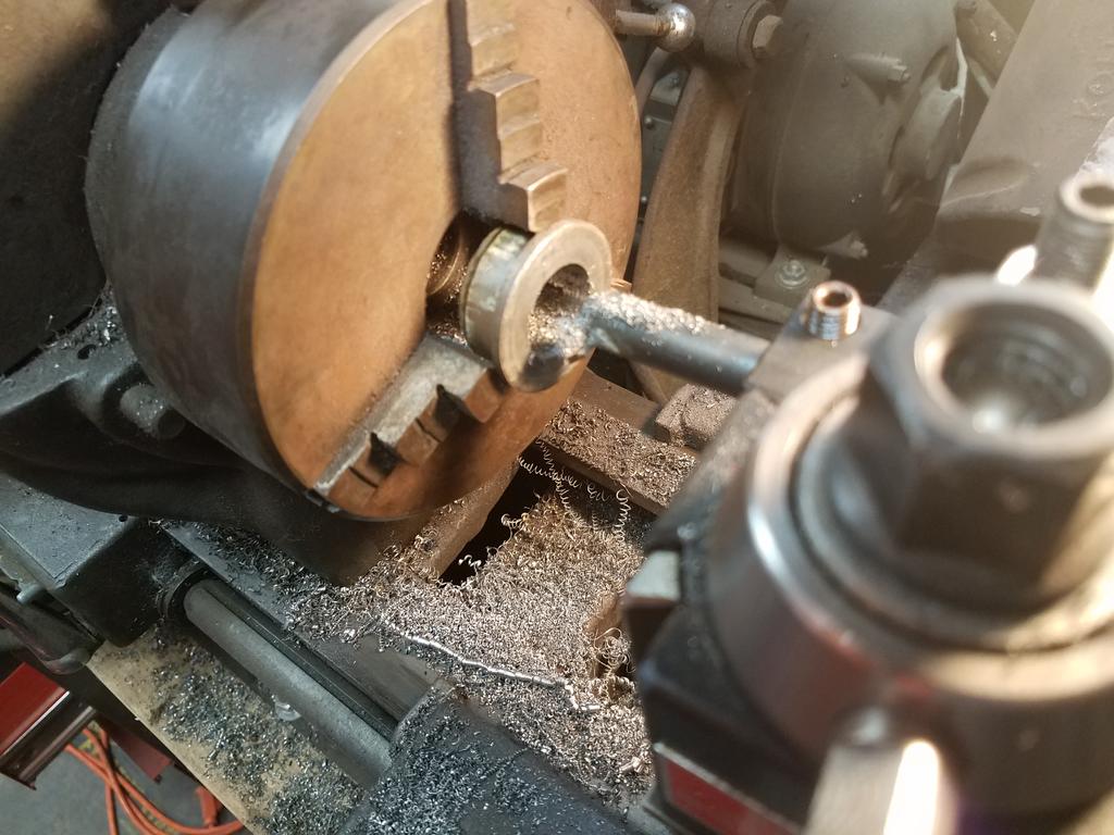

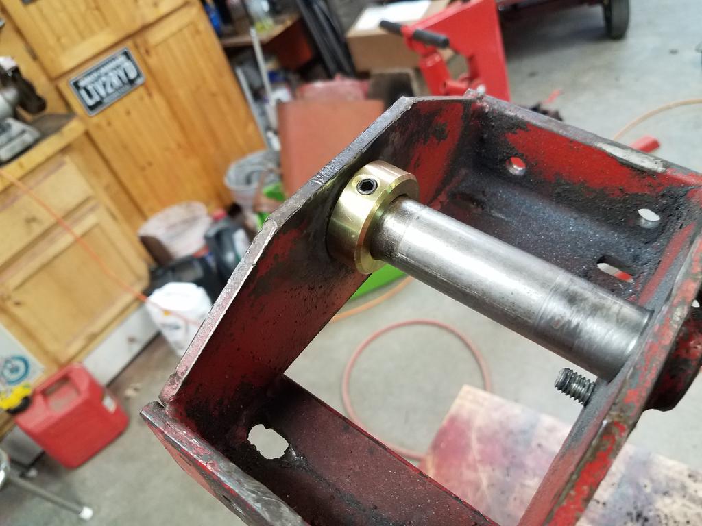

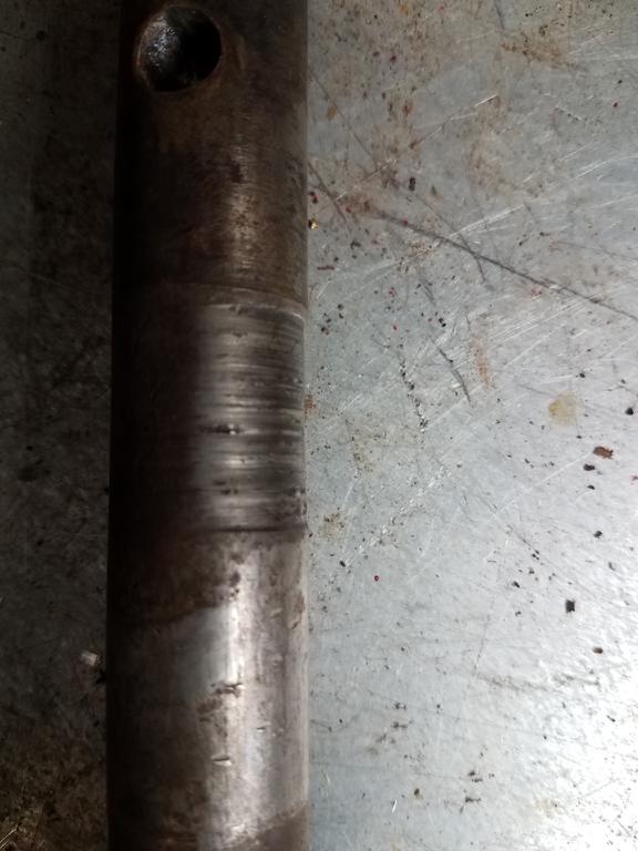

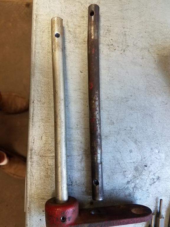

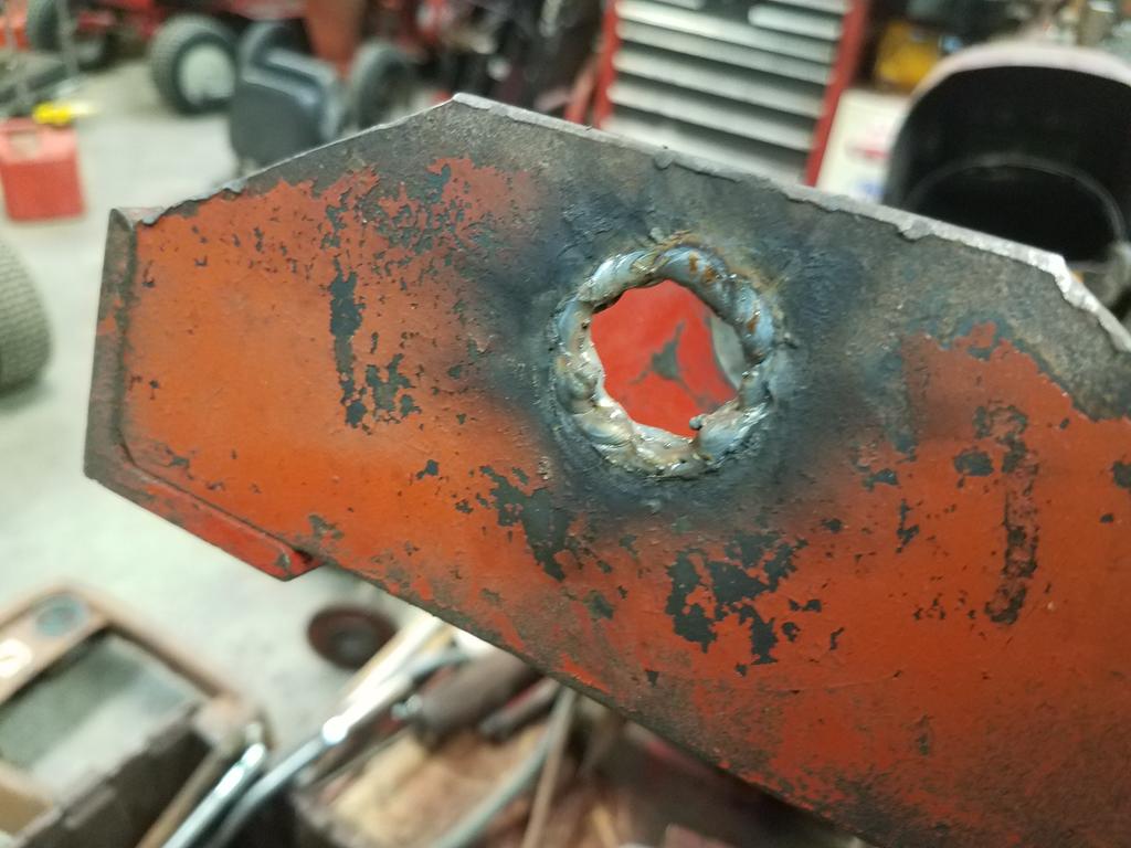

Shynon 7,427 #35 Posted August 20, 2018 Steering shaft bushing NLA so i opened up the inside of some old front wheel bushings. Front axle hole was washed out so i welded around the hole, then I'm going to refit the NOS pin i got off 4 3 Share this post Link to post Share on other sites
cleat 4,895 #36 Posted August 20, 2018 Hole built up with weld looks good. It will be a bear to drill, good thing is that it should never wear out again. I like your home made bushing too. Must be nice to have a lathe to tinker with. Cleat 2 Share this post Link to post Share on other sites
Shynon 7,427 #37 Posted August 21, 2018 2 hours ago, cleat said: Must be nice to have a lathe to tinker with. yes it comes in handy Share this post Link to post Share on other sites
19richie66 16,824 #38 Posted August 21, 2018 (edited) I used a sealed collar bearing in the steering tube on my gt14 instead of the bushings. They fit the tube perfectly and seem to work great. I can get the number if interested. Nice work! Edited August 21, 2018 by 19richie66 1 Share this post Link to post Share on other sites

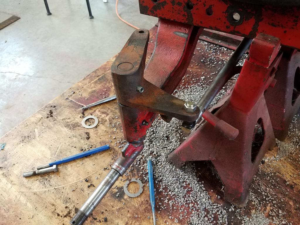

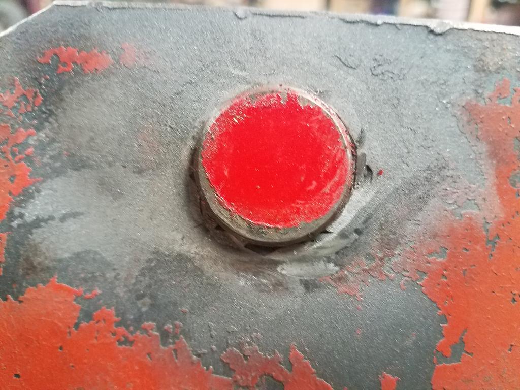

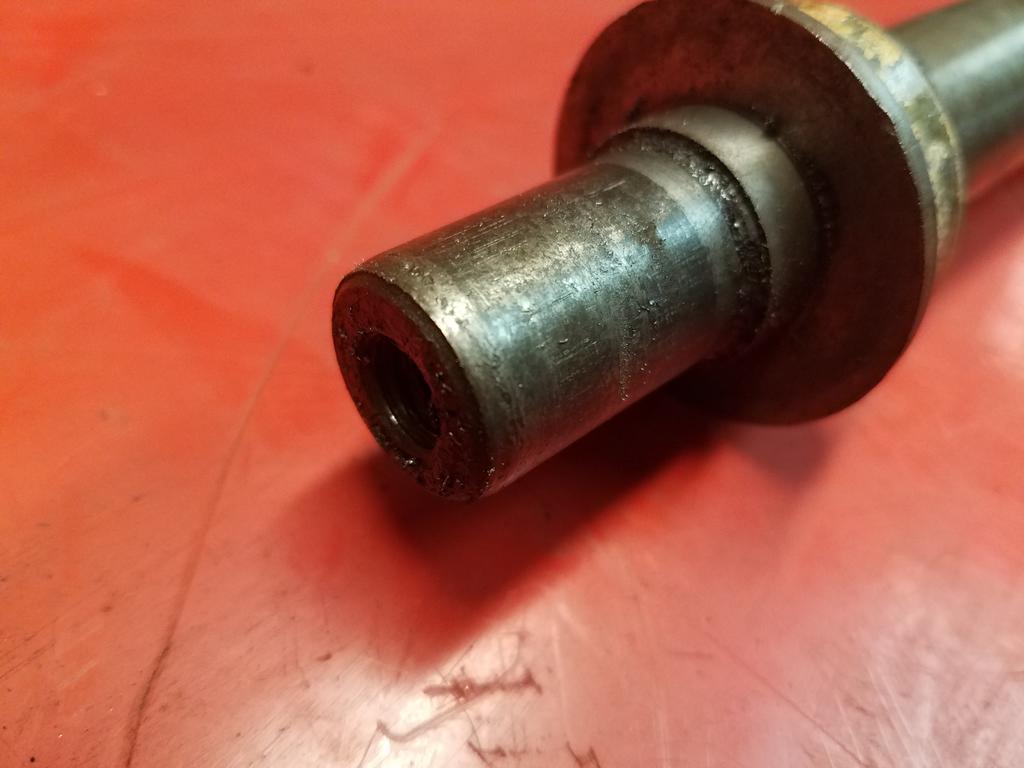

Shynon 7,427 #39 Posted August 21, 2018 Today i cut 1/2" off the old axle pin and used a 1" collar as a giude to grind the weld out, finished with a 1"grinding stone. Actually worked pretty well the pin is tight no slop. Pulled off the front wheels an pulled out the spindles. 1 9 Share this post Link to post Share on other sites
cleat 4,895 #40 Posted August 22, 2018 Looks good/ Good idea grinding it !! 1 1 Share this post Link to post Share on other sites
dclarke 4,011 #41 Posted August 22, 2018 Nice work Tom! 1 Share this post Link to post Share on other sites

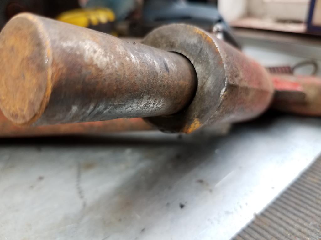

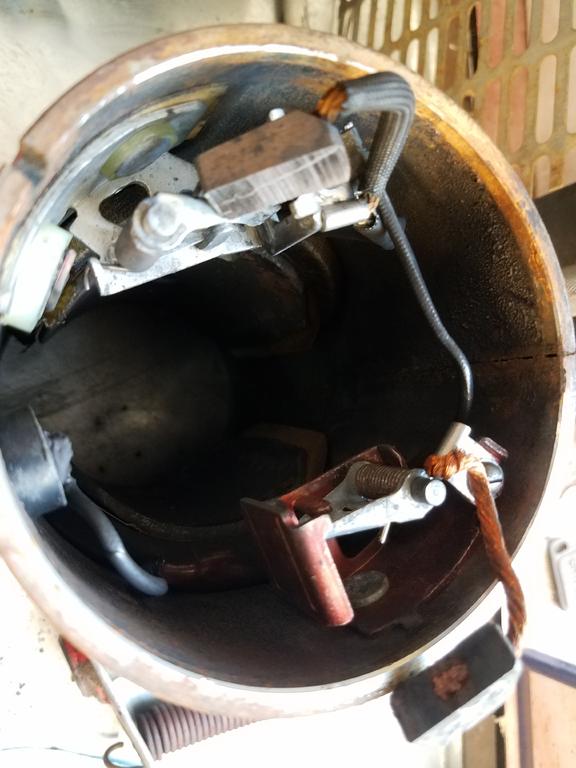

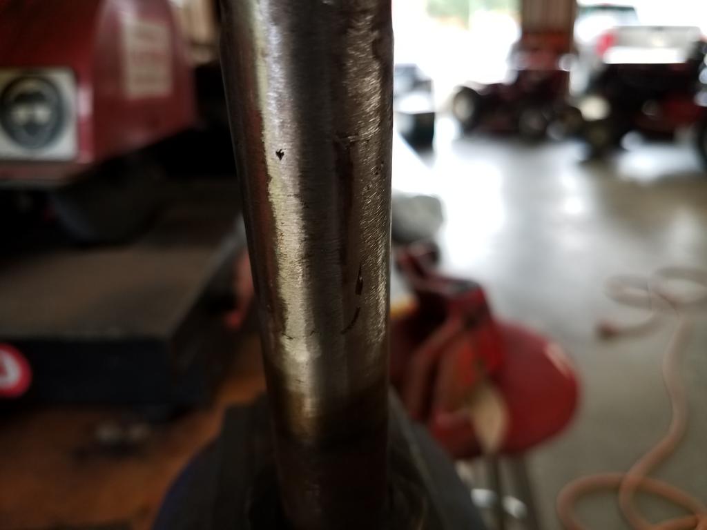

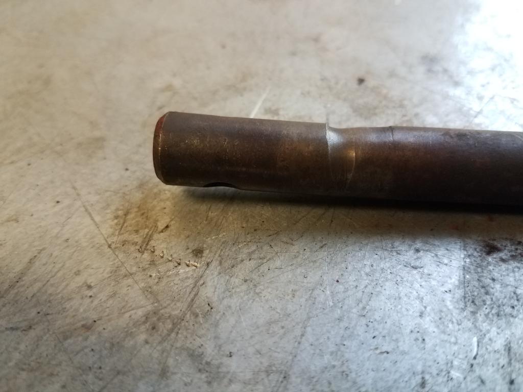

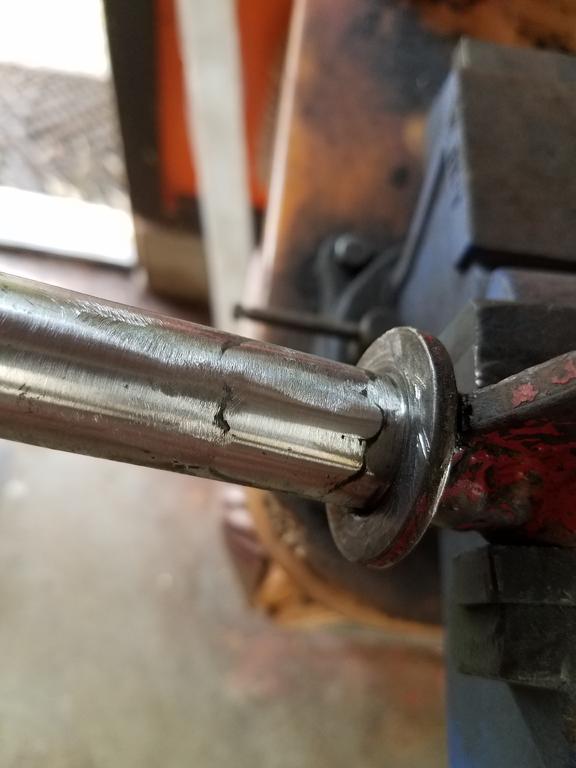

Shynon 7,427 #42 Posted August 24, 2018 Replaced the clutch brake cross shaft it was well worn and bent. 5 Share this post Link to post Share on other sites
19richie66 16,824 #43 Posted August 24, 2018 Dang! Looks like the one on my wife’s. Share this post Link to post Share on other sites
Pullstart 58,794 #44 Posted August 27, 2018 What bends the clutch rod that bad? Tight belt? Too much pressure on the brakes? Share this post Link to post Share on other sites

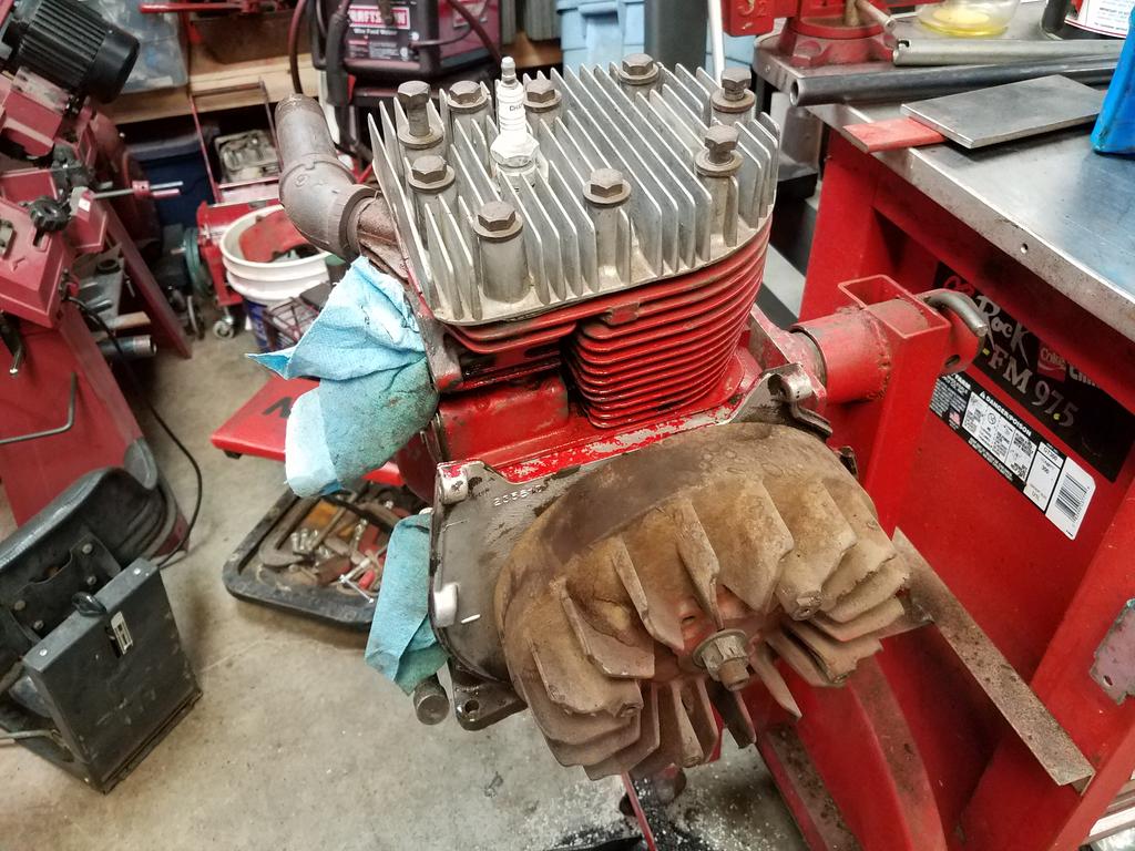

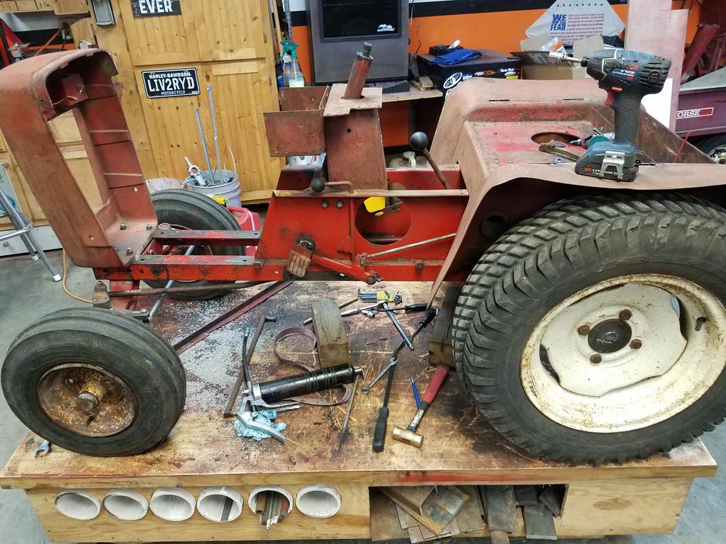

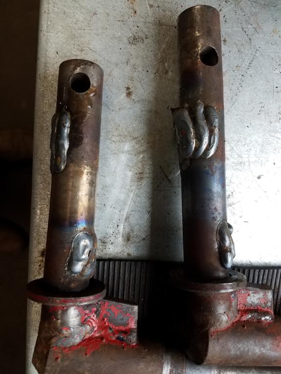

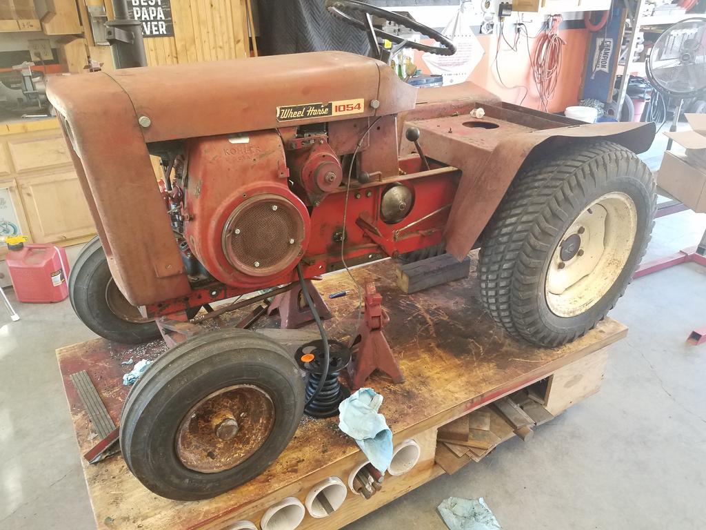

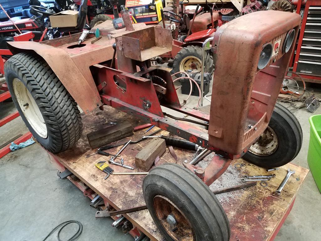

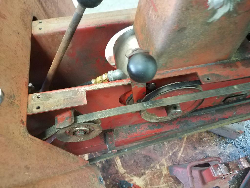

Shynon 7,427 #45 Posted September 3, 2018 Welded up the spindles today, fitted them back into the axle. New bearings and races on the front wheels. Rockshaft, steering shaft and fan, transmission bolted up. Wheels and tires on. Dug out the old motor from The Machine realized I need to switch out the oil pan. 3 4 Share this post Link to post Share on other sites

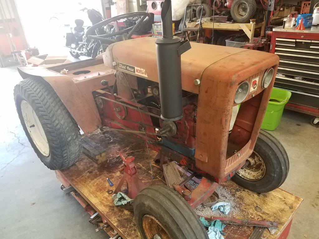

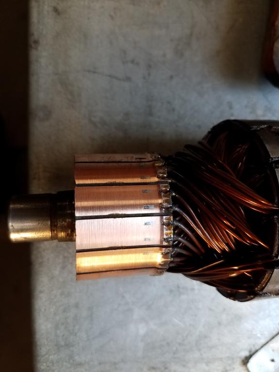

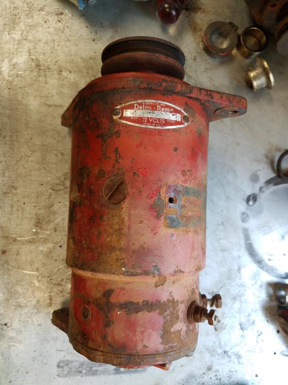

Shynon 7,427 #46 Posted September 16, 2018 Motor on, generator rebuilt, hy pump rebuilt, had to pull transmission gas tank had a leak, resoldered appears to not be leaking,reinstall transmission. 2 7 Share this post Link to post Share on other sites
19richie66 16,824 #47 Posted September 16, 2018 Nice! Always love the updates. 👍 1 Share this post Link to post Share on other sites
Daron1965 644 #48 Posted September 16, 2018 I'm very impressed with the build. 1 1 Share this post Link to post Share on other sites
WHX?? 46,404 #49 Posted September 16, 2018 Real nice Tom... sometimes can be a real pain leaving or getting things back to original ain't it? 2 Share this post Link to post Share on other sites
Shynon 7,427 #50 Posted September 17, 2018 27 minutes ago, WHX20 said: sometimes can be a real pain leaving or getting things back to original ain't it Yep, sometimes things are worn and you have to do the best you can with what you have. And time you have, hoping to pull a plow at the meet and greet. 4 Share this post Link to post Share on other sites
