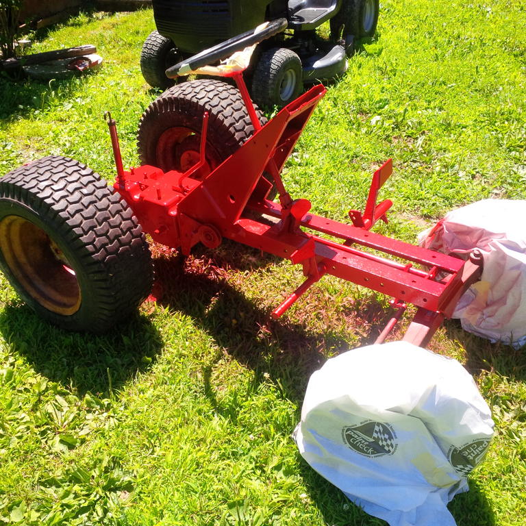

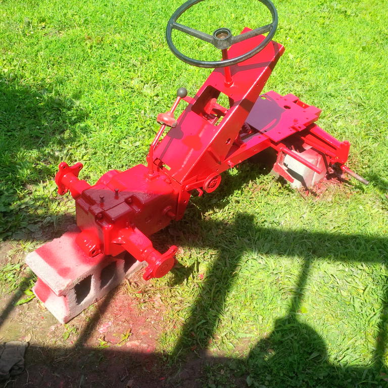

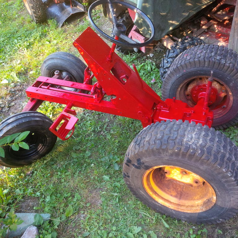

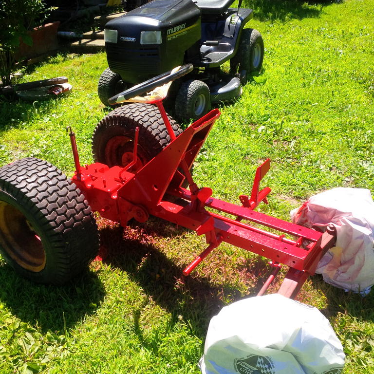

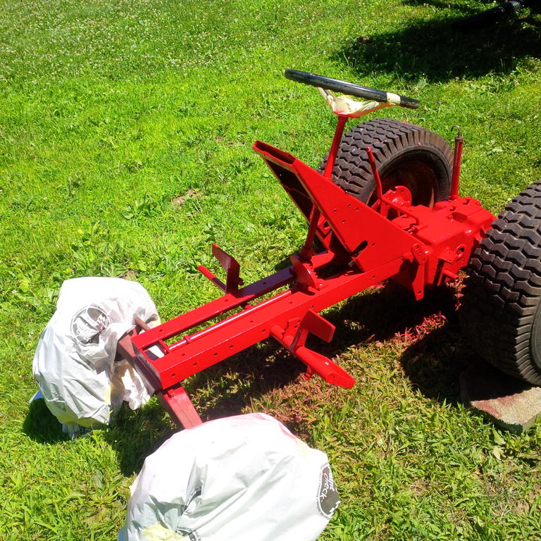

fast88pu 3,313 #28 Posted July 7, 2018 I stripped all the paint off her today. Then sanded primed and painted it. 2 2 Share this post Link to post Share on other sites
ebinmaine 63,114 #29 Posted July 7, 2018 Fast work Kyle ! Looks good. 1 Share this post Link to post Share on other sites
19richie66 16,942 #30 Posted July 7, 2018 Don’t waste any time that’s for sure. 1 Share this post Link to post Share on other sites

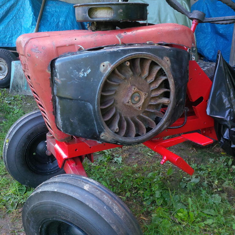

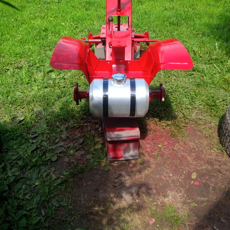

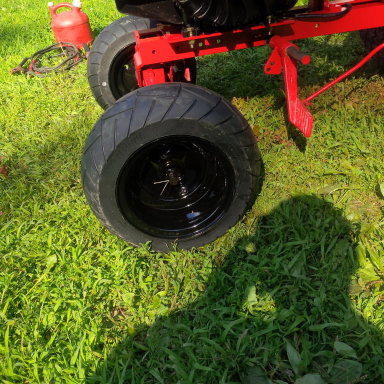

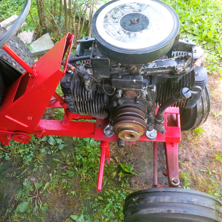

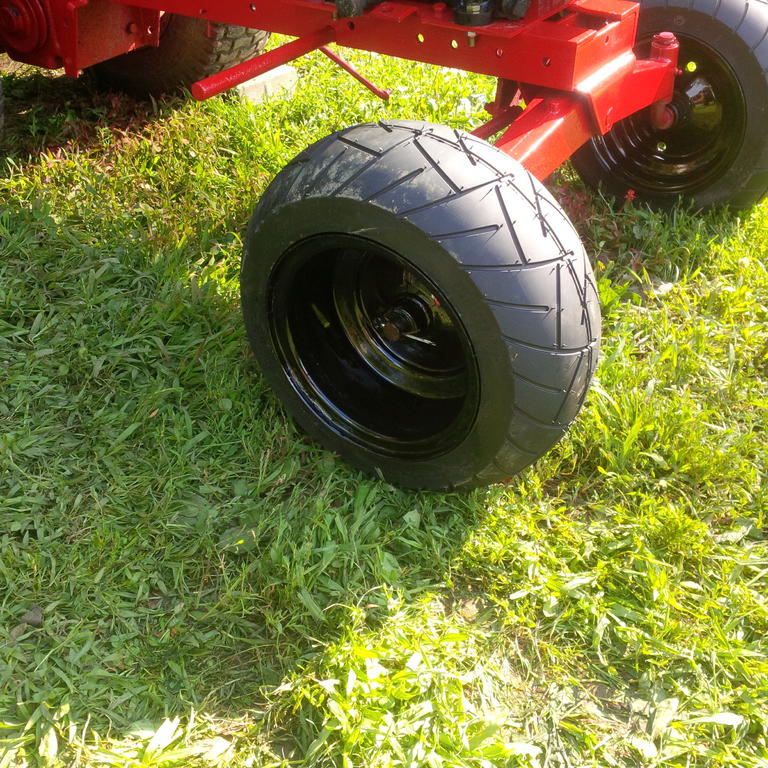

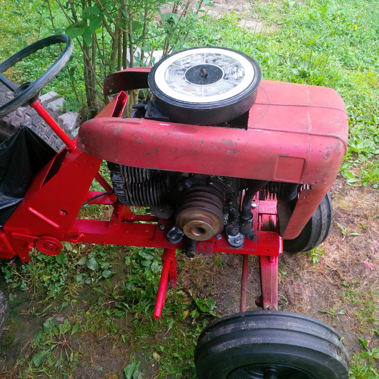

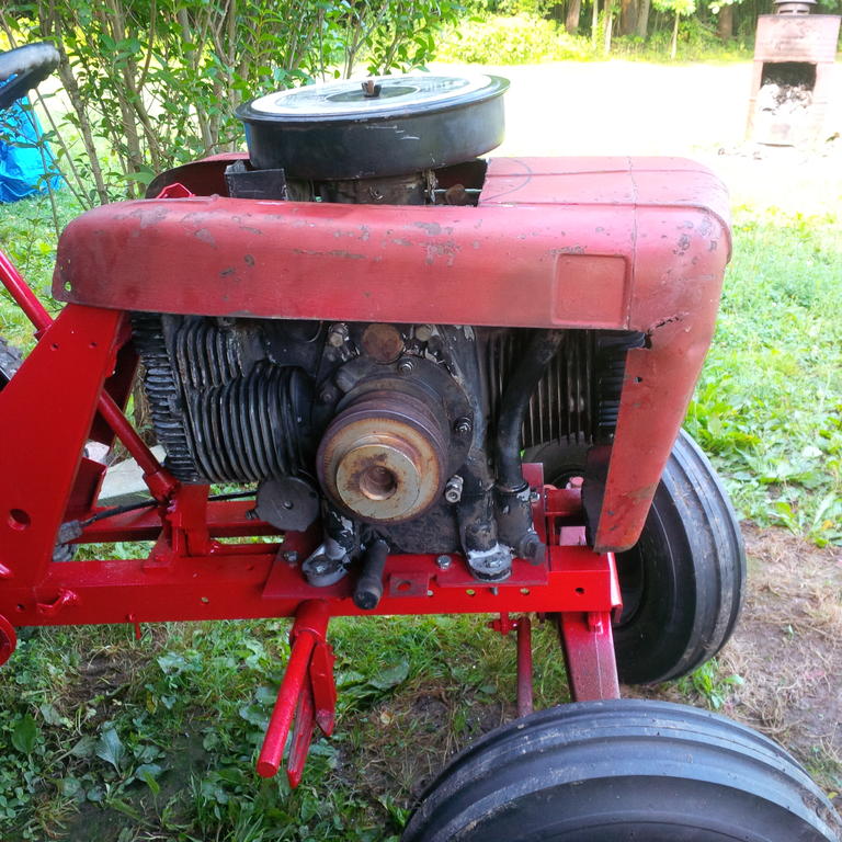

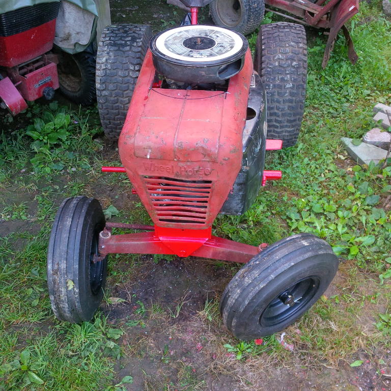

fast88pu 3,313 #32 Posted July 28, 2018 So I have more progress I have done. Hood cut, fenders on, front tires and wheels fuel tank 4 Share this post Link to post Share on other sites
AMC RULES 36,945 #33 Posted July 28, 2018 OMG Kyle... carve that hood with a hatchet? 1 Share this post Link to post Share on other sites
fast88pu 3,313 #34 Posted July 28, 2018 5 minutes ago, AMC RULES said: OMG Kyle... carve that hood with a hatchet? Cut off wheel Share this post Link to post Share on other sites
19richie66 16,942 #35 Posted July 28, 2018 Tight squeeze there. Share this post Link to post Share on other sites

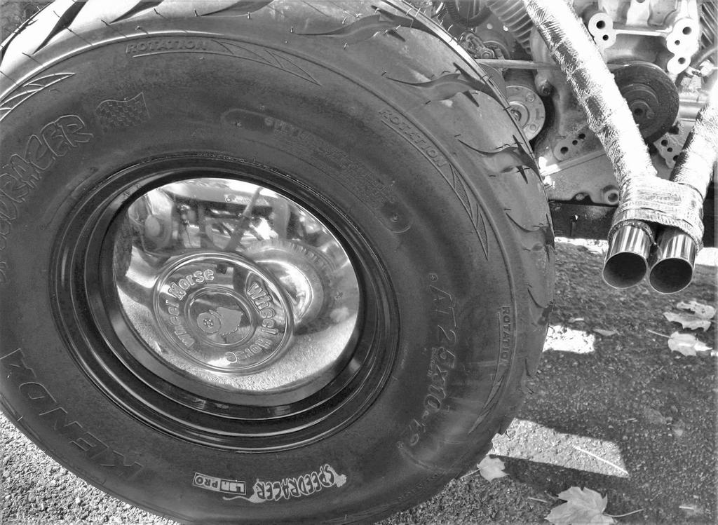

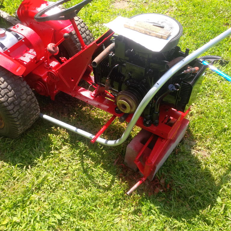

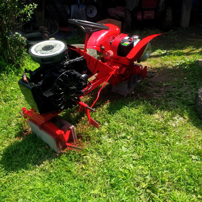

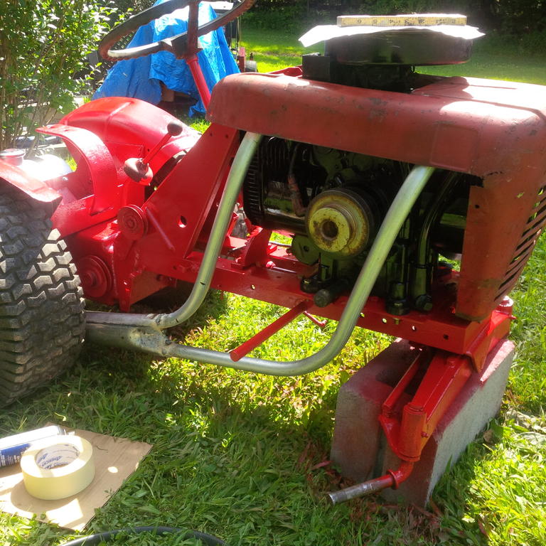

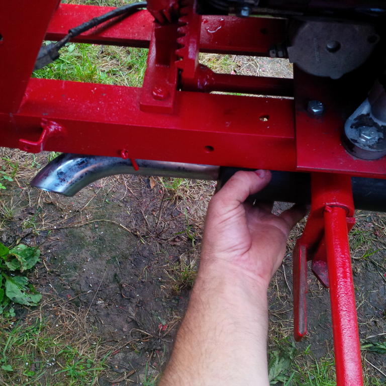

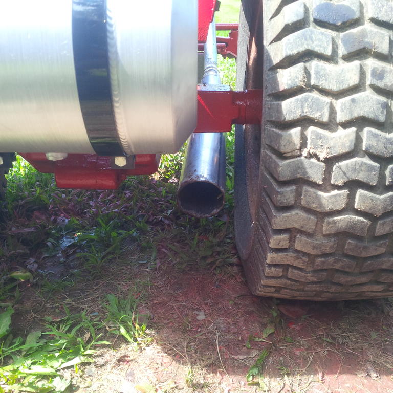

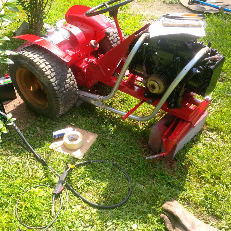

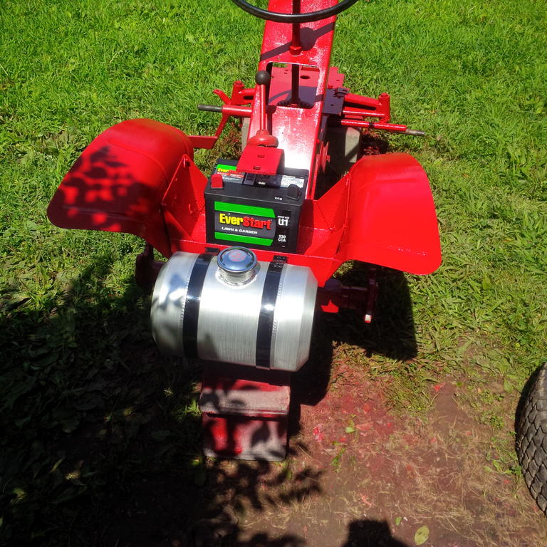

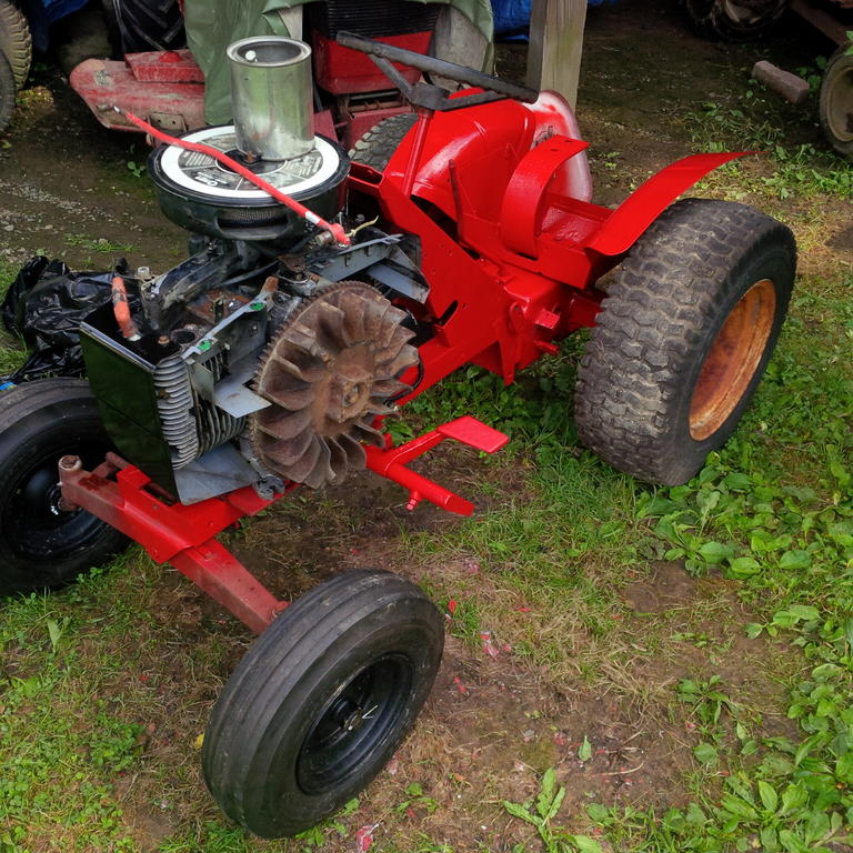

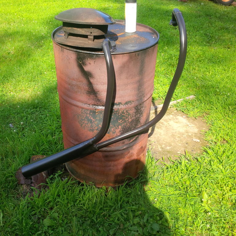

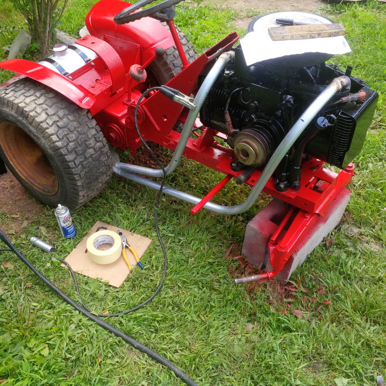

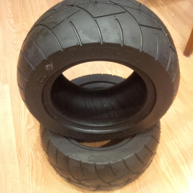

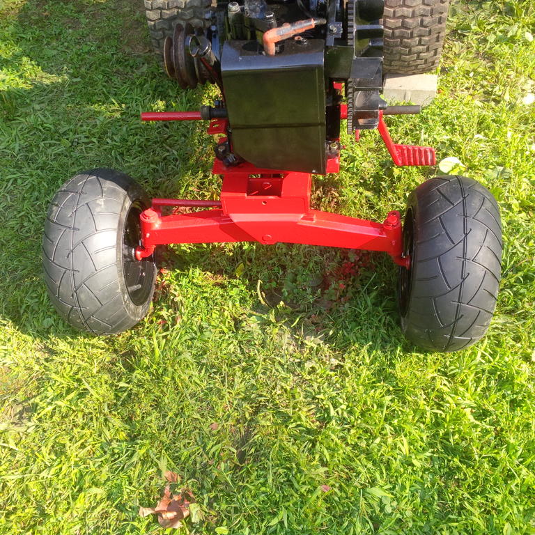

fast88pu 3,313 #36 Posted July 30, 2018 I got more done today. Front tires are mounted. I also got the fuel tank mounted. Made the exhaust and put the 4 speed back in. And it runs again and sounds healthy too. 7 4 2 Share this post Link to post Share on other sites
19richie66 16,942 #37 Posted July 30, 2018 😂😂 that looks sick.👍 1 Share this post Link to post Share on other sites
fast88pu 3,313 #38 Posted July 30, 2018 2 minutes ago, 19richie66 said: 😂😂 that looks sick.👍 Thank you richie Share this post Link to post Share on other sites
stevebo-(Moderator) 8,040 #39 Posted July 30, 2018 Love those fronts... 1 1 Share this post Link to post Share on other sites
Chris G 3,274 #40 Posted July 30, 2018 Looking pretty good I must say! 1 Share this post Link to post Share on other sites
PeacemakerJack 10,670 #41 Posted July 30, 2018 I want to hear that twin run through that custom exhaust—where’s the video link? Wicked cool custom for sure! 1 Share this post Link to post Share on other sites
Pullstart 59,687 #42 Posted July 30, 2018 That’ll haul more than hay for sure! Share this post Link to post Share on other sites
wallfish 15,919 #43 Posted July 30, 2018 Nice! Is this going for high speed too or just the appearance of it? Share this post Link to post Share on other sites

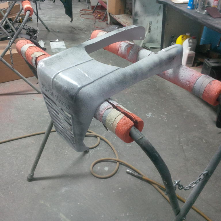

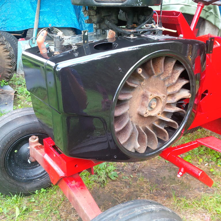

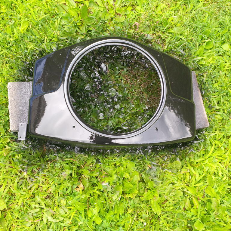

fast88pu 3,313 #44 Posted July 31, 2018 Hood primed for paint 2 1 Share this post Link to post Share on other sites
fast88pu 3,313 #45 Posted July 31, 2018 2 hours ago, wallfish said: Nice! Is this going for high speed too or just the appearance of it? Both. My goal is 40+mph with it. 2 1 Share this post Link to post Share on other sites
WHX?? 46,744 #46 Posted July 31, 2018 On 7/27/2018 at 8:07 PM, AMC RULES said: OMG Kyle... carve that hood with a hatchet? Signing on here to follow and bust Craig's stones for not letting the man work! Don't look too shabby now! @19richie66 behave your stones might be on the block too! 8 minutes ago, fast88pu said: Both. My goal is 40+mph with it. The need for speed ! 1 2 Share this post Link to post Share on other sites
wallfish 15,919 #47 Posted July 31, 2018 7 minutes ago, fast88pu said: Both. My goal is 40+mph with it. Sweet, just be safe if that's possible going that fast on a lawn mower. Control the things you can. Few things from experience. First thing!!!!!!-- Change out those Wheel Horse tie rods to aircraft style! Don't trust those WH ends even if they're NOS You'll also have to go with some toe-in on the alignment. Best if you research and can do something with the caster too. Toe in was enough for mine but... (Original setup will "Shopping Cart" the front wheels and possibly cause failure of the original tie rods and or control of it) OUCH at 40 mph+ Clean clean clean the brake lining and drum or add a new lining. I also ground the drum for more friction. The wheels would turn different directions when the brake was locked up. Regular motor oil in the trans instead of gear oil. At those speeds you don't need or want the drag of gear oil slowing you down or it's need to ride the gears for lubrication. The thinner motor oil will splash lube everything. To get that fast you'll probably need a jackshaft with appropriate pulleys. Or use a HUGE engine pulley. Can't really remember since those pulleys and belts were changed so many times but think it went 5.5 engine to 2.5 on jackshaft. Then 5 on the jackshaft to a 2 on the trans. Add some idler pulleys for tension around the small trans pulley, that's where the belt will want to slip more. Just not as much surface area on those small pulleys Stuff you may already know but just adding 4 Share this post Link to post Share on other sites
fast88pu 3,313 #48 Posted July 31, 2018 7 minutes ago, wallfish said: Sweet, just be safe if that's possible going that fast on a lawn mower. Control the things you can. Few things from experience. First thing!!!!!!-- Change out those Wheel Horse tie rods to aircraft style! Don't trust those WH ends even if they're NOS You'll also have to go with some toe-in on the alignment. Best if you research and can do something with the caster too. Toe in was enough for mine but... (Original setup will "Shopping Cart" the front wheels and possibly cause failure of the original tie rods and or control of it) OUCH at 40 mph+ Clean clean clean the brake lining and drum or add a new lining. I also ground the drum for more friction. The wheels would turn different directions when the brake was locked up. Regular motor oil in the trans instead of gear oil. At those speeds you don't need or want the drag of gear oil slowing you down or it's need to ride the gears for lubrication. The thinner motor oil will splash lube everything. To get that fast you'll probably need a jackshaft with appropriate pulleys. Or use a HUGE engine pulley. Can't really remember since those pulleys and belts were changed so many times but think it went 5.5 engine to 2.5 on jackshaft. Then 5 on the jackshaft to a 2 on the trans. Add some idler pulleys for tension around the small trans pulley, that's where the belt will want to slip more. Just not as much surface area on those small pulleys Stuff you may already know but just adding I'm using a gt14 Engine pulley which is bigger then a normal hydro pulley then using the stock 4 speed pulley. Idk what the real speed will be but that is the goal. I also have a brand new set of tierods from lowell for it. We will see 1 Share this post Link to post Share on other sites
ebinmaine 63,114 #50 Posted July 31, 2018 That a future hood sticker Kyle? Share this post Link to post Share on other sites
