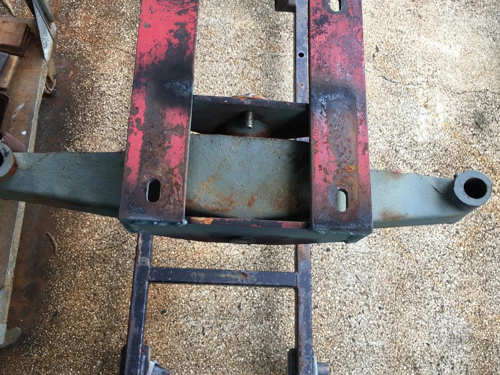

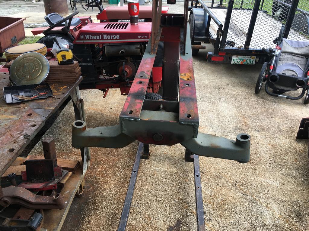

19richie66 16,942 #56 Posted August 7, 2018 (edited) @RandyLittrell here you go. Took care of that issue this evening. Still have to clean up the old welds but the axle will sit at the end of the frame, just as it does on the 1054. Ran out of daylight. Probably have to make a new drag link but thats ok. Edited August 7, 2018 by 19richie66 Pictures or it didn’t happen 😁 7 Share this post Link to post Share on other sites
RandyLittrell 3,827 #57 Posted August 7, 2018 Looking awesome! How are finding time to work on this with your honey do's as well?? Randy 2 Share this post Link to post Share on other sites

PeacemakerJack 10,670 #59 Posted August 7, 2018 This is gonna be one COOL machine when finished! I really like what I’m seeing so far Richie. Very good call on relocating the front axle, I know that it is extra work but worth it in the long run. 1 1 Share this post Link to post Share on other sites

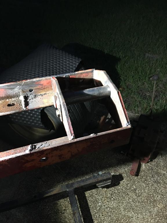

19richie66 16,942 #62 Posted August 13, 2018 (edited) In between chores, I managed to get the front axle pivot brackets welded in. Still have clean up to do. Baby steps. Edited August 13, 2018 by 19richie66 10 Share this post Link to post Share on other sites

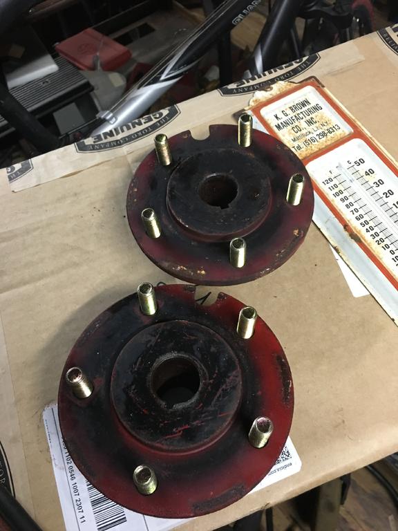

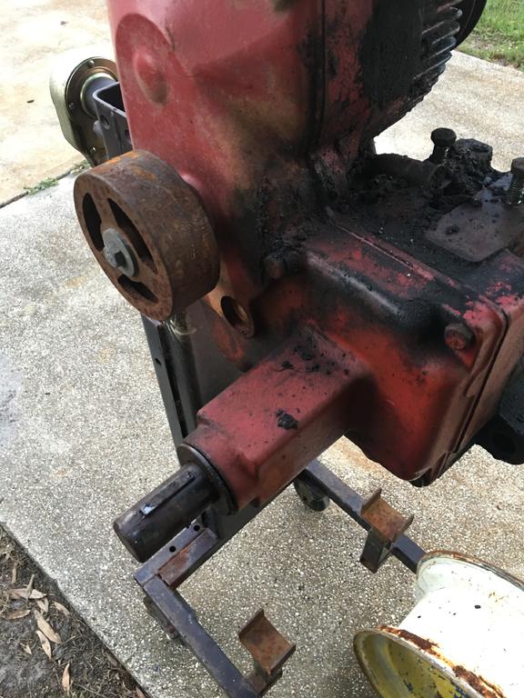

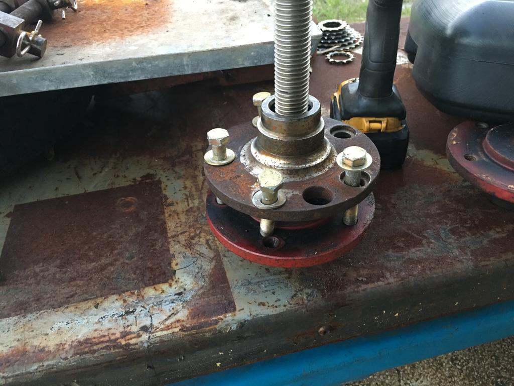

19richie66 16,942 #74 Posted October 15, 2018 Got the transmission on the stand for the “widening” of the axles. Been fighting the hubs. The first one practically jumped off but the second was having no part of it. Been soaking it and heating it now for almost 3 weeks and finally tonight after some heating sessions, she let go. Converted them already to lug studs and put them away. After I get it cleaned up, I’ll split it and get going on it. 8 Share this post Link to post Share on other sites
WHX?? 46,736 #75 Posted October 15, 2018 Yah know Ritchie I would rather have a fight with them hubs. Better chance of things being kosher underneath that way rather when they slide right off. Know what I mean? 2 2 Share this post Link to post Share on other sites
