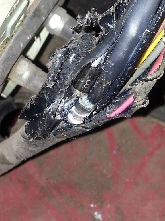

I have a 1988 257h and was blowing the 30 amp.
Turns out it wasn't charging as well. Blew out the diodes and scorched a number of wires in the harness.
Had to rebuild the harness in that area.
It's possible if your not charging either.
The clutch draws very little current to clamp "on". Before it fixed it I could cut grass for 5+ hrs with no charging.
