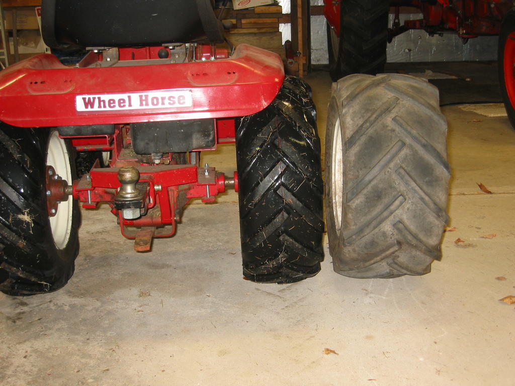

953 nut 51,536 #6 Posted June 15, 2018 2 hours ago, ebinmaine said: Carlisle tends to be pretty much right on size but Deestones are well known to run Very Small The Dico brand he has now run a bit small. My 310-8 has them and if you roll a Carlisle up next to it you see the difference. Share this post Link to post Share on other sites
pfrederi 17,129 #7 Posted June 15, 2018 Carlise vs Deestone ...same size 23-10.50 x 12 Incidentally I believe some 310-8 came with 22 -7.50 x12s from factory 1 Share this post Link to post Share on other sites
ebinmaine 62,974 #8 Posted June 15, 2018 2 minutes ago, pfrederi said: Carlise vs Deestone ...same size 23-10.50 x 12 Looks like those Deestones are measured using the "new math" 23 - 10.5 = potatoes Whaddya mean I failed? 1 Share this post Link to post Share on other sites
